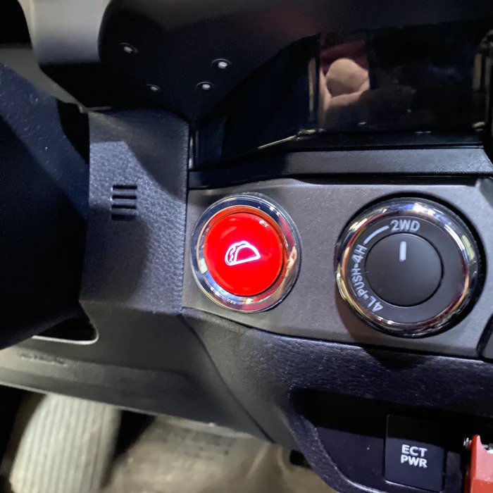

    i believe it doesnt the sound comes from the slits , see pic posted or can someone throw me a bone ? lol
  18. Jan 11, 2023 at 7:22 PM
    #18
    HondaGM
    HondaGM Call sign Monke
    Oct 28, 2009
    #25056
    13,324
    James
    South-Pole, Alabama
    2023 access cab V6
    Mmm…isn’t that the interior temperature sensor?
    Blak Shinobi[QUOTED] and erok81 like this.

    I was so tempted to do this a while back because that door chime is annoying. But worried about losing the signal beep and a few other warning beeps. Then I realized all of those noises are annoying. :rofl:
    Next time I have my cluster out I’m busting that little guy loose.
  20. Jan 11, 2023 at 7:30 PM
    #20
    erok81
    erok81 Well-Known Member
    Aug 15, 2016
    #194699
    5,708
    Imposter
    I always thought that was the phone mic but it’s actually the climate control temp sensor.
