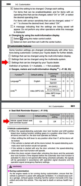

    No you are correct, I went and looked as well pg 516 to pg 519 to page 601. I incorrectly referenced my experience with vehicle makes that use a similar procedure that I mentioned

    Why not just have the dealer disable them. Its not illegal, its just an option only they have access to.

    Go to another dealer? You must be very polite, I'd make a scene if they didn't do it.
