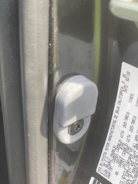

    Here's my first attempt (pics in a later post). I have a few minor visual refinements. BUT it's functional and fits in the space. It's works pretty awesome.
    Other design goals:
    1. Quick easy install
    2. Mount with the existing bolt,
    3. Maintain water seal from existing rubber boot
    4. Profile less than closed gap (ie, fit without touching/impacting the door paint)
    5. Removable
    I'd like to test and verify it's a solution for all 3rd gens. I have a 2020 but noticed you have a 2019, AxisCab has a 2018, jbiscuit has a 2021. If you three PM me your addresses. I'll print some extra for this second design. In return, I'd ask for a few pics of it installed and your feedback.

    Took me a minute to figure out how to post the pics.
    This was printed on a Form3 labs laser SLA printer with a pretty expensive resin. Vs the more common FDM printers. The sidewalls needed to be pretty thin and the FDM (cheaper filament) printers wouldn't be strong enough if printed to fit the space. It would look more bulky too.
    Let me know your thoughts. Happy to incorporate design feedback!

    That’s pretty cool! How much does the printer you used cost?

    Wouldn't this make your truck think you never opened the door and thus not turn off electronics and drain the battery?
    RoMav9394[OP] likes this.

    I was also thinking that after I posted my reply.
    The only thing I’ve missed, which CAN be turned on/off, is the lane assistance warning. The pedestrian alert and reverse alert still work without the speaker. It just kills the door, seatbelt, blinker, and lane assist.

    Its around $4k and the resin is about $150/liter.

    It hasn’t yet. But good points. I will verify if it times out or something.
