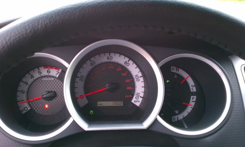

    Look at the picture in post # 185

    What's your build date? It should be on a sticker in the door jam. If it's before 12/2010 (I think) then you have the old gauges...and this mod will work.

    Yeah, they look like this.
