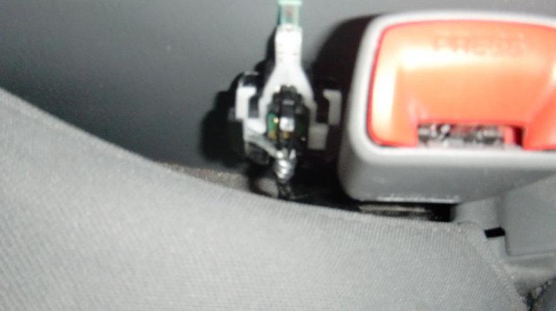

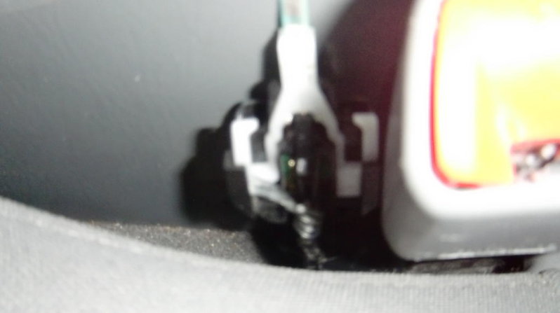

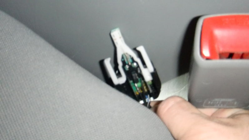

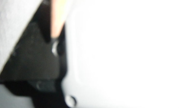

  15. May 17, 2012 at 12:08 AM
    #335
    Mytaco09
    Mytaco09 Active Member
    Dec 20, 2011
    #69059
    34
    Steve
    Edmonton, AB, Canada
    '09 TRD Sport Supercharged
    TRD Supercharger, billet grill, Toytec ULK on the front with AllPro Expos bringing up the rear, a work in progress
    I have no idea how to post pics on here nicely like some of you guys do but supposedly there should be pics attached to this post,lol. Here is my solutions after reading a few posts about using electrical tape or elastic bands. Neither of those methods will let you re-install the sensor but I was able to afterwards and it works awesome, won't have to be reset if you disconnect the battery ever and is totally reverseable in minutes.
    All this does is fool the sensor to thinking the seatbelt is buckled so no beeping and no light on the dash and most importantly in no way should it affect the airbag like some people are saying unplugging the sensor from under the seat may do.
    If my pictures actually attach here then one pic will show the small hole in the metal seatbelt strap that you need to push a screwdriver through to remove the sensor. Then there are 2 pics showing the white plastic "switch" that you are going to have to tie down in order to make this work. One pic is of it in the on and the other in the off postion.
    The other 2 pics show(not the best quality, sorry) how I wrapped a twist tie around one side and pulled it down and then wrapped the other end around the wire at the bottom. The twist tie is the grey/silvery colored thing at the bottom. Good thing is that it is not very bulky and i was able to re-install the whole thing so no one will ever know it was done.
    Hope this helps
