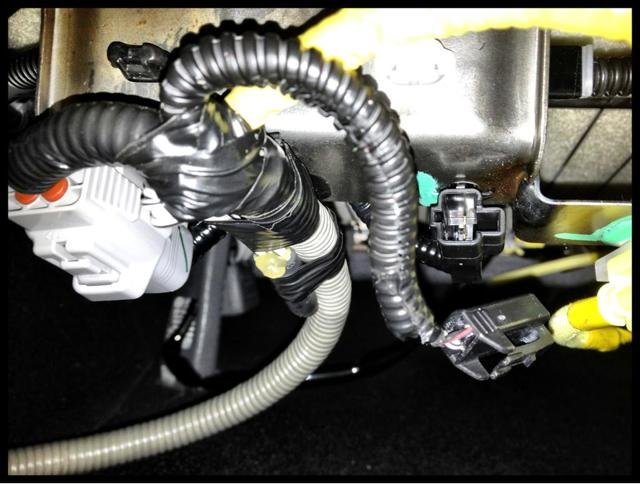

    I unplugged this plug under my 2012 RC bench seat and no seat belt chime or light on the dash. I would hope if something were wrong with the SRS I would have triggered that light also.
    Credit to the other guy who said he just looked at a wiring diagram and said hey these two wires tell the system the belt is buckled so I'll unplug it. Lol!
    Good job bro!

    Several have said the air bag system is connected to the seatbelt system, with disconnected wires potentially disabling those air bags. No warning is given since nobody in the seat (no seatbelt) is a normal condition (when parked, etc). The other methods of disabling the seatbelt chime (buckles, clips, dealer codes, etc) don't disable the air bags (the seatbelts appear buckled).

    I'll probably reconnect it, I like the idea but it's not worth the risk of non deployment of the bags!
