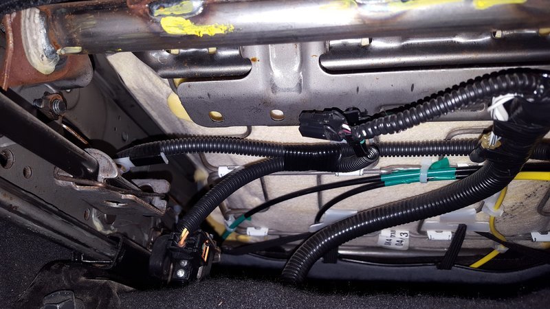

    I have a 13 DCSB and pulled the plug under the seat and no more beep, no codes or lights, my guess is its a normal closed switch so it reads clicked when unplugged.

    i've been looking and can't find the place where you found which plug you pulled...can you link to it?
  9. Aug 20, 2016 at 6:54 AM
    #529
    justdoit
    justdoit Well-Known Member
    Nov 28, 2015
    #170886
    687
    Colorado Springs
    22' 4x4 AC TRD Off-Road
    left side of seat looking backwards, 2 wire plug.

    The ignition on off hold the button thing didn't work on my 2011. (white face guage cluster) or at least I never could get it to work.. Tried ODO trip a and trip b. Holdin it in for 10, 20, 30. Pluggin seatbelt.. Nothing ever did anything.. sooooooooooo. I unplugged it under the seat, No More beep, No more light flashing on the dash.. As mentioned it seems to be a normally closed circuit, and plugging in the belt opens it. That's the only possible explanation.

    I unplugged mine too after dealer refused to do the disable. You cannot do the passenger side. If I carry something heavy in seat on that side I just fasten the belt. Same when I take son or daughter to hunting ranch.
