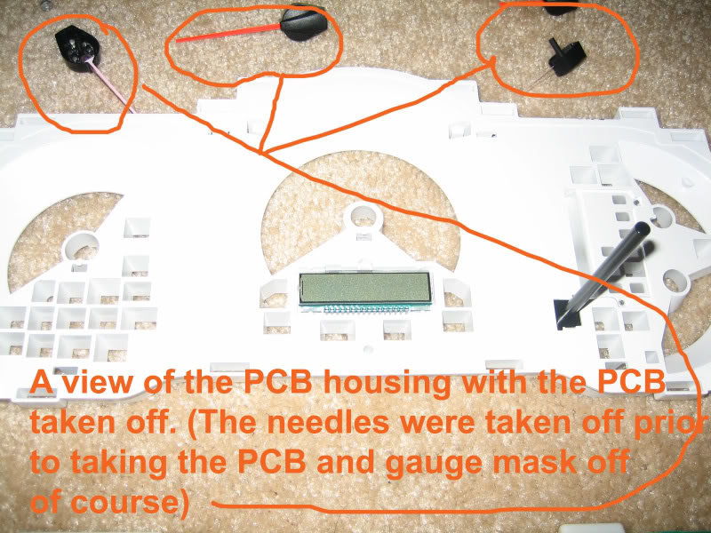

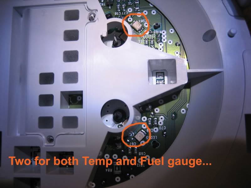

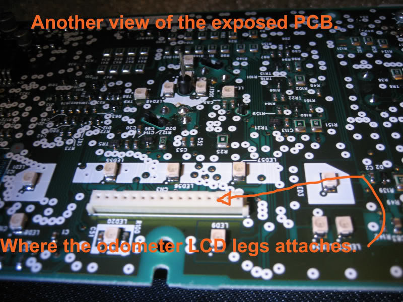

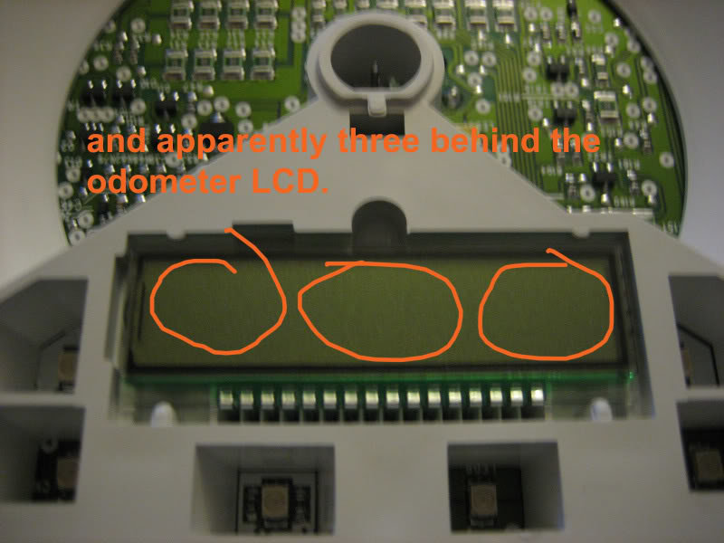

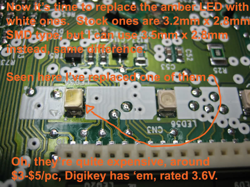

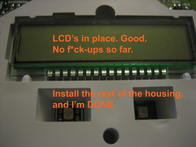

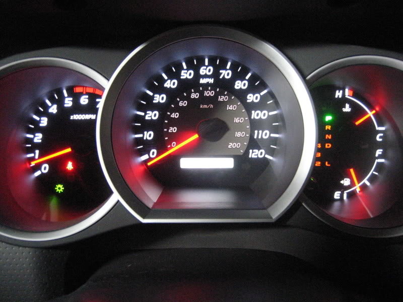

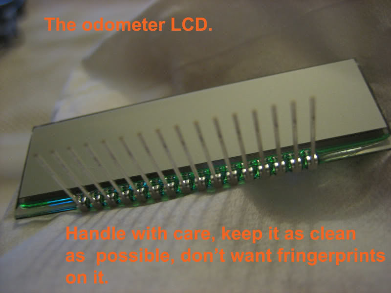

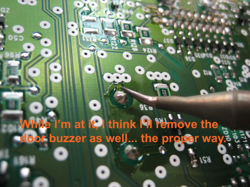

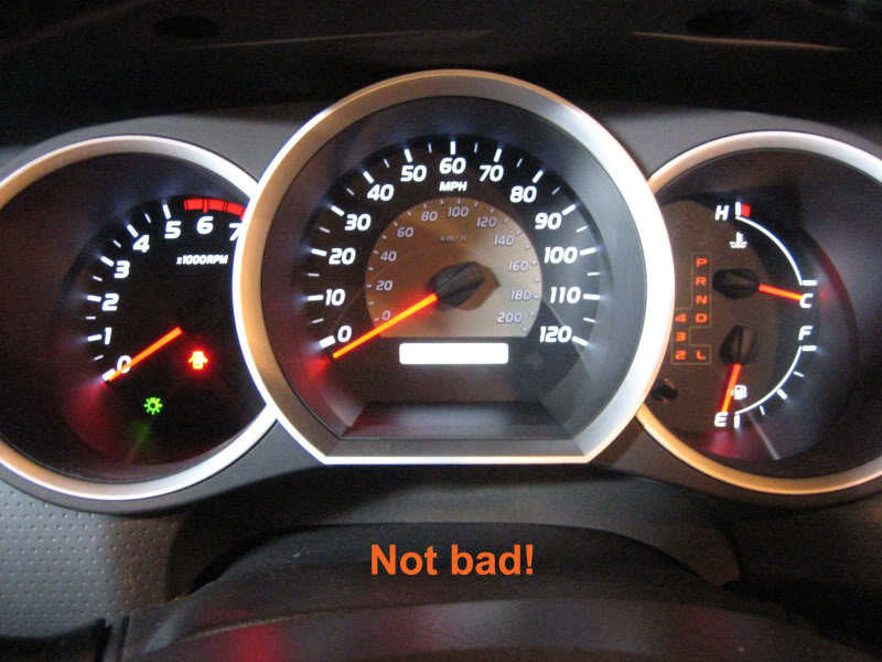

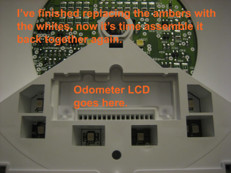

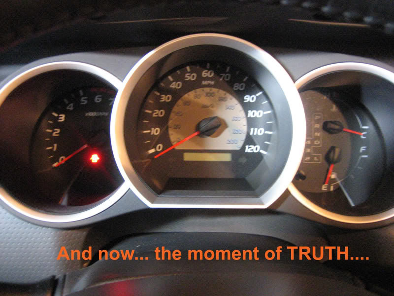

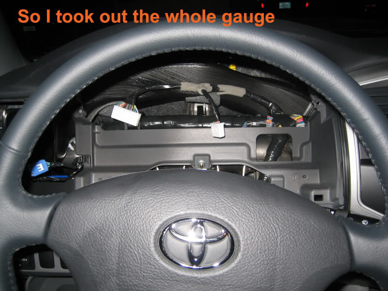

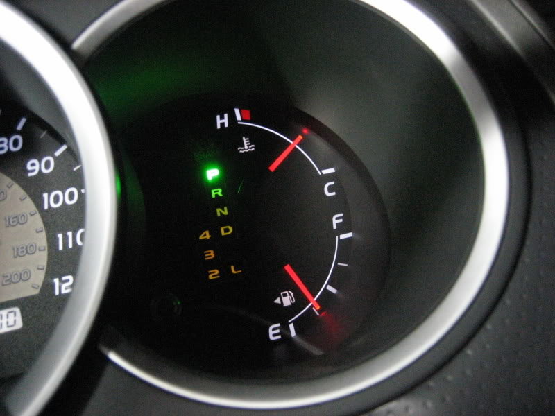

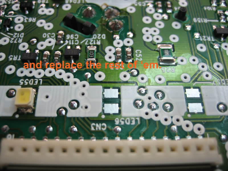

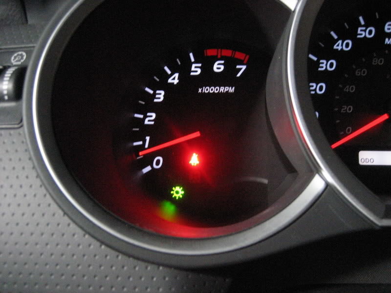

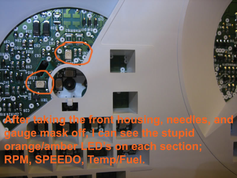

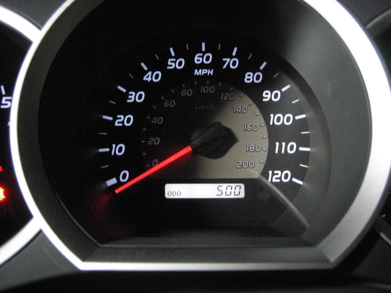

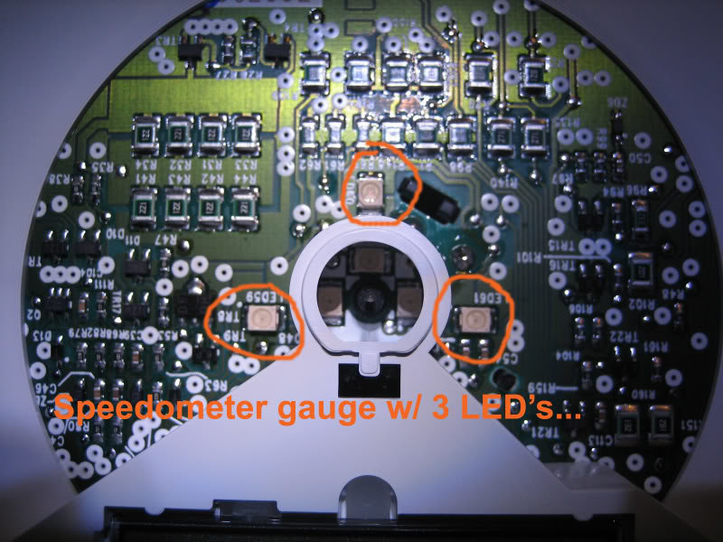

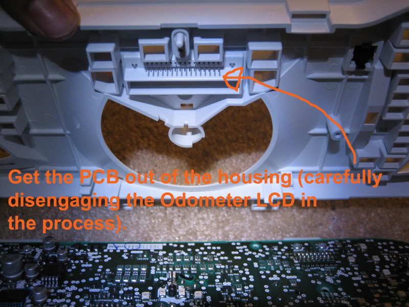

    I began my obsession to have a better viewing when I'm driving:
    You see how hard it is to read characters in f'in amber?
    There were 10 LED's total that I replaced. (should be 11 really).
    Now I can Ride In Peace

    The only way so far is to remove the noise maker from behind the instrument panel
