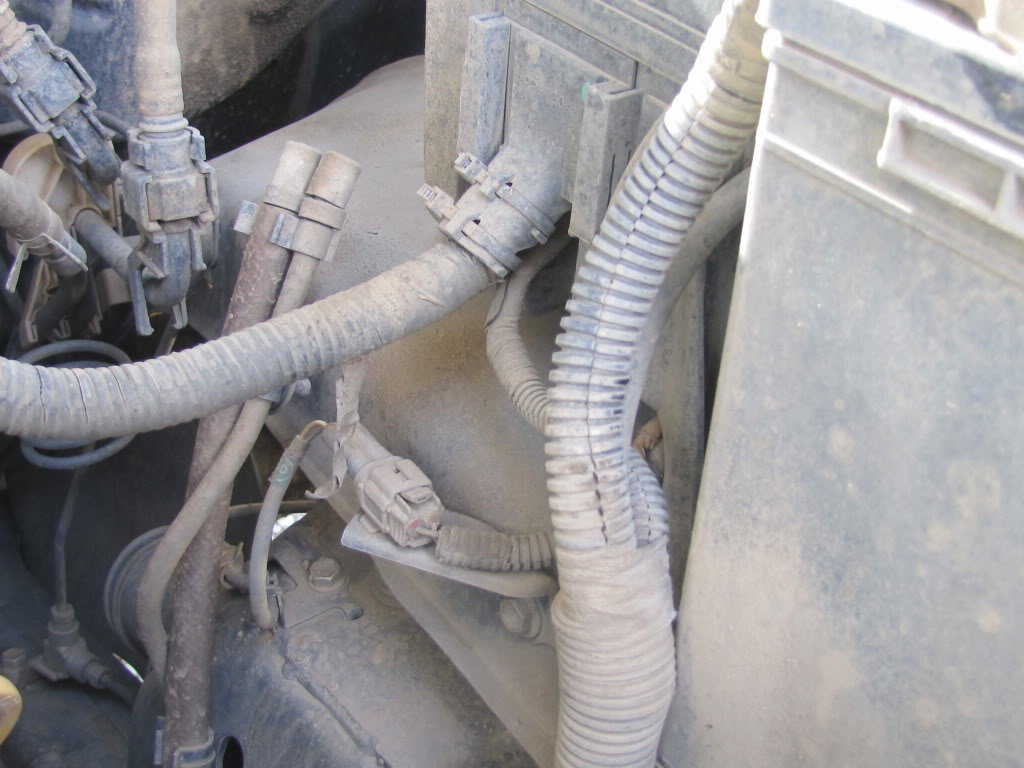

    You can disable the VCS by unplugging the wheel sensor. I unplug the sensor on the top of the frame rail on the passenger side since its out of the water/mud
    you could install a switch on the wire which would basically "plug in or unplug the sensor wire"

    when you have some time can you take a picture of the sensor?

    actually the driver side sensor is easiest to get to. You can experiment adding a switch with wiring into the cab as a disabling switch but im not sure how the added resistance of long wires will effect the pulse signal of the sensor... maybe ill try it today...

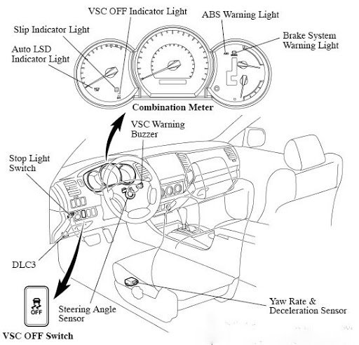

    OP,
    You could try unplugging the Yaw Rate sensor, which is under your seat. If that works for you, you could then install a switch to interrupt the ground wire for the sensor, so you can disable ABS/VSC whenever you want. This saves you the trouble of feeding wiring from the engine bay back into the cab.
    The Off-road trucks are cake to do this mod using the locker trick
    Wiring diagram is attached to this post. The one for your truck is ABS-VAC. For the off-road guys, they would need the ABS-Hyd.
    Here is a thread of a writeup on how to disable ABS, but he does not have VSC.
    ABS disable mod for 05+ Tacomas w/o VSC & locking diff write up *pics*
