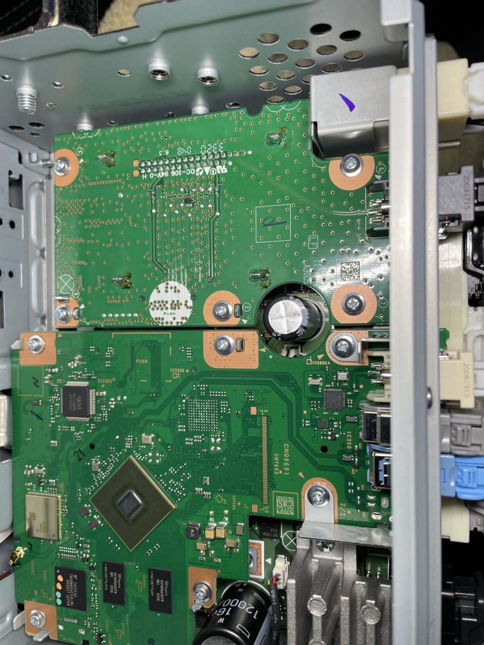

    Anybody know what they changed the HU and wiring to now?

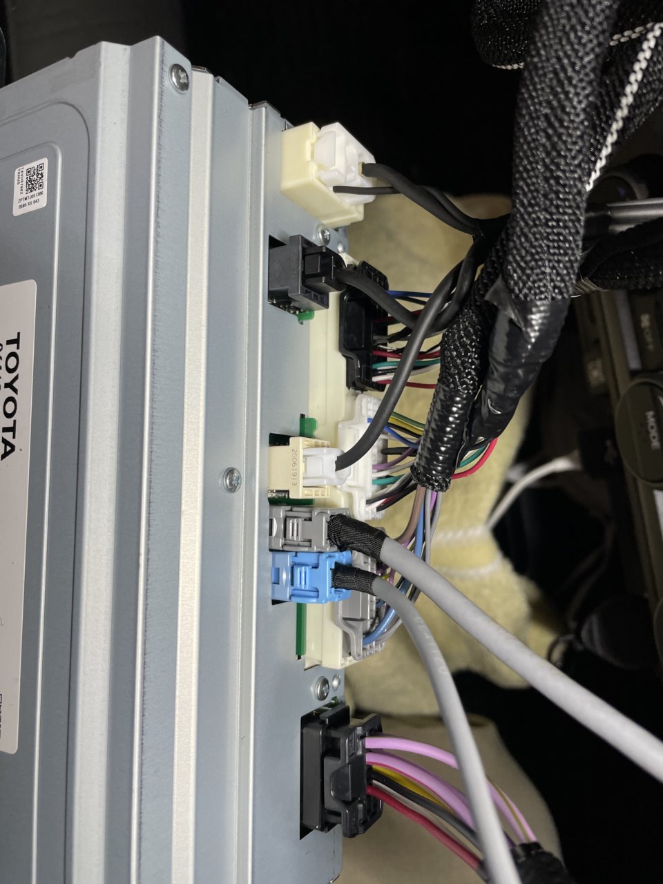

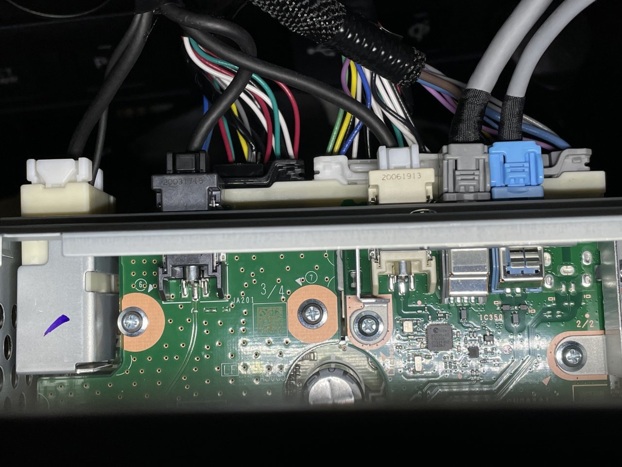

    I don’t remember the Sirius/XM antenna color, but if they integrated it into the radio, my guess is it’s the black connector. Which would make the simplistic board the equivalent. If so, remove the board. It essentially presses down onto main board contacts (see the pin arrays to the sides). Watch for ribbon cables. My bet is removal takes away Sirius/XM functionality as would be required in Canada/Hawaii.

    You’re right, the black coax connector is antenna for XM. Get a HU no signal notice if selecting XM now. Still trying to figure out if pulling other connectors can removed the XM options, or I will just try pulling the board.

    Yep, my thoughts are that Canada/Hawaii ship with no board and a plug or no punchout. I seriously doubt they designed a no XM radio when deleting is a simple as just not installing a component. Much easier before when it was a separate unit added like a CD Changer, but Modulars these days…

    Just did mine. You do have to remove that small board the coax is plugged into.
