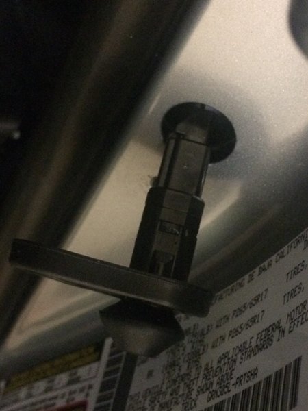

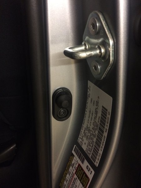

    If you really want to disable it you can disconnect the wiring on the door plunger. I've tried it and it works. The only caveat (and it was enough for me to reconnect it) is that your lights won't auto shut off. If that doesn't bother you and you remember to turn off your lights all the time then maybe that's your answer.

    First I tried the Amazon seat belt extenders and this worked for the seat belts only. Then I read the post by \000/ and tried the disable the plunger by disconnecting the wiring and it took about 10 minutes to complete it. I wrapped the wiring with duct tape and left a little tab of duct tape sticking out of the hole and then reinstalled the disconnected switch. Just have to remember to shut the lights off. It worked for me.

    I bet one of these put over the switch will hold it down temporarily. Just don’t forget it when you close your door, Maybe put flagging or other bright material to help you see it: These are great. I also used them at my old job to hold down fabric screens over my open windows when I wanted to get fresh air without the flies.
