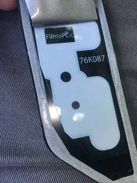

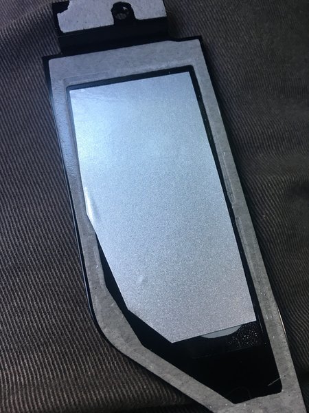

    This works better and is a lot cheaper.

    I stumbled onto them. It's dark on my way to work, and my way home a big chunk of the year, and that light is annoying. After I got them, I put them on a LOT of stuff in the house too. They come right off, and leave no residue behind.

    But leaves sticky residue behind.

    And looks like shit. going to get the custom sheet that you can cut yourself. See how it turns out

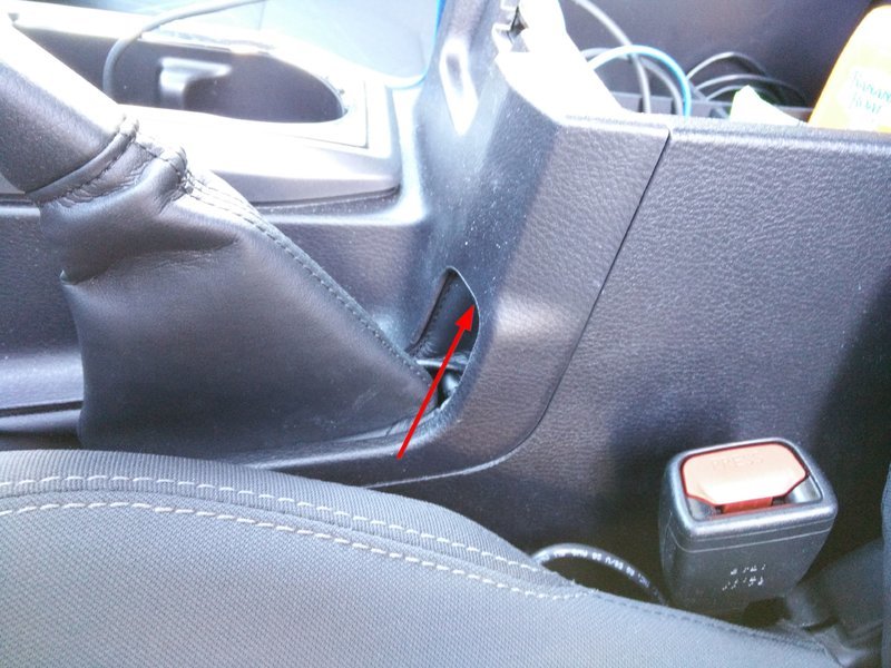

    If you take off the center console, there's a harness right under that light you can just unplug.

    +1 above, when i got my truck it was never lit. Had them check tranny etc. And they noticed it and just plugged her in. Its painless!

    That seems easier. Any ideas on getting that console apart. I can get the shifter knob off but no further?

    Here's some instruction I left in another thread, basically once you have the shifter knob off you just pull up on the plastic:
