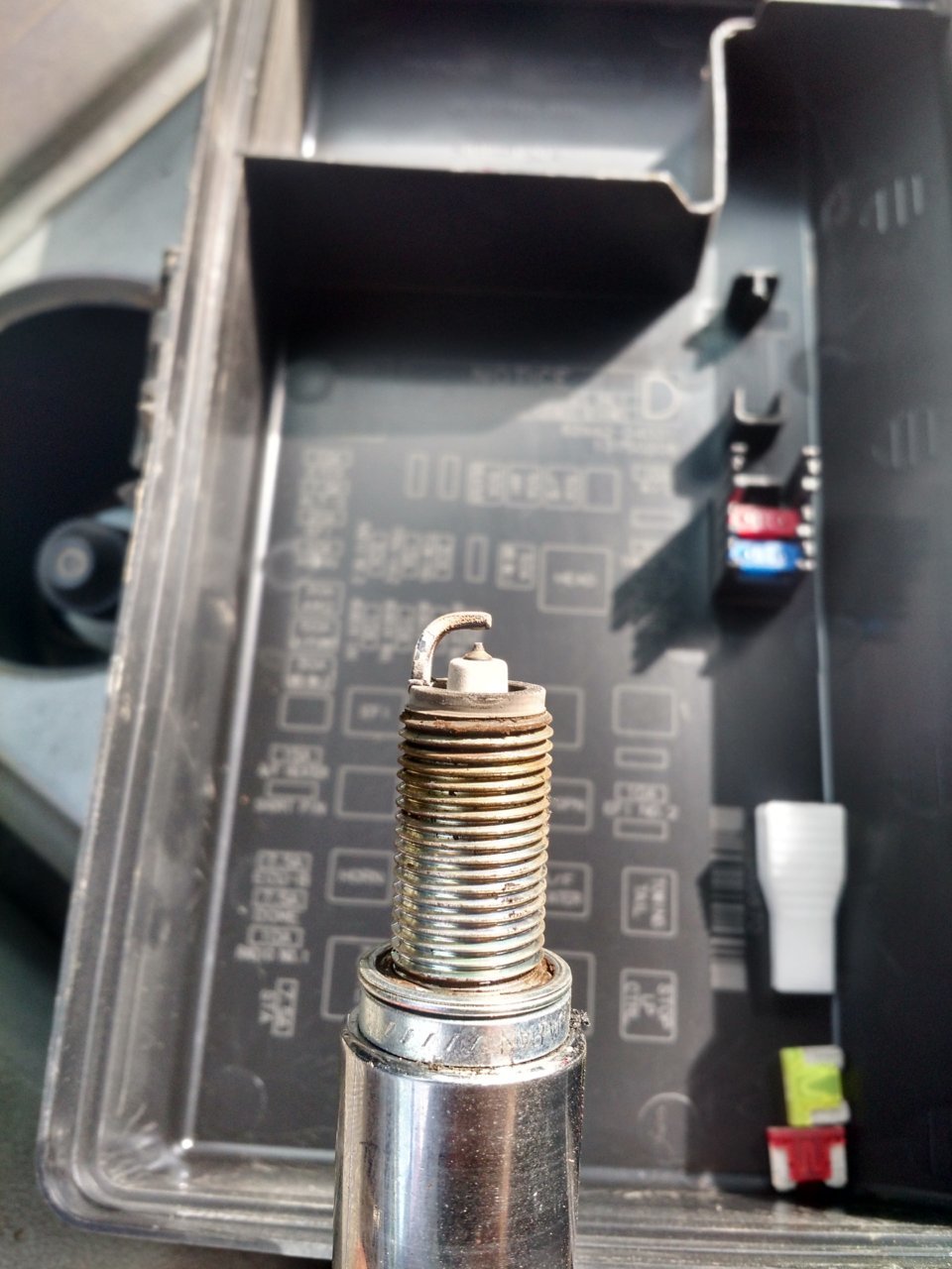

    I did a compression test today: dry / wet
    cyl 4 140 / 140
    3 125 / 125
    2 130 / 130
    1 122 / 145
    I started with cyl 4 and it seems I didn't put enough oil until my 4th try on cyl 1. Other than 4 being higher than the rest they don't seem too bad. I took a pic of 1 spark plug because they all looked the same, decent condition, no oil. I also changed the oil ( it was close enough anyway) and used 5-20 high mileage. Next gas fill up I will add techron fuel additive. I will see how this goes for a few thousand miles before I comment again unless someone sees a problem with these results. I did a thorough cleaning and didn't see anything out of the ordinary. Manual says 1 qt loss every 1k. Maybe it was simply from changing from 5-20 to 0-20 synth?
    Thanks again!

    Seems kinda low to me. Maybe all the rings are getting worn out
