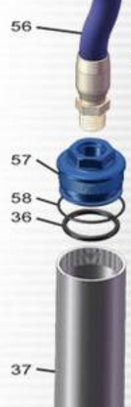

  13. Dec 9, 2018 at 1:08 PM
    gilligoon
    gilligoon Well-Known Member
    Aug 22, 2017
    #227638
    852
    Goon
    Watoosa Ridge, GA
    2017 Quicksand TRD OR DCSB
    Bilstein, ICON, Mobtown, Southern Style, Warn, SOS, Nitto, ARE, Northstar
    Resi looks threaded in the diagram; wall thickness is apparently > the bypass tube, so you may be correct:
  14. Dec 9, 2018 at 8:17 PM
    TMFF
    TMFF Well-Known Member
    Dec 7, 2011
    #68368
    2,576
    Tim
    Thornton, CO
    01/02 DCLB
    Stuff and junk and things...
    You have a standard prerun resi, depressurize and after you get the IFP and oil out tap the end cap in or resi toward the hose to expose the C clip to remove it. The hose looks like NPT and those rarely fail if installed correctly.
    The exploded picture posted is a race series resi that the end caps thread into the resi and NOT applicable with what you have.

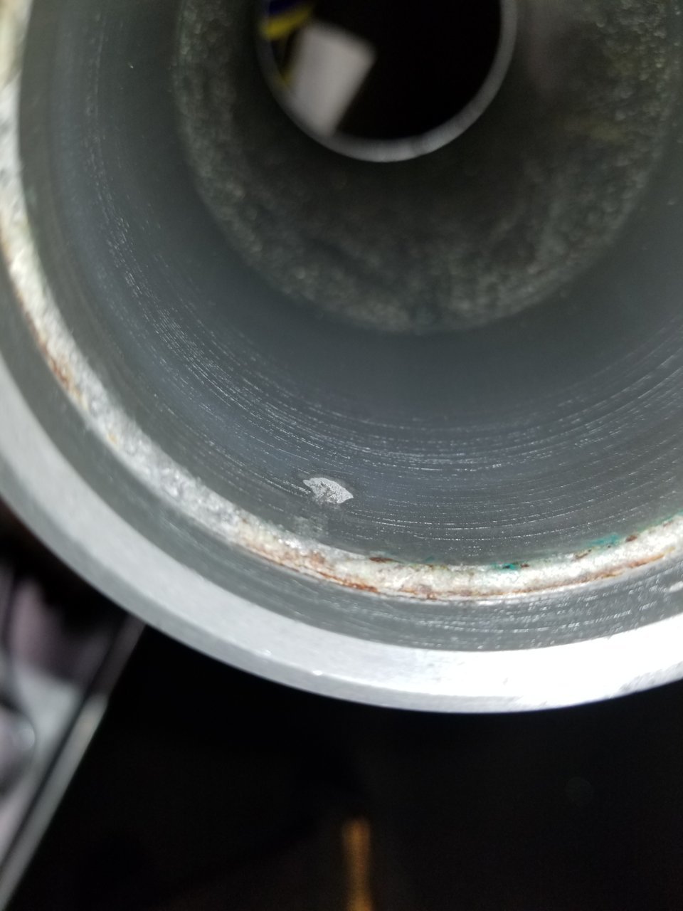

  16. Dec 13, 2018 at 6:48 PM
    #16
    Labbi85
    Labbi85 [OP] Well-Known Member
    Feb 25, 2018
    #245606
    217
    Thanks guys for the help.
    I was finally able to take of the cap. Like the most of you already said it was the "push down" cap. Had to use the BFH method to get it finally loos.
    In the picture below you can see why the reservoir was leaking, but I honestly don't know how the dent got there.
    Anyway I ended up flipping the sides of the reservoir because leaking nitrogen is easier to handle than leaking oil.
  17. Dec 13, 2018 at 6:54 PM
    #17
    desertjunkie760
    desertjunkie760 @DesertJunkie760 (IG)
    Apr 11, 2016
    #183963
    9,138
    Shane
    2011 MGM DCSB TRD Sport 4x4
    Check My Sig.
    You need to hone it out but that can be difficult depending on how deep. Other option is to replace the resi.
    Any other thoughts?
  18. Dec 13, 2018 at 6:58 PM
    #18
    Labbi85
    Feb 25, 2018
    #245606
    217
    Yes, I already worked on it with scotch bride and polish. You can feel the dent slightly but I hope the new seal will help it.

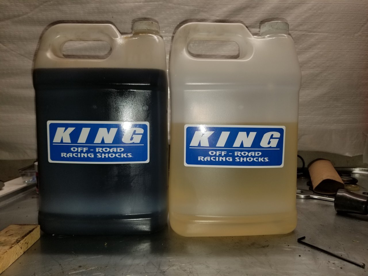

  19. Dec 14, 2018 at 2:07 PM
    #19
    Labbi85
    Feb 25, 2018
    #245606
    217
    I just leave the picture here to show the difference between old and fresh suspension oil. Unfortunately I cant say how many miles were already driven with it, because I bought the truck this year and don't exactly know when the previous owner installed the shocks
