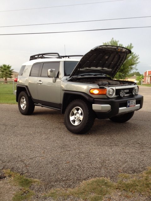

    My wife's FJ cruiser's UCA nut came off of the bolt, and it almost came completely out. Just had the Light Racing UCA's put on a few weeks ago and now this....
    Does anyone know what size nut is on the UCA bolt? The stealerships are all closed tomorrow, so I was going to try and find one at the local hardware store.
    We were very lucky this happened backing out of a driveway and not on the highway.
    (not sure why this pic is sideways, it shows up normal on photobucket)

    Take the nut off the other side and go to Ace/Lowes/HD and find the correct one and buy several.

    Any good shop that installs aftermarket suspension parts will tell you to check the torque on all the bolts and nuts after 100-200 miles of driving. to prevent things like this from happening. OP I dont have the size for you but put a ruler across it snap a pic and take it to the hardware store.

    There isnt a pin on the upper control arm nut, but i think we will be the first to install one now.
    My wife is scared to drive it, so i think im going to look for a castle nut and have the bolt drilled so i can pin it.

    It's a 14mm 1.5 nut. I don't suggest drilling a hole in the bolt. Instead either use a nylon insert lock nut, if you can find one in that size. Maybe fastenal. Or use loctite, red is good, and that nut will not move. Good luck.

    Sweet, thanks for the info and suggestions. Ill hit up fastenal and see what they have.

    i'd def agree with loctite or a nylon lock nut...wouldnt drill into it, you would prob just damage the bolt beyond use
