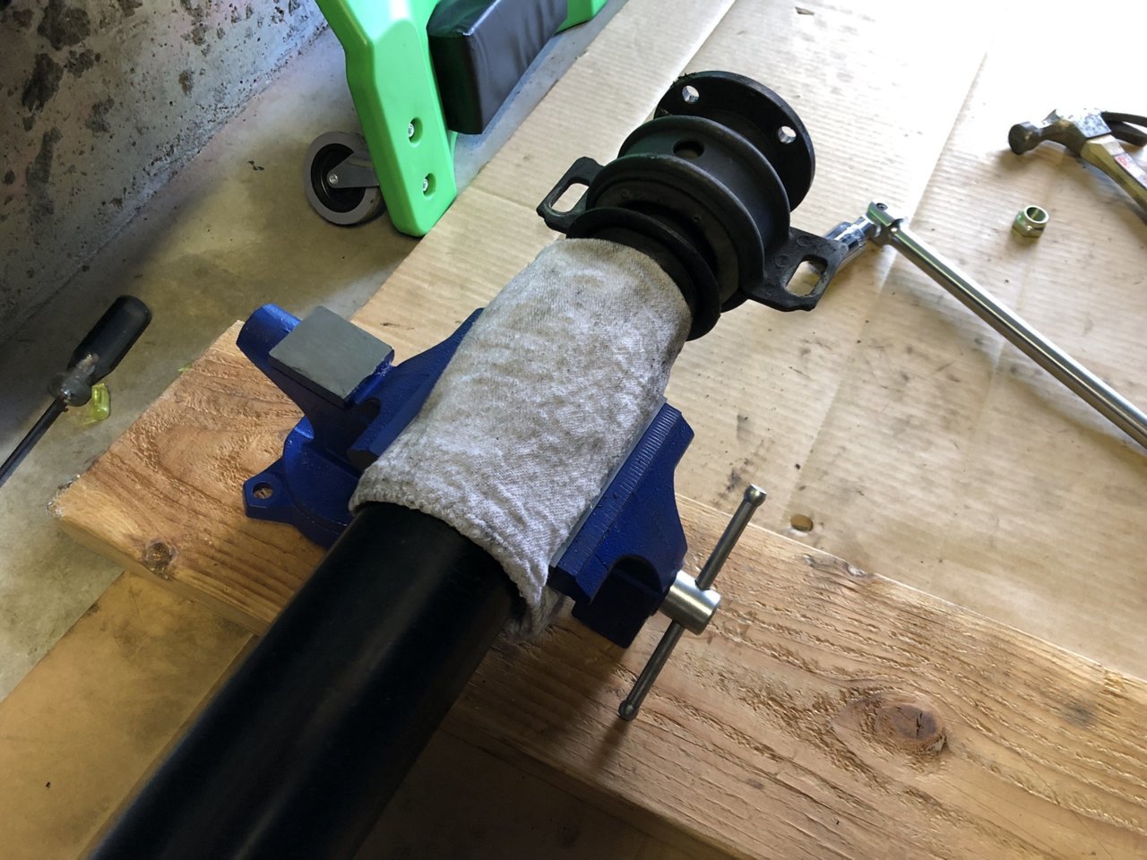

    I'm trying to get the nut off to replace the carrier bearing.

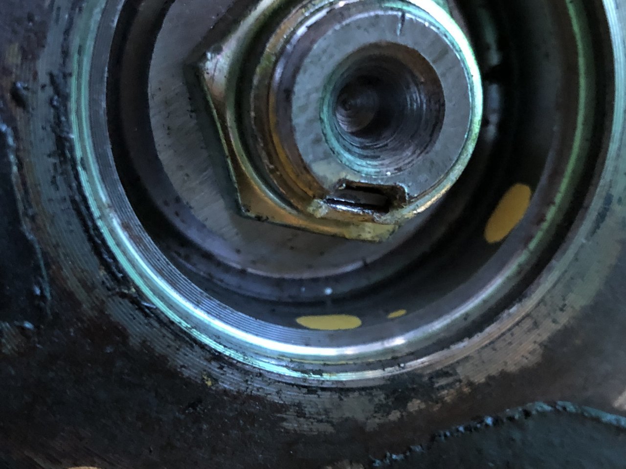

    First, I shattered the first screwdriver handle hammering on it, bent up the second screwdriver's weak steel when trying to pry the stake out, and then broke the tip off the third brittle screwdriver inside of the stake. See pic. It's stuck in there and I'm out of screwdrivers that fit. I don't think I pulled out the stake enough, so I don't know what to do other than buy more screwdrivers and try to hammer them in there if possible to create more space, hope the new screwdrivers have better steel, and hope the other piece falls out instead of preventing the nut from coming off.
    Second, I can't get enough leverage to turn the nut with the breaker bar. I bought a vise, but I don't have the vise screwed down onto the 2x6 board because I don't have any such screws, and without doing that I have no leverage. I don't have a work bench to install it on. I think I need lag screws?
    Third, I tightened the vise hard, but the shaft was still slipping and scratching off the paint badly over the whole area. It looks like it's been through hell. I put a towel around it to stop the scratching, but it's still slipping. I'm afraid I'll warp the drive shaft if I crank down any more. How do I know how tight I can go? Should I use the towel or not? A rubber sheet might be good, but I don't have any such thing.
    There are so many things working against me now that I'm about to give up, put it back on as it is, and pay a shop to do it. This is getting to be way harder than I expected. It took me all day to get the drive shaft disconnected from the truck.
    Is the barely staked or unstaked nut going to hold for a week until I can get an appointment with the shop?

    impact is what you need.

    well, that sucks.. usually they just come right off with an impact. Maybe take the shaft to a local auto repair and pay the 20 bucks or so to have them take the nut off. shouldnt need to make an appt for that.

    I always use an impact gun to get those nuts off.
    I don’t bother trying to unstake them I just use the impact it’ll unstake itself.

    You don’t need to unstake it. But you would be better served with an impact.

    Same here....if you were near me I could get it off in 2 seconds......
    anybody you can borrow an impact from....

    If you don't have someone close with an impact and you don't want to/can't take it to a shop, go to Home Depot and buy a Ridgid impact/battery/charger. That way you have a battery powered impact with lifetime warranty (have to register all 3 pieces).

    And anything that gives too much grief.......the torch has never failed me......

    you need a pipe vise and an impact. done in 2 seconds, there's a reason folks charge the price to do this kind of work, because the tooling isn't cheap to DIY. But if you want it done right and you want to DIY buy the right tools and it'll make your life 1000x easier.

    What are you guys talking about. I screwed my threads up royally, and roached the nut by not fully unstaking the nut.
    Had to chase the threads and get a new $4 nut from Toyota.

    Bolt it back on your truck. Then try and break that nut loose.
