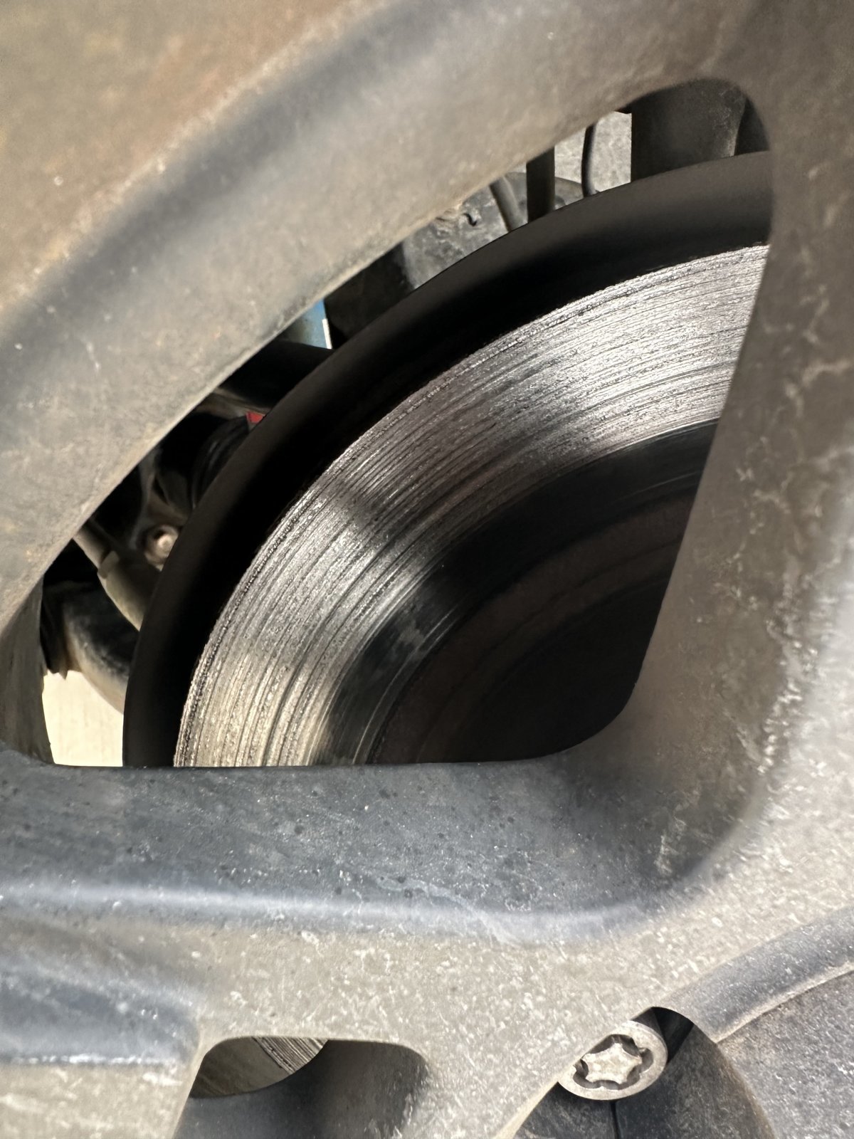

    I have a 2019 Tacoma TRD Sport with 55k miles. I went on a trip and noticed my brakes making a grinding sound when I was applying the brakes but only when I was close to coming to a complete stop. I looked at the brakes and saw that my front driver disc was roughed up. Looks like the caliper might be stuck? Is that covered under warranty? I was going to replace pads, caliper, and disc but wondering if I’m doing this right and if Toyota should cover some of that. Thanks in advance!

    No, I doubt it will be covered by warranty
    Get both sides replaced asap

    With a 2019, probably
    Mountain driving, maybe you just used up your brake pads?
    Only way to know for sure is take it apart and check slide pins, etc., and look for uneven pad wear

    you wore out your brakes.....in 4 or 5 years. No, not covered under warranty. Brakes are a wear item. At the least, you'll need pads and rotors. If the other 3 pads are close to being gone, I'd leave the caliper alone. If the other 3 have plenty of life left in them, I'd rebuild or replace the caliper.
