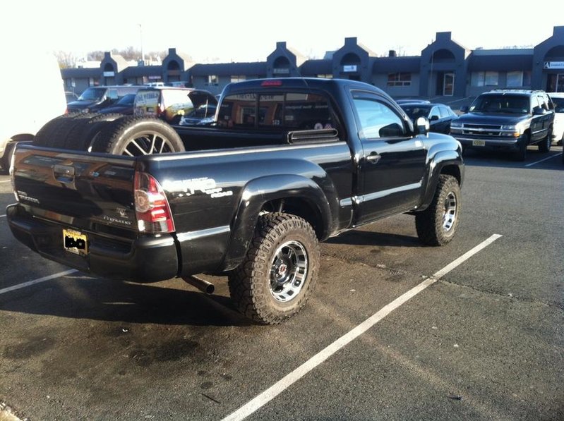

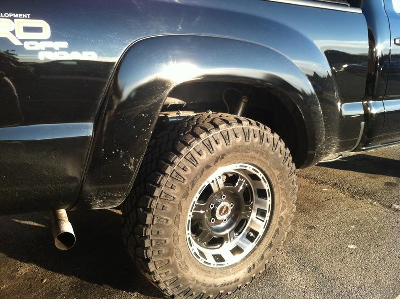

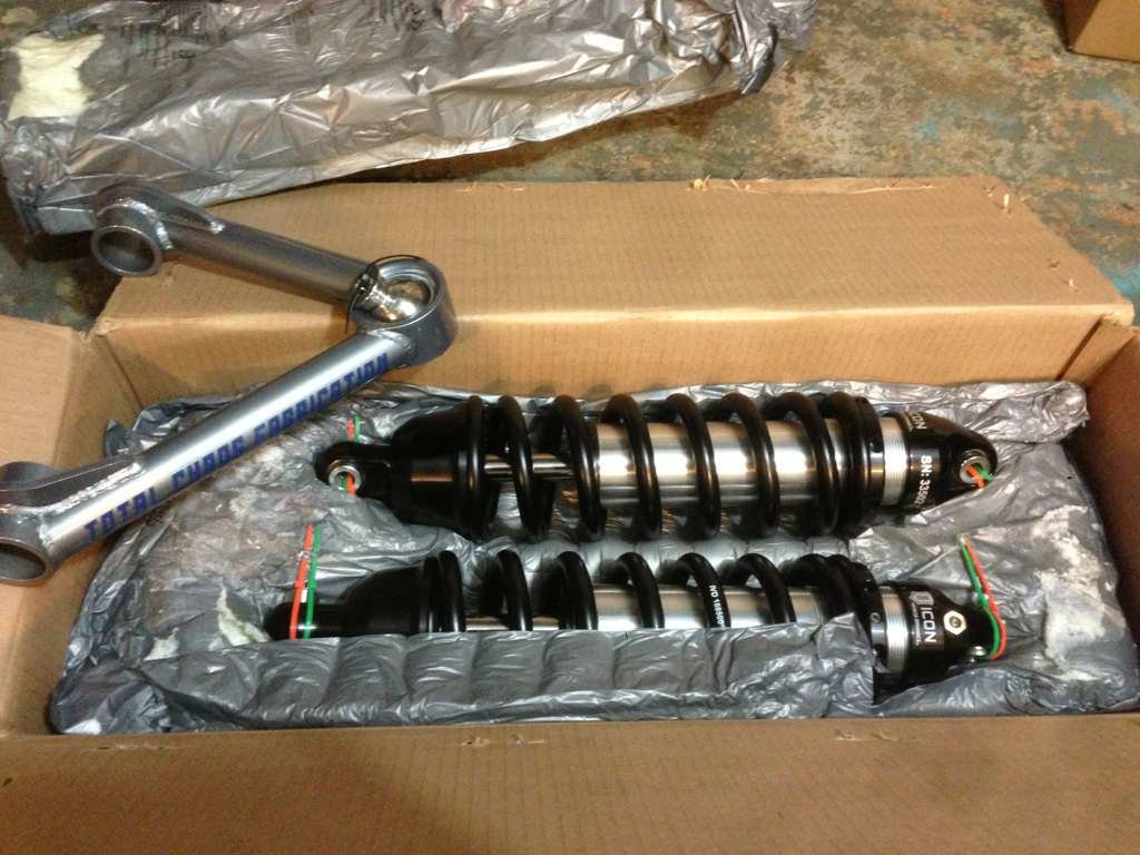

    Figured I start a build thread after a few were asking questions of a few things that were done to my Tacoma.
    2011 4cyl 5speed regular cab Tacoma
    Mods:
    • Flat black grill
    • Heated mirrors with oem switch
    • PIAA fog lamps
    • Procomp 16x8s
    • 265/75-16 Goodyear DuraTrac
    • Hurst Shift knob
    • Wet Okole Seat Cover with heat and lumbar
    • painted OEM fender flares

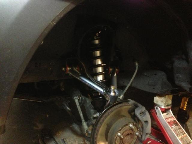

    Front:
    • Total Chaos Midtravel Kit
    • ICON front coilovers (preload as delivered)
    • Swaybar delete
    • Firestone Lifetime Alignment
    Rear:

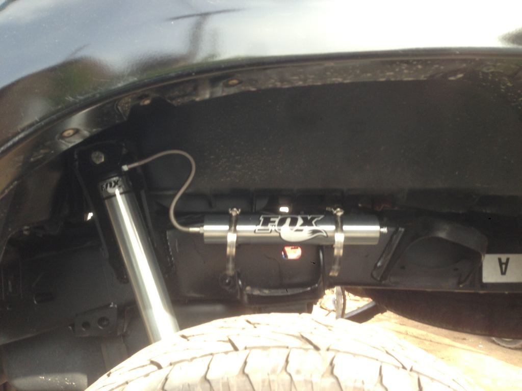

    • Alcan SUA custom 8 leaf pack (2.75 inch lift, no extra load, taco lean) update (removed overload and small leaf 6/15/13)
    • AllPro Extended Brake lines
    • BAMF Shock towers
    • Fox 2.0 short body 11" remote reservoir (30/80 with Flutter stack)
    • 4.10 gears with speedometer gear
    [​IMG][​IMG][​IMG]

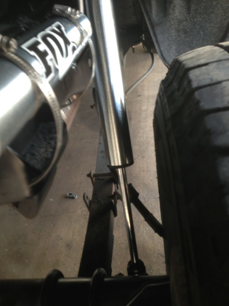

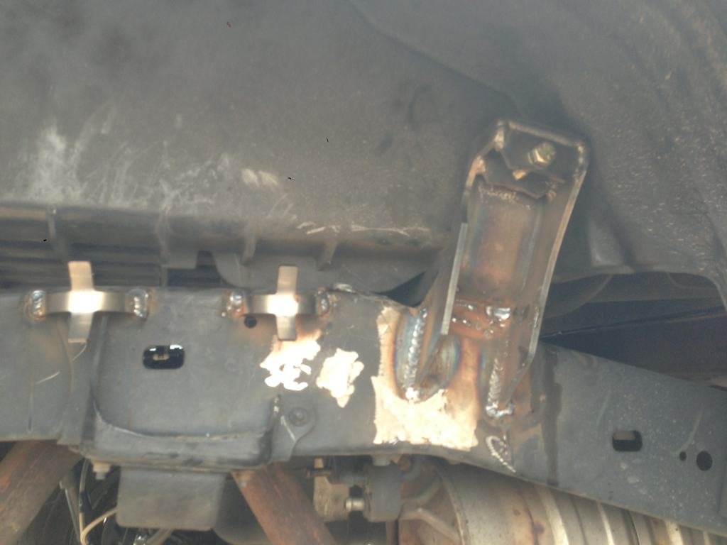

    measuring for rear shocks
    [​IMG][​IMG][​IMG]

    How did your install go?
  10. May 20, 2013 at 7:38 AM
    disc0monkey
    disc0monkey [OP] All right. I believe ya. But my Tommy Gun don't!
    Apr 23, 2011
    #55402
    1,460
    Yep gotta start documenting this stuff, there isn't much 5lug info out there.
    easy as pie. I didnt motor mounts in my f-body the weekend before, which is a miserable job. This was enjoyable with high reward. The ride is great!
    I pushed back the rear shock install until the 22nd. If it doesn't rain I will do it. Expect pics.

  15. May 22, 2013 at 4:10 PM
    disc0monkey
    Apr 23, 2011
    #55402
    1,460

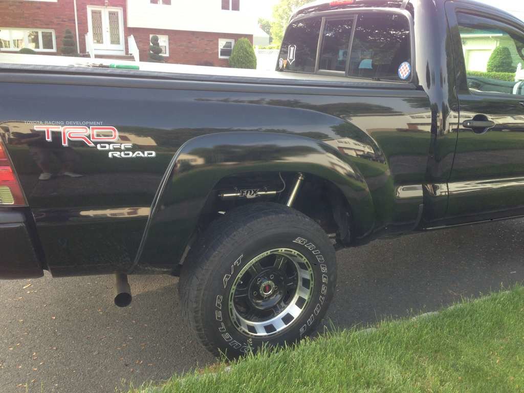

    Finally done
    photo.jpg[​IMG]
