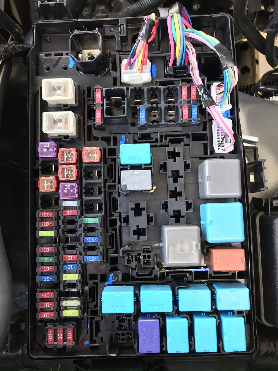

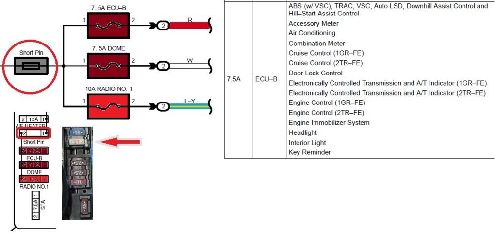

    Can you please go into a little more detail what a short pin is and does? Not familiar with this

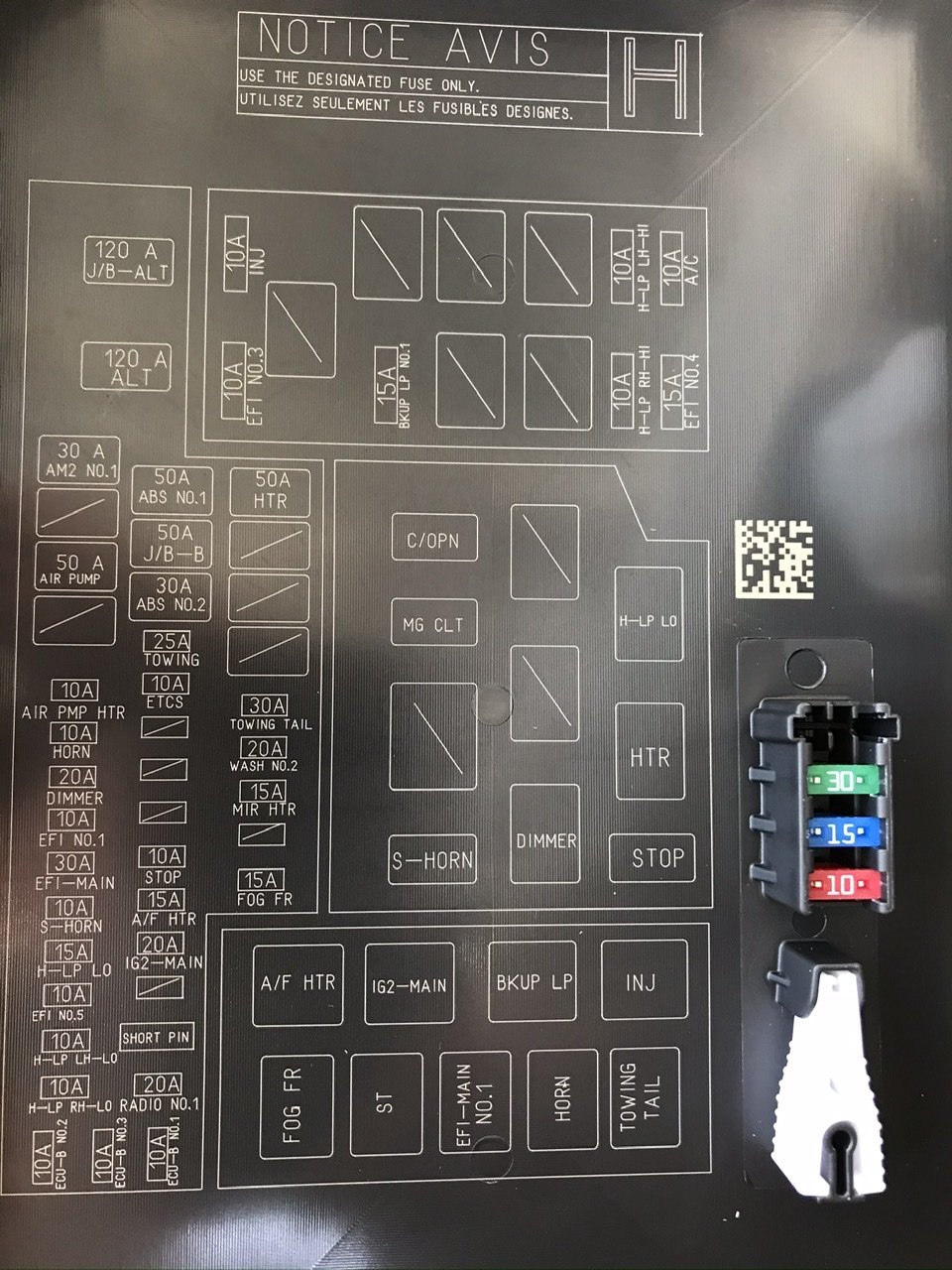

    It’s basically a jumper (thus an electrical “short”) styled like a fuse but with tabs on the sides. Removed for shipment to the dealers to avoid battery discharge due to parasitic draw (see attached pdf). The location may not be as shown in the picture below, the inside cover of your engine bay fuse box will show where it is. Also can store it with the spare fuses in the cover for 3rd gen, not sure about earlier gens. You don’t want to lose this, other threads indicate you can’t buy one without buying the fuse block!
    Short pin location on my 3rd gen is the off-white one near bottom left in pictures below:
