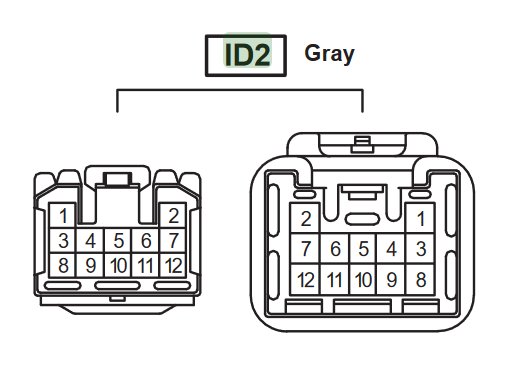

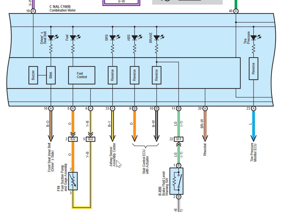

    Looks like the wires are Orange and yellow with a black stripe for the gauge.
    Connector is ID2 Pin Terminals 2 and 5.
    You don't have to go all the way to the Tank for the connector. The ID2 Connector is in the left (drivers side) kick panel.
