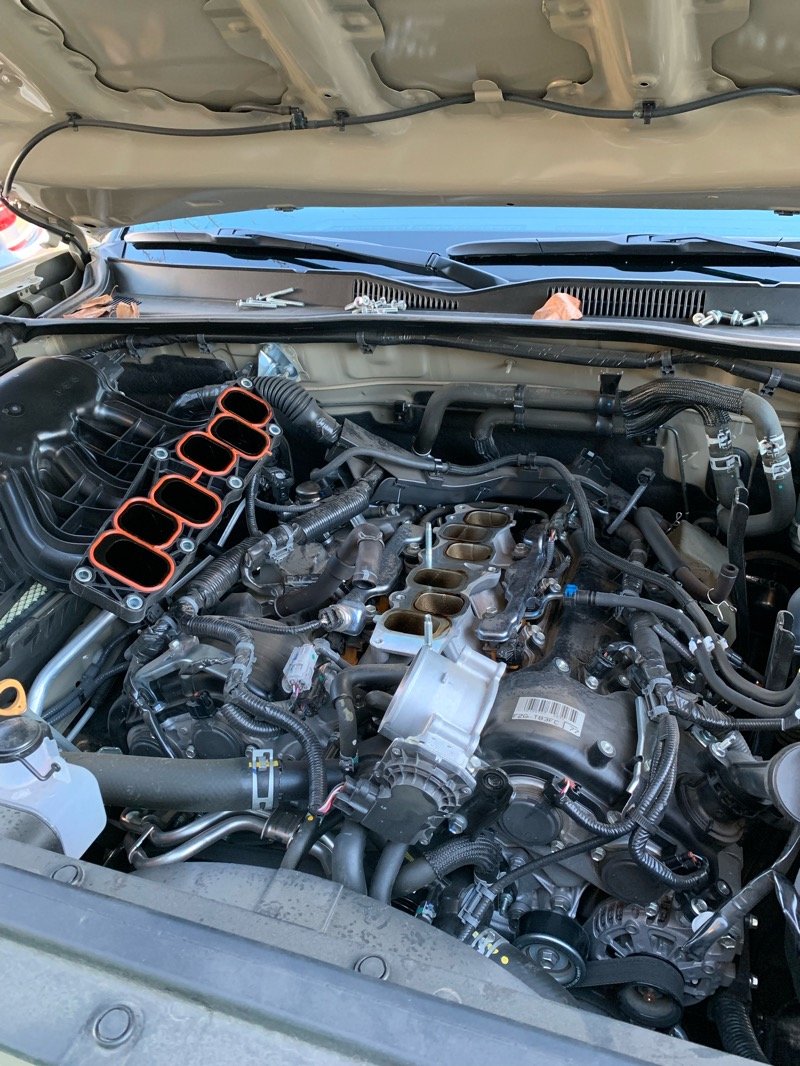

    First post here, been around cars and trucks for a long time. We seem to have a pack rat at the house, first getting at my BRZ, and now the Tacoma :mad:
    Started up this morning rough, long crank and a dead miss. CEL and Trac lights on immediately. Pulled the code, found p21D4, cyl 6 injector open circuit. Pulled the intake and sure enough, both wires to cyl 6 port injector are chewed right through.
    Now the real question, there’s a small harness on the 3 left bank port injectors. I would love to replace that harness, but I can’t get the connector up past the fuel rail. Do I have to pull the rail to get the connectors off? Seems silly, but I’ve seen worse done by those darn engineers.
    Any guidance?

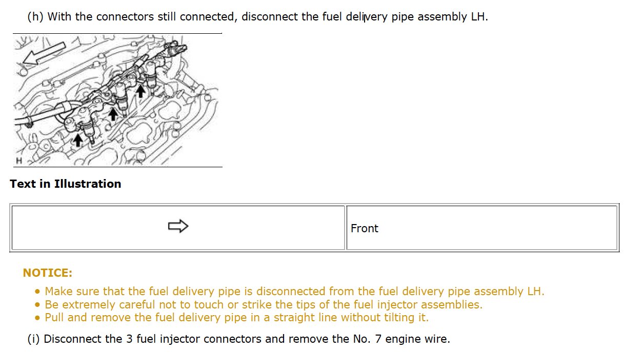

    Service manual has you pull the whole fuel pipe with the connectors still connected before disconnecting them.

    That’s high pressure, DI injectors. I’m on the port injectors, uphill a bit.
    I can release the connectors, but can’t slide them up enough to come out.

    Based on my limited experience in cars, that black thing on top of those square holes is for the air intake...I may be wrong but I guess is the air intake.
    If the only thing that gets in there is clean air,...why is oil residue on the intake ports? Could be from the PCV and blow-by gases and oil vapors???

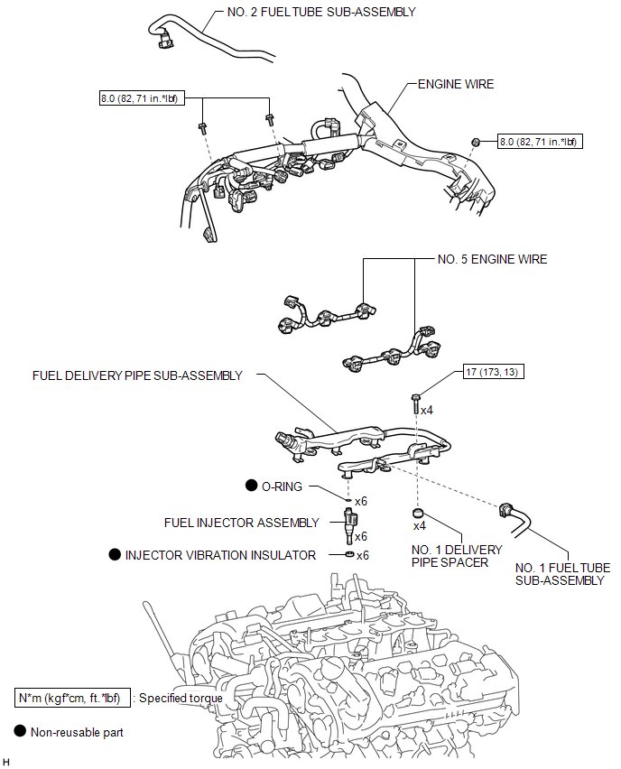

    There’s oil in the intake of every car now. You can dump the oil out of an m276 Mercedes intake. Just how it is these days, ventilation systems aren’t just a hose and a pcv valve anymore.
    The harness is NO. 5 Engine Wire, right in the middle. The rail is flat steel, it blocks the connector from coming completely off the injector.
    The service manual says to remove the rail, remove the injectors then unplug them. It’s so so close.
