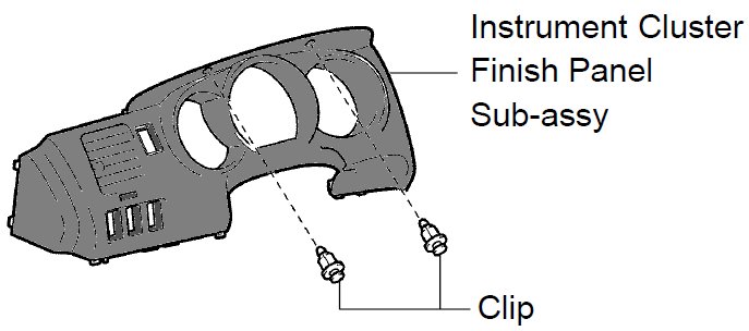

  15. May 16, 2021 at 3:30 PM
    #35
    kmorgan3
    kmorgan3 [OP] Redside Electric, LLC | VLEDS
    Aug 22, 2019
    #302994
    1,952
    Kyle
    PNW
    2020 4Runner SR5 Premium | RAM 1500
    This should make it easier. Looks like just 2 clips and that’s it. The switches will be stuck inside of the panel, though, so maybe just use this to unclip the connector.

    #36
    Philrab
    Philrab Curator of useless knowledge
    Apr 7, 2019
    #289392
    833
    Phil
    New Orleans, Louisiana
    2015 Pyrite Mica Quad Cab Prerunner
    Bunch of Basic Taco mods.
    Yeah, may be a fifteen minute job to add that.
