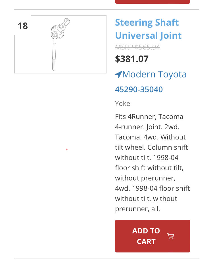

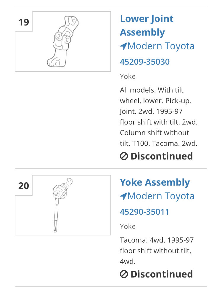

    Hey all, I’ve run into a bit of an issue with my 96 5-speed 4x4. The truck currently has a body lift on it that I’d like to remove. However when the previous owner installed the lift and added an extension for the steering shaft, they welded the damn thing on. I’ve been trying to find a replacement (upper) shaft/yoke (part number 45290-35011), but they’re discontinued.
    It looks like they are still available for trucks made from ‘98 forward with a new part number (45290-35040). I’m wondering if anyone knows if this part will work for my little bastard ‘96 child.

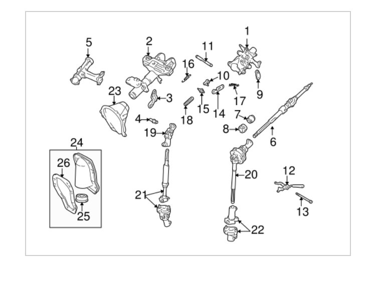

    Here’s the parts diagram for what I’m referring to and the part I’m looking for is (20)
    however, searching the same thing for a ‘98 gives me this
    What do you all think? Anyone have any experience with this?
    Also as a random side note, those specific parts are supposedly used on floor shift vehicles without steering wheel tilt. My truck is a floor shift *with* steering wheel tilt, but I have visually confirmed that style of yolk (upper rag joint integrated into the intermediate shaft) is the one that’s on my truck. Not sure what to do about that information. Regardless it seems that both styles are discontinued anyway as you can see from (19) in the second image.
    Any help here would be appreciated before I just start randomly ordering steering parts for any year taco that still is in production. I’m in Hawaii and we don’t really have pick and pulls out here, plus our dealer staff is clueless about older stuff.

    And yeah it *looks* like it’s the superceeded part, but it doesn’t actually *say* so anywhere that I can tell.
    Im pretty sure there’s a few aftermarket versions (or at least eBay old stock) of that later model part floating around for a lot less than what Toyota charges. So I may just try my luck with one of those.

    Quick update, I've received my '98+ part that I reference above. Upon a quick and dirty eyeballing, it appears to be the same part with the proper length and spline size. I'll update again when I remove the body lift with a final report in a few weeks!
