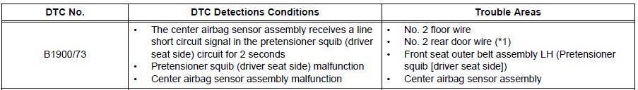

    Hey all, after several rounds of back and forth with the dealership on my airbag light they landed on a B1900 diagnosis of the driver front pretensioner harness having a short in it and the harness needs to be replaced. (both the pretensioner and ECU have been replaced) After telling me this, they proceeded to tell me that the part was discontinued and I may just be SOL.

    So from what i've gathered it's only in the pretensioner circuit, I don't know exactly how the clock spring ties into all that but I assumed that was a separate circuit or would throw a separate code? The only code it has ever given is B1900 for Driver Pretensioner Squib Circuit Short. The horn also does work, for what that's worth.

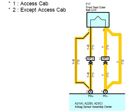

    Since @krm11 has an access cab, the second place I'd look is the flexible conduit at the driver's side access door hinge. According to the wiring/electrical manual, it's actually a relatively simple 2-wire circuit.

    That is read incorrectly, the Access Cab has the intermediate connector BF2 for SRS circuit.

    ^Thank you for the correction. Potentially faster to narrow down the problem with that connector available to split the circuit.

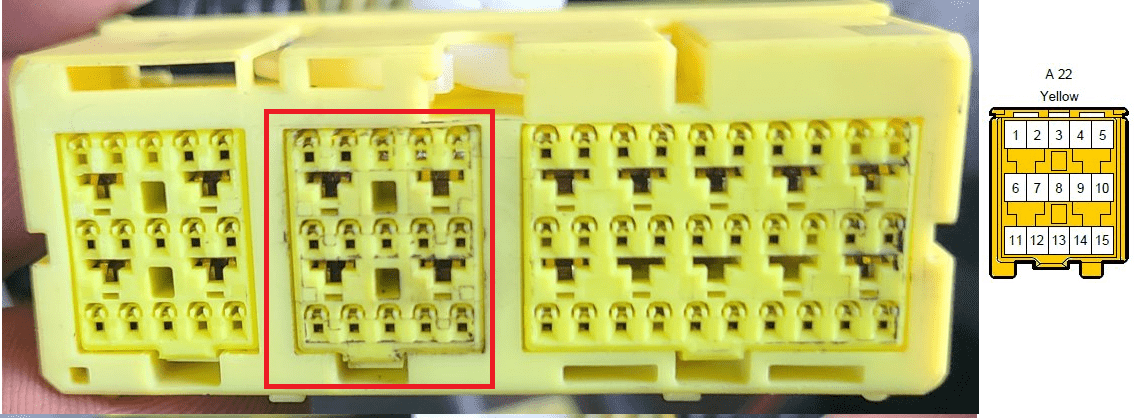

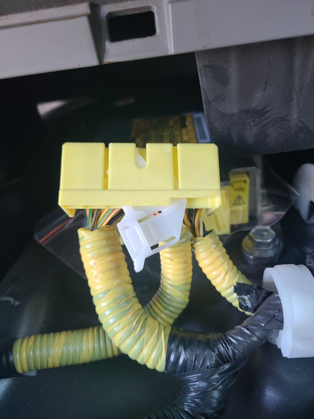

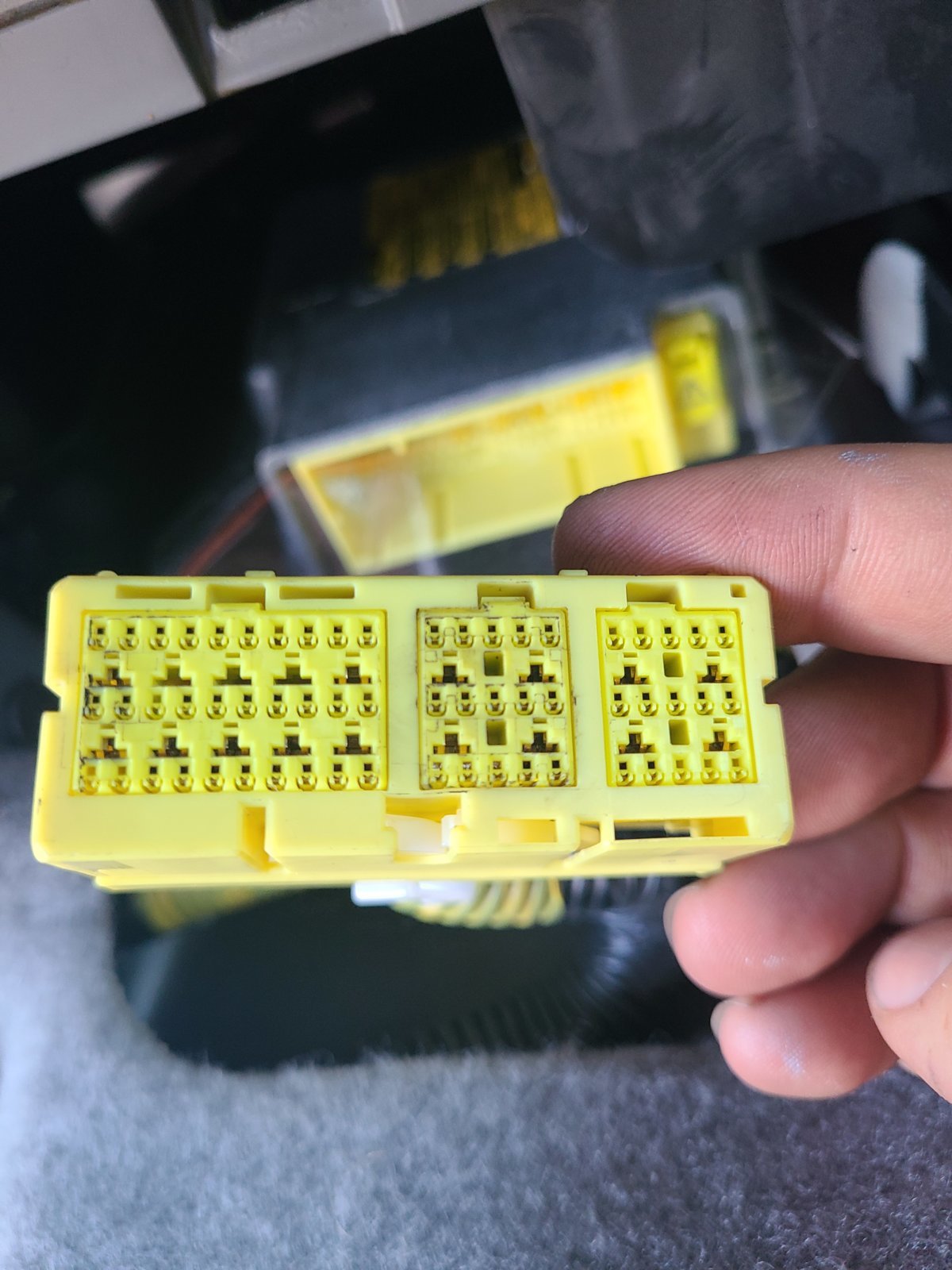

    Does anyone have the diagram of where the harness is routed around the door and what pins on the ECU match up with the pretensioner? I've got it apart and have access to both ends, just not sure which pin to check on the ECU side

    Disconnected to the ECU, verify both wires...:burp:

    Ok, I see now that the pretensioner goes to A22 pins 1 and 2, but there are 2x 15 pin connectors on the ECU, which is A22?

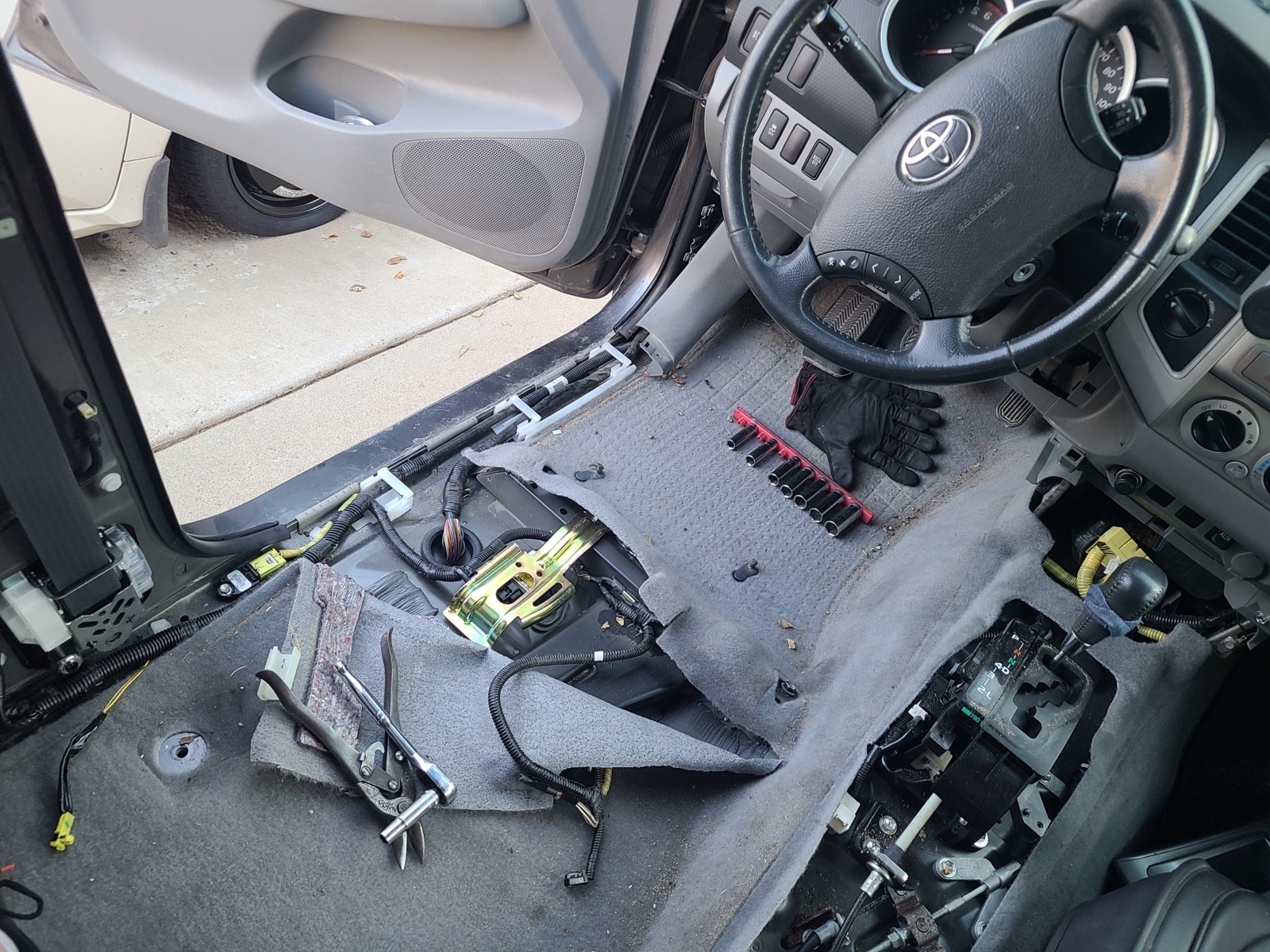

    Thank you, and last question, do you know where the BF2 connector is? I have an access cab truck. I'm working on tracing the wire now but any direction would be super appreciated!

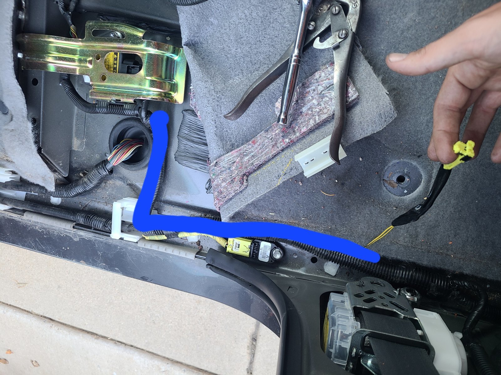

  20. Oct 21, 2023 at 2:38 PM
    #20
    krm11
    krm11 [OP] Well-Known Member
    Aug 30, 2023
    #432436
    74
    Kyle
    2011 Tacoma Ext Cab Long Bed
    Copy, yeah I've got the seat and panels out, here's where I'm at. Blue highlighted is where I'm thinking pretensioner wires are gonna take me
