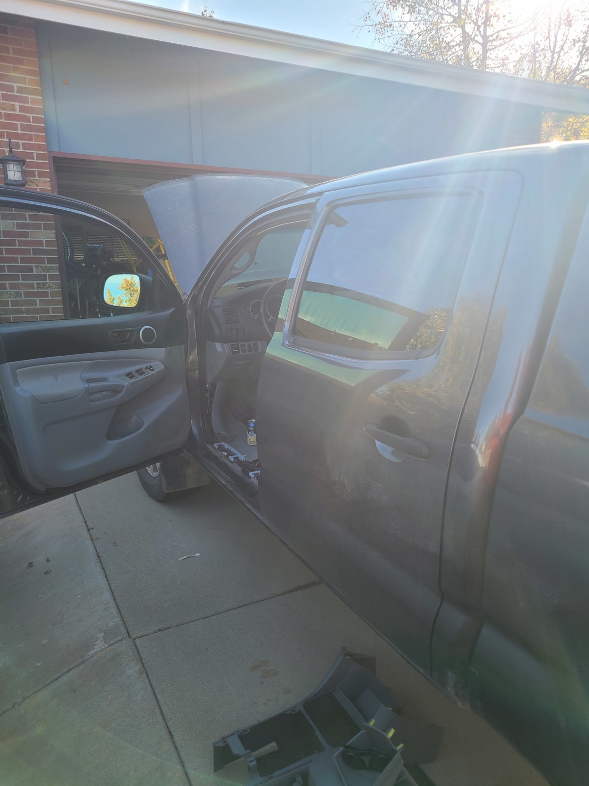

    Oh shoot your image didn't load before I posted, I'm going the wrong way I think! :annoyed:

    Nope, just further back...

    Your pictures don't seem to be from an access cab...:confused:

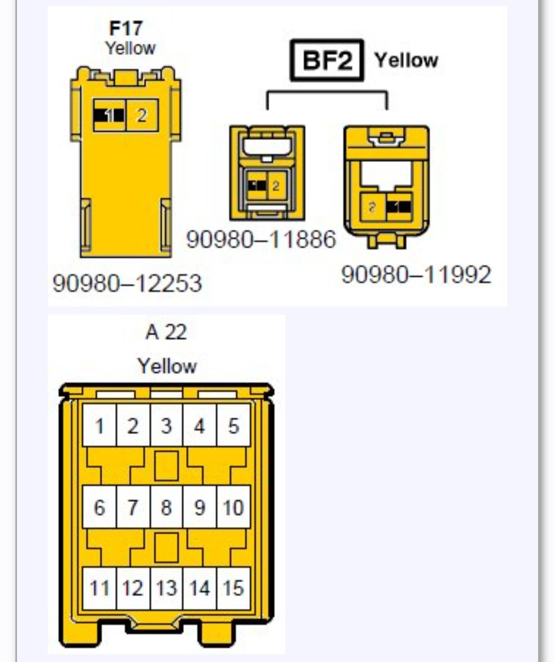

    Yeah I am also very confused. I'm gonna feel like a real idiot but I may be misinterpreting what access cab means bc this is looking like it's going straight to the ECU... pic of my cab attached, sorry for Sun glare

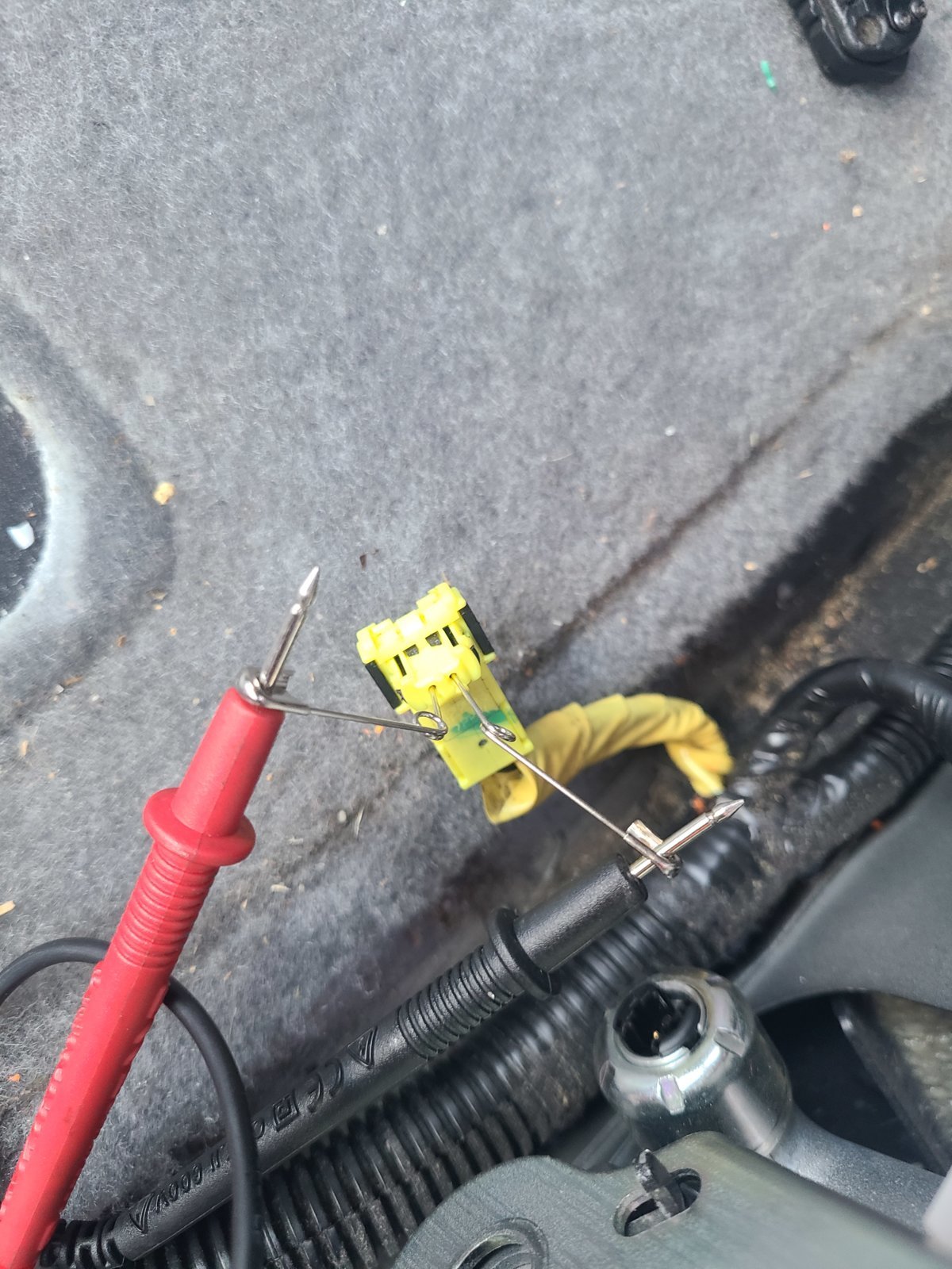

    Hahahaha 100% my bad. At least that explains why I can't find BF2. Lol. So I probed the connector at the tensioner, got short, and I guess at this point am just looking for where in this wire it is.

    Do one wire at a time, since you are not using (shouldn't) use a jumper anyway. Connector from tensioner to connector of ECU.(wire)

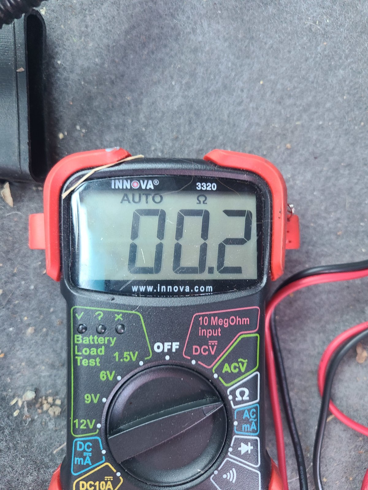

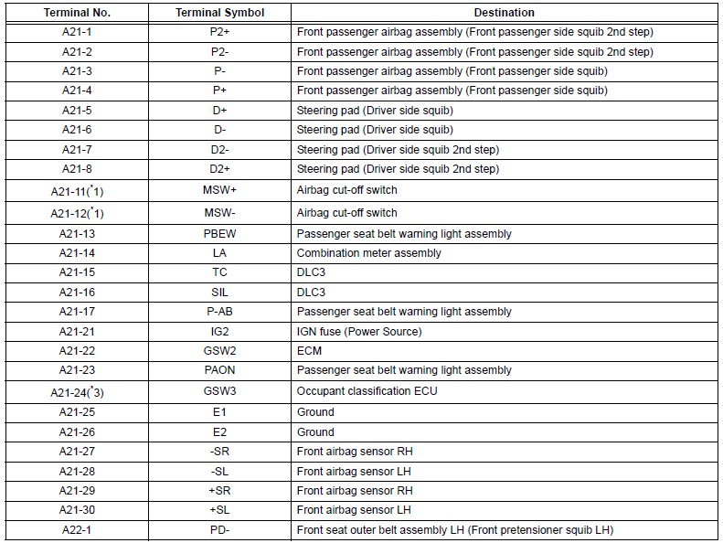

    F17 Pin 1 to A22 Pin 2 : 0.5 Ohm
    F17 Pin 2 to A22 Pin 1: 0.5 Ohm

    I don't have info on what it should be.:frusty:

    No worries, that's the same as what I measure across both pins at the tensioner side.
    So the battery has been off for 1hr+, can I plug the ECU connector back in and probe at the tensioner side of the harness? To eliminate the potential for a shorting bar in the A22 connector being the reason why I'm seeing short

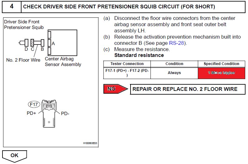

    "Release the activation prevention mechanism built into connector B" what does this refer to?

    I would not ...

    Can't find that info, but my guesstimate is a lever on the connector that isolates the signal to prevent the squid from firing.

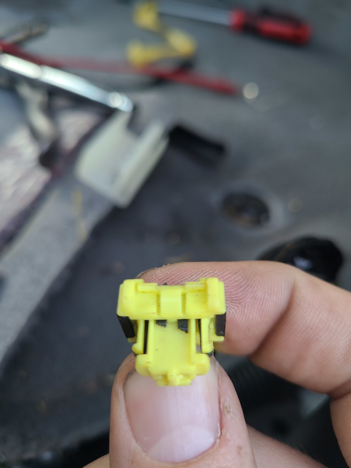

    So after some closer inspection on the tensioner side connector, is this little black piece what clears the shorting bar on the tensioner side? And since it is damaged it is not clearing the shorting bar?

    Ha!...how did that happen? Did you force it off?

    No. It was super easy to come off and I had read about how sensitive they were so I was very cautious.
