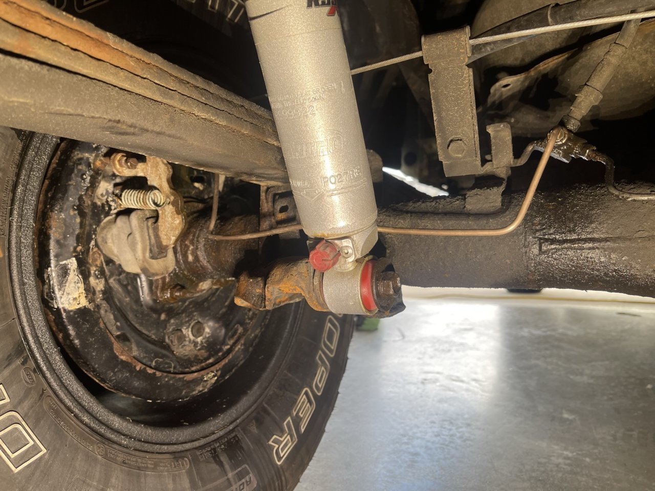

    Hey all, I discovered a rather unfortunate issue when I crawled underneath my truck to diagnose a shudder I was experiencing upon slowing to stops. My driver's side rear Bilstein 5100 shock seems to have unscrewed from the bottom mount and broken through the boot. As you can see, it also completely flattened the hard brake line on that side, which is what I believe to be causing the issue I'm experiencing with the shuddering. I called a Toyota dealer and was able to figure out that the part number I need is 47326-04050.
    The next unfortunate road block I discovered is that this part has been discontinued. I did manage to find it on Toyota Parts Deal and Auto Parts Prime, but both are charging about $330 for freight shipping (on the part that costs about $30). I'm hoping someone here might have some experience with replacing these hard lines for less than I'm seeing through these genuine parts dealers. Any recommendations and help with this issue would be greatly appreciated!

    Most folks just make their own brake lines- it used to be hard to find metric fittings, but that may have changed. Although- you can probably salvage the fittings. That line only runs from the drum to the Y-fitting on top of the axle housing.
    If that's not your thing or you don't have access to a garage, etc... Then it would be best to call some shops around you and find a place that can custom make one for you.
    Edit: What fluid is leaking? If it's brake fluid, you should stop driving it, and get that plugged up right away. If you don't you run the risk of emptying or damaging the master cylinder and ABS if you have that.
