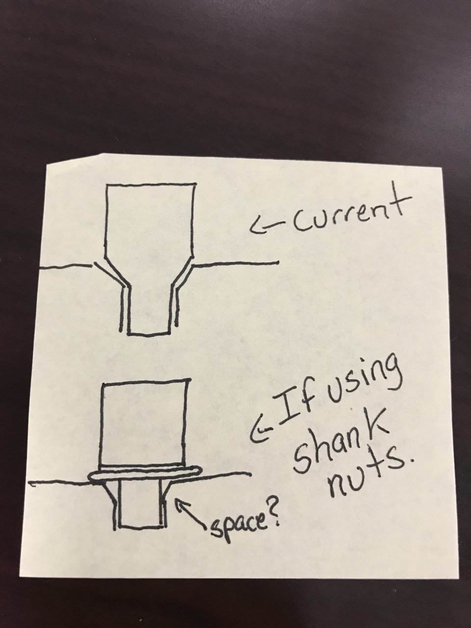

    After filing a complaint i did hear from the DT Manager this morning. After he viewed the pics was still behind his tech on the decision that the lug nuts on my wheels are considered “unsafe” and I should be using the stock shank nuts.
    My concern with using the stock shank nuts (definitely wheels are not my niche in the knowledge bank) is the fact if they sit flat on the wheel, wouldn’t there be a space betweened the beveled opening and the bottom lip of lug nut? Here’s my attempt of a drawing to explain what i’m talking about.

    Nope...that space is nothing to worry about. But seriously.....you're good either way.

    You're picturing it correctly, true shank lug nuts are designed to have clearance. Their job is only to hold the wheel to the hub. The huge center bore of the wheel fits snug over the hub, which centers it on the axle.
    With a taper the nut would center itself on the stud, doing both things. With a taper the center of the wheel can be loose on the hub.
    True acorn types don't have the extended length (e.g. ET, extended thread) like the ones you have, which are kind of a hybrid of both and your wheels seems to be designed to accept either.
    The difference here is really pretty small, so either way you're fine.
    You run into a problem if the styles really don't mismatch. That's where you get a square edge interfacing to a ball or taper or vice versa. You need the lug nuts and wheels to match, the original lug nuts that came with your truck aren't necessarily the right ones for all wheels. That's even true of other OEM wheels, steel wheels are acorns and alloys are shank.
