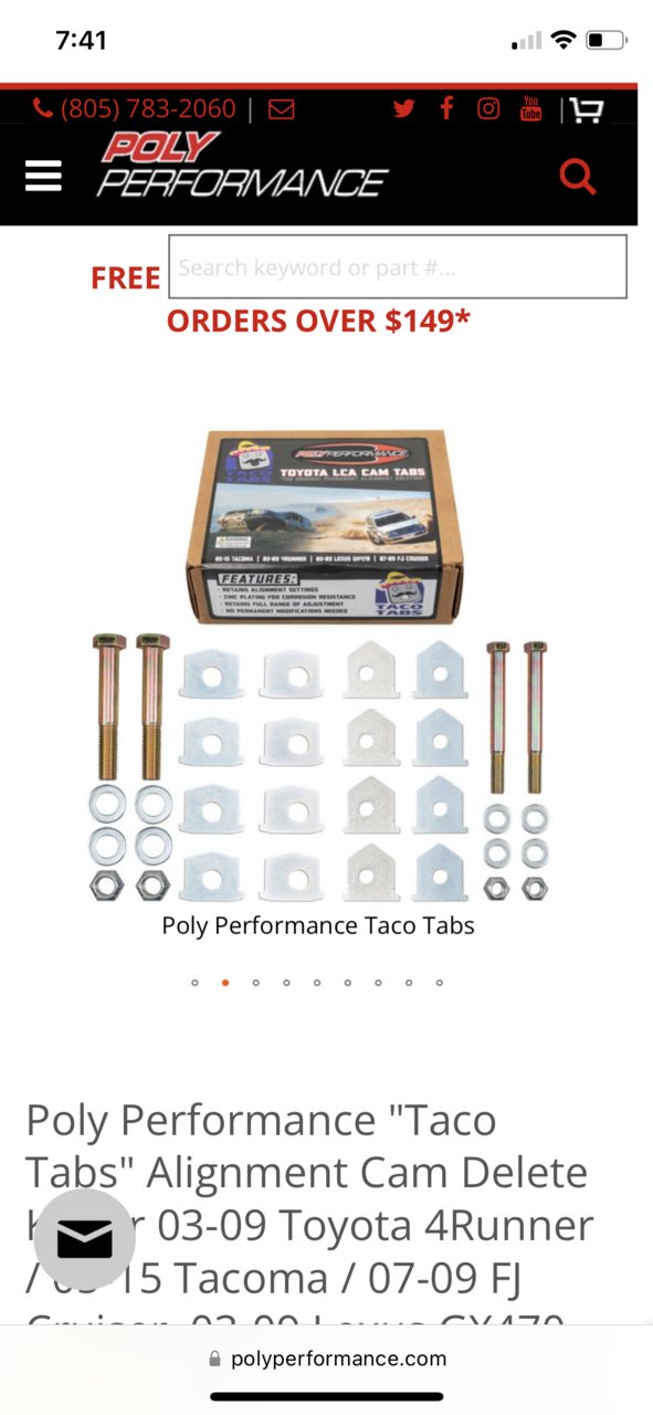

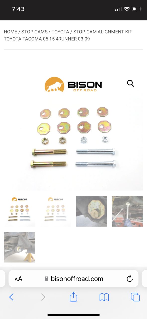

    4F13E870-9779-4A20-9B81-DAC0309C4C66.jpg So I trying to find whats is better, here is 2 product ive search , can u guys tell me the cons and pros on this and which 1 is best and what i need to worry about.. thankx 4F13E870-9779-4A20-9B81-DAC0309C4C66.jpg

    About 16 1" stringers yeah.
    Two cases of beers worth is about all.
    It's not much weld but yes.
    Those others won't solve the overarching problem of the cam tabs flattening from impact and after you get the TC gussets burned on you won't need them either.

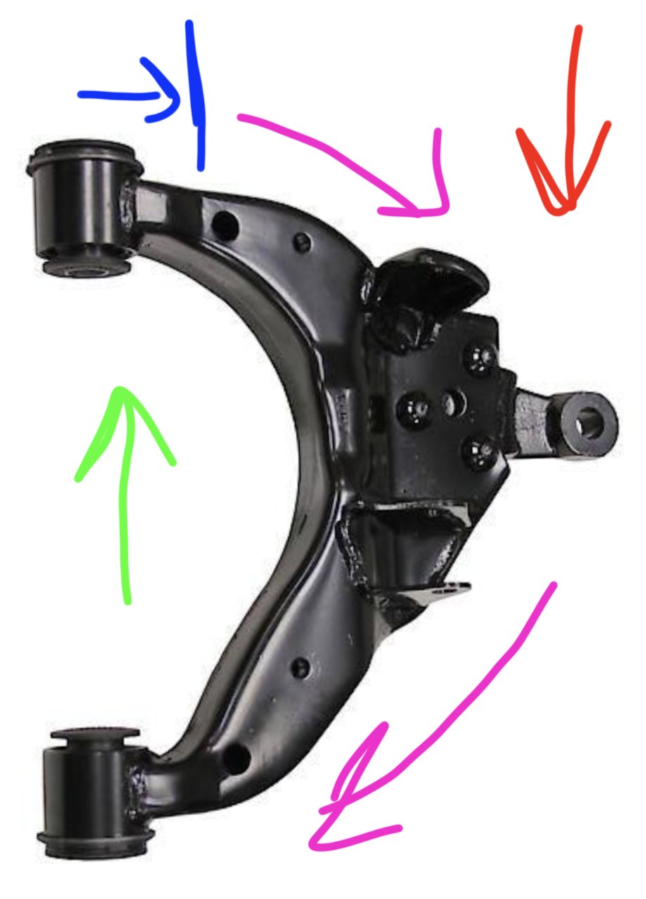

    It's pretty simple, you're traveling green, impact forces are imparted red, rotation of the 3 points purple pulls against the outside tab blue and over time a million little impacts progressively flattens it.
    The same can happen in reverse too.

    In fact it's typically worse as your wheels are often more aggressively angled at the point of impact.
    The tabs are only 1/8" mild brake formed steel, your truck weighs 3k lbs+ smack a piece of 1/8" steel with a 3k lb hammer and see what happens.

    Sorry! To answer your question.
    Alignment shops won't like either options! Neither are simple rotation of the cams to adjust.
    Now if you already know where to set your alignment. Then these will work great!
    I would get the Bison just because it's all-in-one. (Too easy for me to misplace the Taco Tabs)
