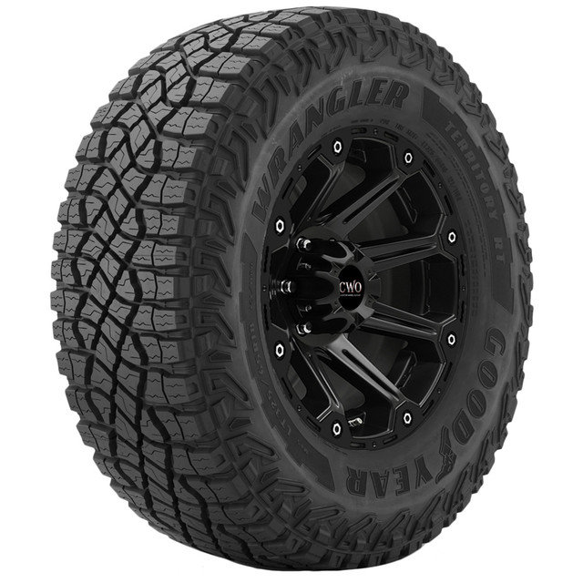

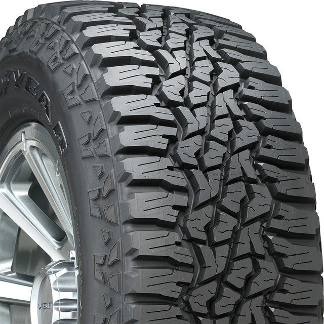

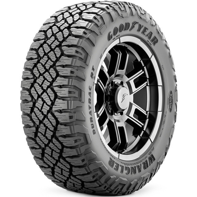

    :bananadance:Here i am trying:annoyed: to decide on tires for my 2020 TRDOR .I live in snowy northern Wyoming. I do only slight off-roading but i want to perform well in snow, slush , rain, and ice. looking good is on my mind so here are my picks, please discuss. i also have the stock rims for TRDOF and am curious what different tire sizes will fit other than the 265\70\16 i currently have on there.(no need to stay on topic) :help:Any advice is welcomed :thumbsup:O i also went over many other tires , these are just the ones i settled on.
    • GoodYear Wrangler Duratrak RTgoodyear-wrangler-duratrac-rt_21d7d33f85840f3d678af0f04dc33810501d7daf.jpg
    • Goodyear UltraTerrain AT ultraterrain_4f5aafb690fc492c6f669d8a73203afc2813d8a8.jpg
    • GoodYear Wrangler Territory RT (although ive seen identical tires labled with AT, help)goodyear-wrangler-territory-rt_d0e38006b55c58f43ba9210aa6f273f66e56ba9c.jpg

    265/75/16 will also fit without any issues. I have been running the regular duratracs for years. The RT are new so there's not many reviews on them. The regular duratracs are great for winter driving, they perform really well in slush/ice and especially well in deep snow. The RT retains the three peak designation so they are probably comparable.

    i looked at the duratracs and they do look effective in mud and snow , the reason i wanted to go with these is because they have a ton more sipeing and seem to have maybe less ability to work in mud because less channels but better on road performance. i think the tradeoff might be worth it

    I think the RT version will be a better road tire than the original and I assume they would be just as capable on slushy icy roads, maybe not as capable in deep snow though. Not sure what size and load range are offered though. I also run duratacs because I can find them in C load. One of the few tires available in that load for 16 inch rims. I wouldn’t recommend e load tires for your use. The Michelin defender mentioned above is also a great tire, I run them on my highlander, that being I would say the duratac has better winter performance. I think the RT version would be similar and offer better road performance.
