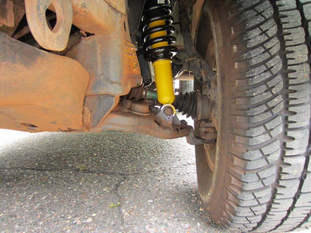

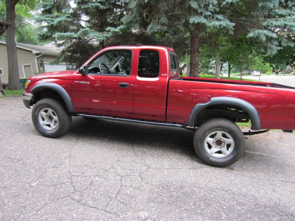

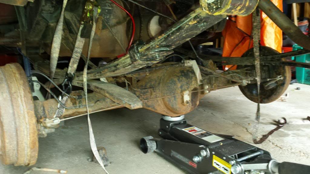

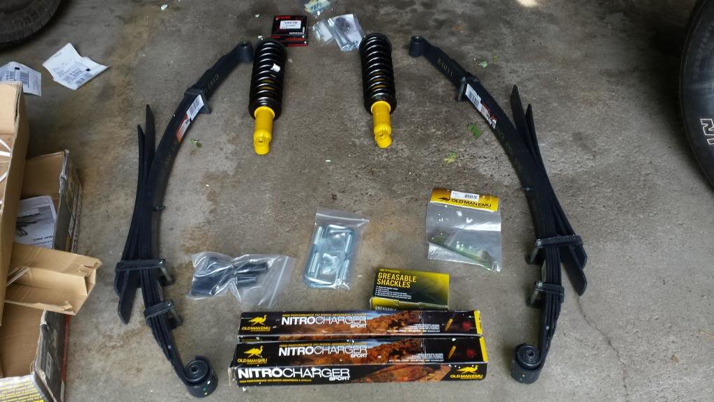

    I installed a full OME Kit from Wheelers:
    This is a bad pic as I took it on my angled driveway and before driving it to settle everything in. It now sits perfectly level.
    More to come.
    Edit:

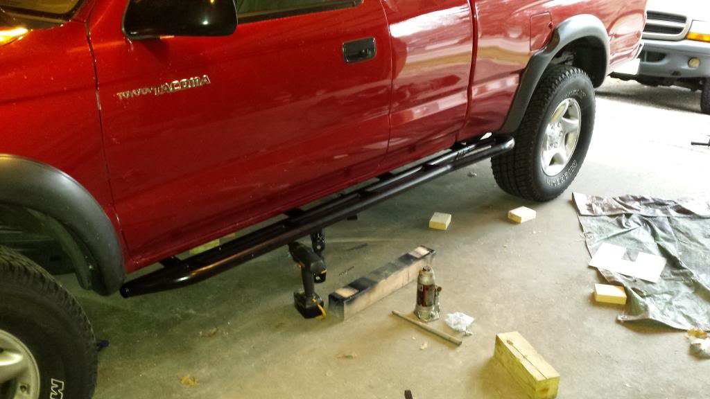

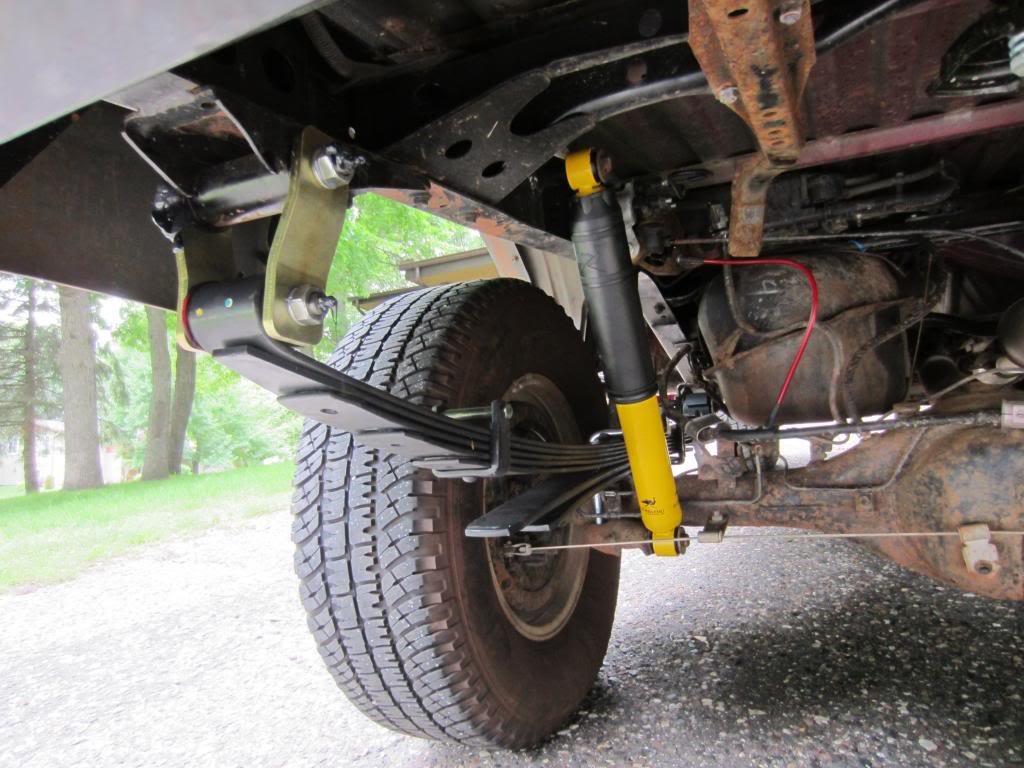

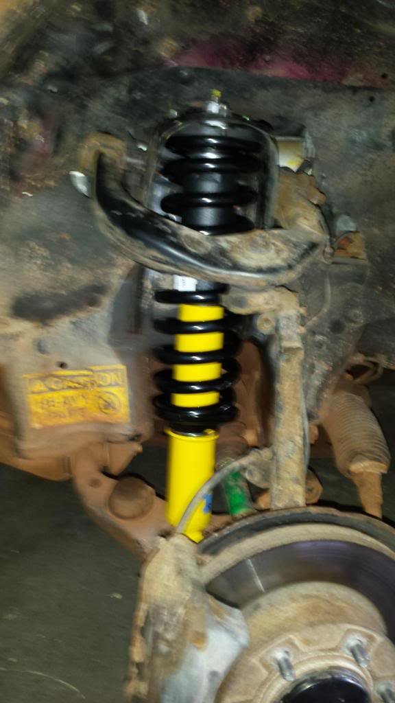

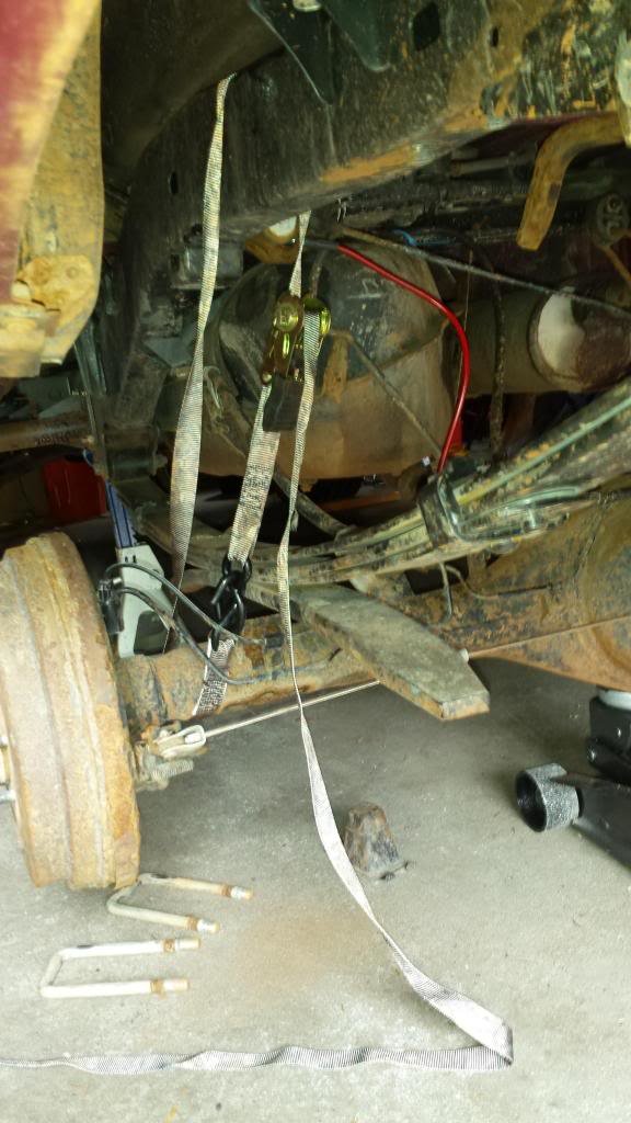

    Added some pics of the install:
    Using the ratchet straps to hold the axle worked like a charm. Once one jack stands, I lifted the axle slightly and tightened down the straps. Then, I disconnected the u-bolts. With the jack taking the weight of the axle, I loosened the straps and lowered the axle until the axle was no longer connected to the leafs. After that, the old leafs were easy to remove and the Dakars went in in reverse order.
    With the axle hanging by the ratchet straps, it was very easy to shift the axle around to get it centered to the new leafs. I did have to use the jack under the pinion to rotate the axle and once done, I installed the new u-bolts hand tight to keep everything together until back on the tires and torquing the bolts down.
    I know others have suggested using a bottle jack to get the leaf bolts connected but I found this unnecessary. I installed the frontbolt first followed by the shackles and had zero complications.

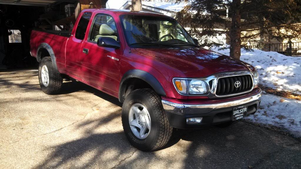

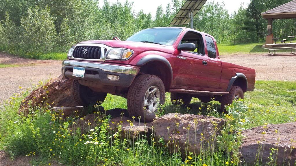

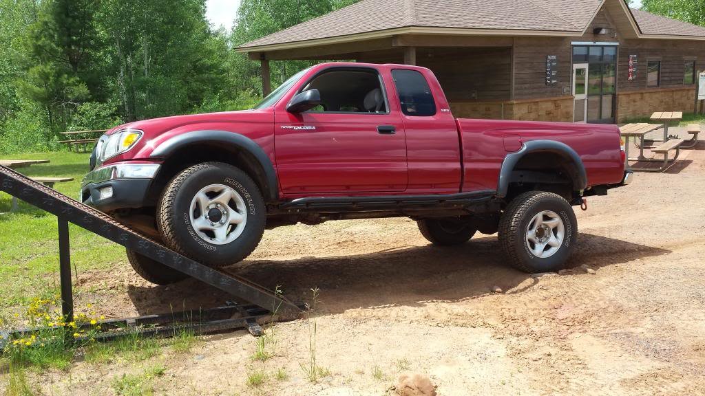

    Here's the only pic I got from this last weekend at the OHV park.
    New suspension ran great and is greatly improved over OEM. Having the improved suspension and lift also now adds to the need to prioritize future upgrades.
    Tires and gears will eventually happen but so far I haven't found anything where I've truly "needed" them. Mud, rocks and extremely steep inclines/declines haven't been an issue.
    Things I do need sooner than later is a Hi-Lift and some way to mount it, a CB, new front bumper and skids. It'll probably happen in that order but skids may come before the bumper so we'll see.

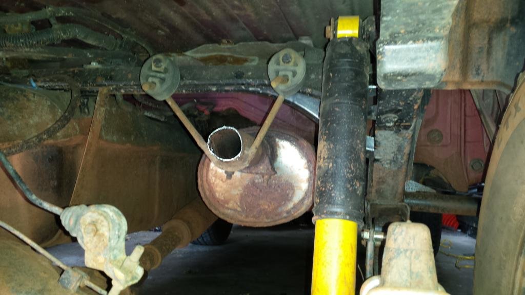

    Found that my exhaust pipe was nearly rusted through just past the muffler. So...
    Rusted exhaust pipe+Sawzall=

    I was just wondering if you had any post settling pictures of your truck on level ground. I have the same machine minus sliders and have been debating 881 vs 882 springs. I'm worried the height won't be what I want.
    Thanks man and looks good!

    I'll take a pic tomorrow. I've placed a level on the bed and its level in both directions.

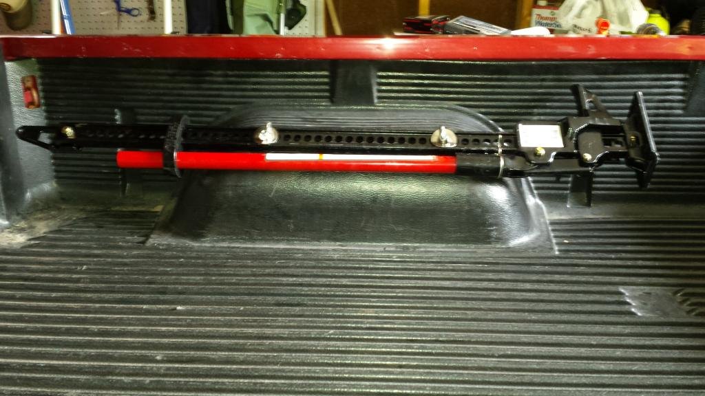

    Mounted my Hi-Lift jack. I used:
    (2) 0.5"x2.5" bolts
    (2) nuts
    (6) very large washers
    (2) wingnuts
    There is a 1" gap between the wheelwell and the drop-in liner which is why I needed such a large bolt. I park indoors so I don't have much of a need to lock the jack. Plus it takes a screwdriver to undo the wingnuts so theft should be unlikely except for determined theives.

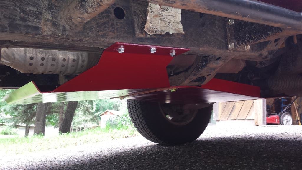

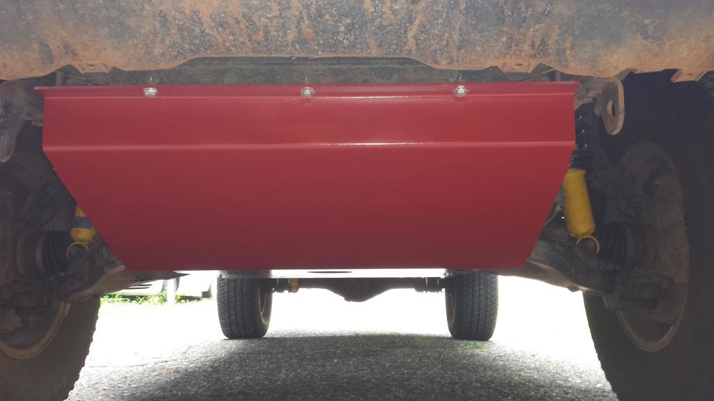

    I got a set of 1/8" RAT skid plates yesterday and mounted them today. Say what you want about the 1/8" steel but these are far superior to the OEM, both in thickness and the extra coverage.
    I sanded them, cleaned them with citrus cleaner then gave them 3 coats of primer followed by 5 coats of regal red.

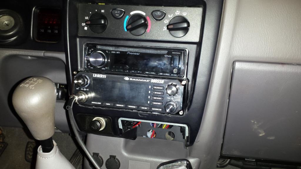

    Installed my CB over the weekend. Uniden Bearcat 980 with an aftermarket radio in the stock radio location. I mounted the antenna to the rear bumper and with running the cable down the framerail, I had very little excess cable to worry about.
    It took alot of dremel work to the center surround to get everythingto fit but it works and looks good.
