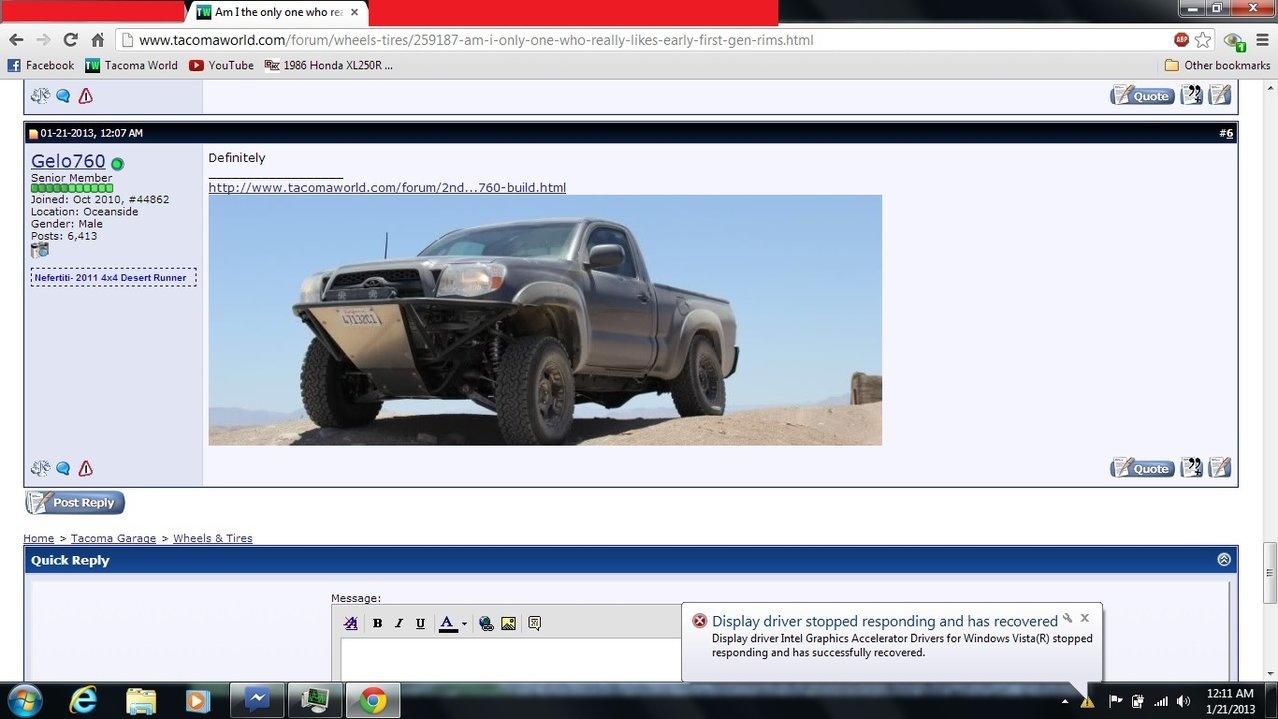

    This happens randomly, As for example I'll be on TW and streaming music and the screen goes black then everything comes back. When it's back everything is fine and normal till it happens again. I don't know anything about computers so hopefully one can assist me.

  6. Jan 20, 2013 at 10:03 PM
    Fightnfire
    Fightnfire Recklessly tired
    Jun 12, 2011
    #58178
    5,853
    Marysville, WA
    09 Access Cab V6 4X4
    Softopper, Bilstein 5100's @ 1.75 in the front, TSB Rear, 17x8.5 Lvl 8 Guardians, 265/70-17 Goodyear Wrangler Duratracs, Scooped, Anytime fog mod, Osram Nightbreakers, LED Interior lights, Debadged, Painted valance, Removed rear head rests, De-flapped, Hidden Hitch installed, Weather Techs, Flyzeye'd A/W/A, Cover Kings,... oh and the hot wife mod.
    That looks like windows 7, why a Vista driver? Try to update your display driver via the manufacturers website.

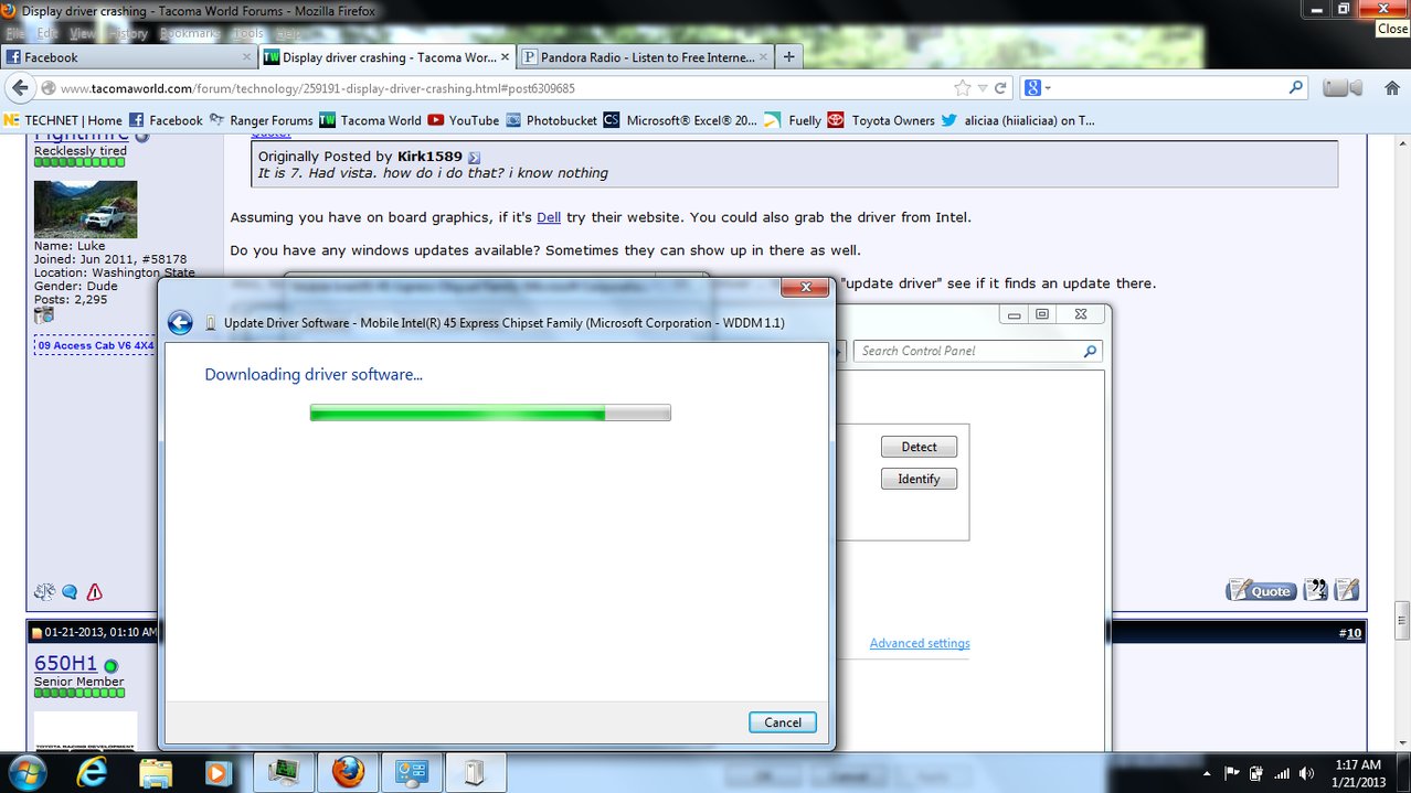

  9. Jan 20, 2013 at 10:08 PM
    Fightnfire
    Jun 12, 2011
    #58178
    5,853
    Marysville, WA
    Assuming you have on board graphics, if it's Dell try their website. You could also grab the driver from Intel.
    Do you have any windows updates available? Sometimes they can show up in there as well.
    Also, look under Display Settings > Advanced Settings > Properties > Driver .. then click "update driver" see if it finds an update there.

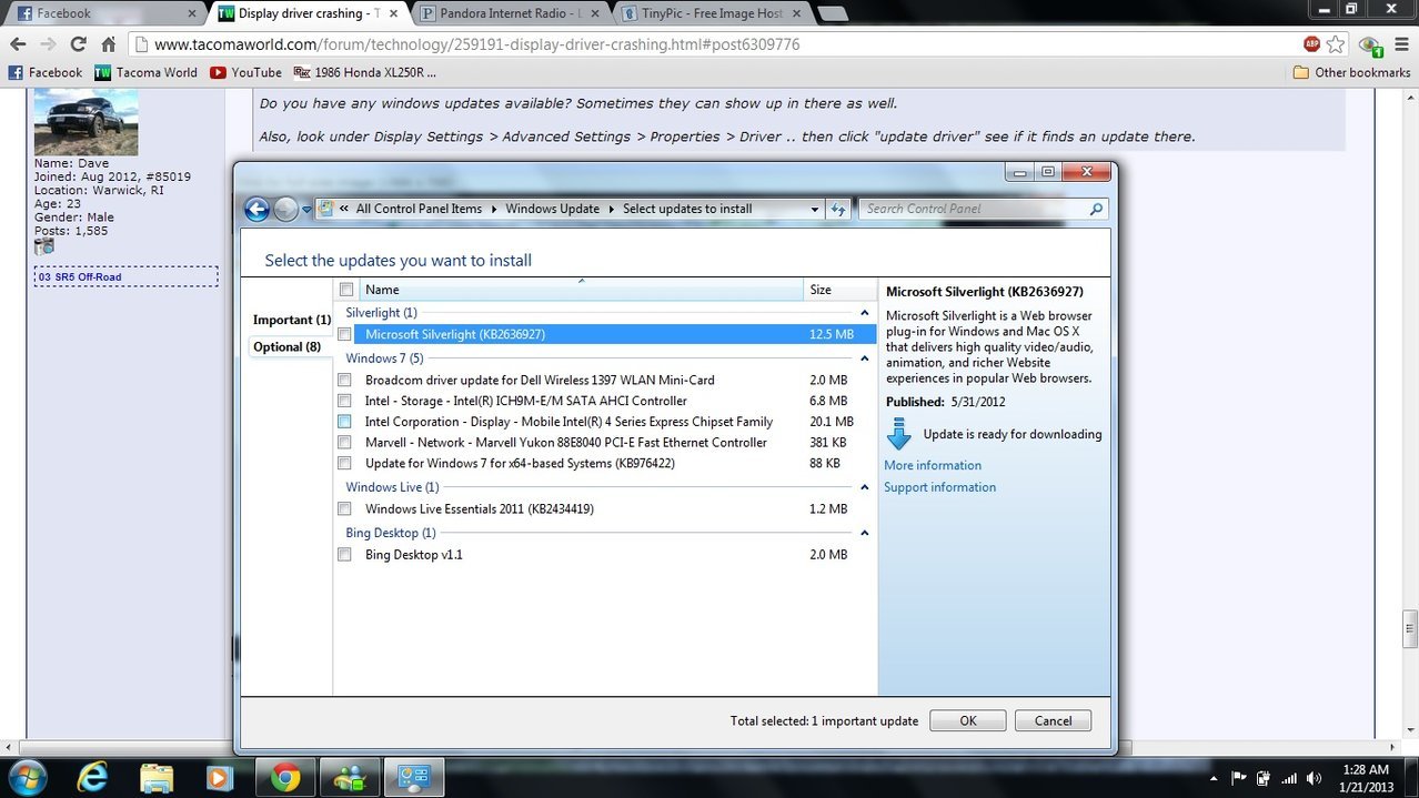

  12. Jan 20, 2013 at 10:29 PM
    Kirk1589
    Kirk1589 [OP] Well-Known Member
    Aug 18, 2012
    #85019
    5,196
    Dave
    Sticks-RI
    03 SR5 Off-Road
    Pasti-Dip Grille, K&N drop-in, Magnaflow 14", Custom tail light mod, Fog light mod, diff vent mod, Alpine Components, Sequoia JBL radio
    i think i just found it?

  14. Jan 20, 2013 at 10:31 PM
    Fightnfire
    Jun 12, 2011
    #58178
    5,853
    Marysville, WA
    I would grab all of those except the last 2 (unless you want them) were you able to see a driver update available from the display settings?
    My directions were from Vista, below is a video from youtube for 7..
    Watch this: http://www.youtube.com/watch?v=cCpUC33pVXQ
