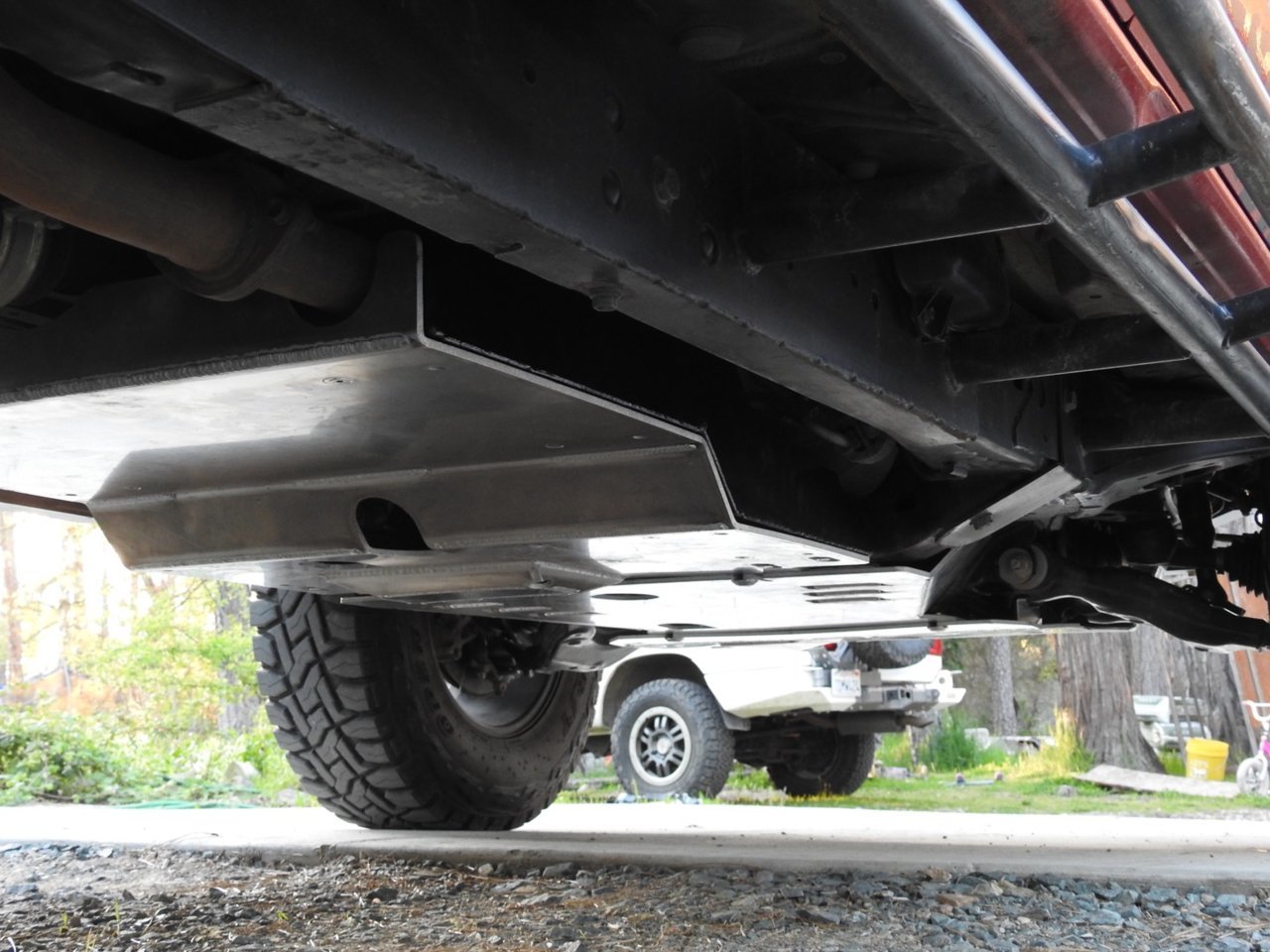

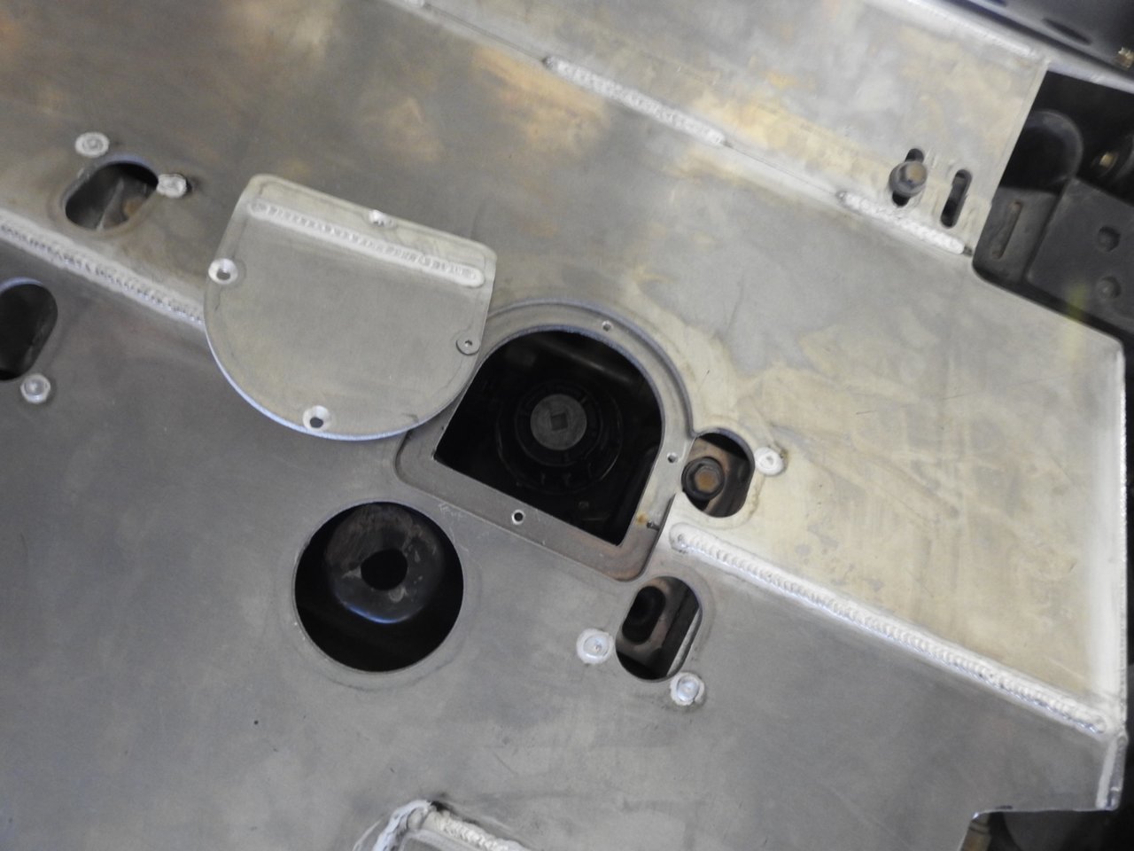

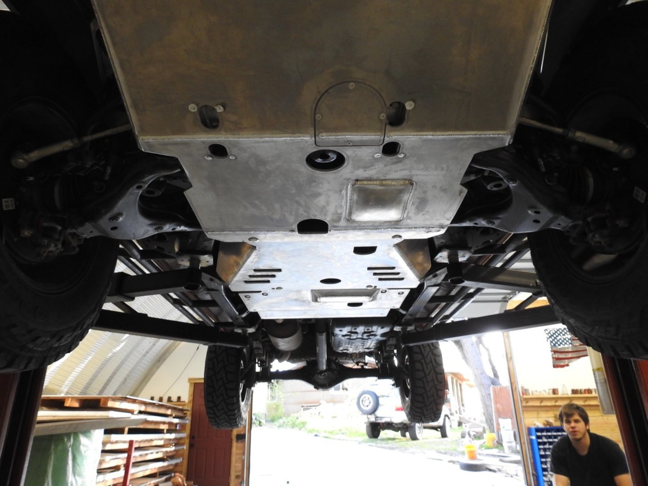

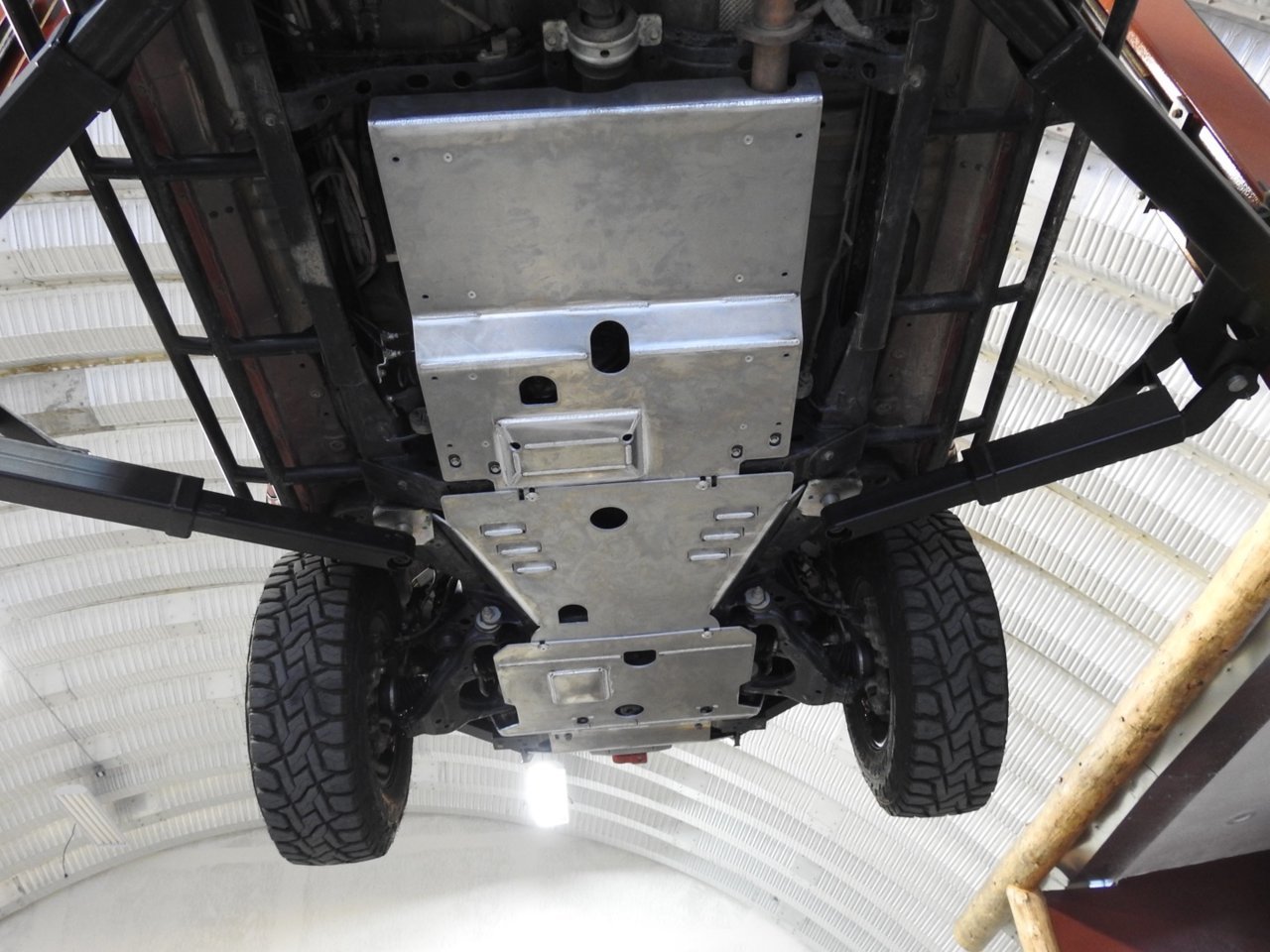

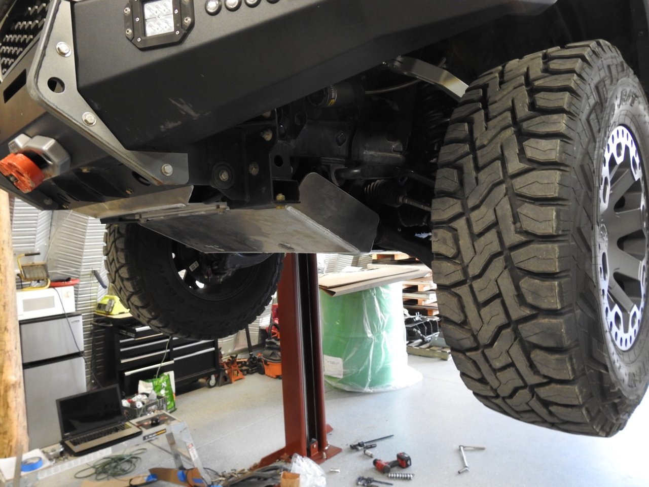

    IMG_0618.jpg IMG_0619.jpg IMG_0620.jpg IMG_0621.jpg IMG_0623.jpg IMG_0611.jpg Hey guys, the next Tacoma product is currently in the works and soon to be released!
    These skids are cnc cut and formed from 1/4" 5052 aluminum, there are bulges around the diff and exhaust to maximize clearance. The full set will include an extremely strong subframe that bolts to the trans crossmember and to the rear crossmember, this allows the rear skid to attach to the new subframe and not to the frame rails. This will eliminate any interference with different types of slides. This also provides more coverage than other skid systems and runs all the way back to the carrier bearing. All bolts are counter sunk or have counter sunk washers. There are access holes for all major maintenance items as well as louvers for venting and cooling. Price point should be around $1000 for the full set with sub frame. I will be testing these out in Moab the beginning of next month and will finalize when i get home. Let me know if there is any interest or suggestions.
    Thanks!

    Will you make a mid plate that's solid no bulge for people with exhaust reroute?

    Possibly.
    The problem is the subframe may cause an issue with the route.
    I could clearance the subframe but that would rely on all rerouted exahaust to be the same

    Those look real nice. good job on the design. I like how you thought about the carrier. nice workmanship as well. cheers

    I'd be interested in the Mid section plate. Will they be able to purchased individually? Looks like it will mate up to my existing steel skid. Any pics from inside? Are they ribbed?

    No pics of the inside yet but they will be internally reinforced.
