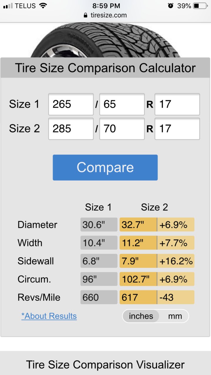

    Bro do you even math?
    Original 353
    Current 295 x 6.9% = 315
    353-315 = penalty for going bigger.
    Guessing that you’re also auto and the tranny doesn’t shift into 6th as much as it used to as well. More fuel wasted. Gotta pay to play.
