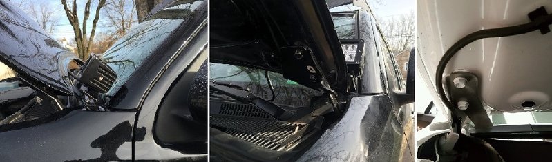

    MOUNTING OPTIONS FOR 1ST GENS.
    No matter what company you choose there are generally three different options for mounting the bracket 1) Hood Hinge Mount
    or 2) Engine Compartment / Cowl Mount or 3) A-Pillar / Door Mount
    There are positives/negatives to all mounting systems.
    Your mounting option will be dependent on your individual need, what generation truck you have, and sometimes dependent on other mods you have already done/plan on doing.
    The cool thing about the 1st Gen Mounting systems is that you can pair two different mounts to double your lighting near your side mirrors. The only way this works is that one of the systems must be the A-Pillar / Door Mount system and this is only confirmed using the SRQ brand mount - see below.
    1. Hood Hinge Mount:
    This system uses the two factory bolts, on each side, on the hinge of your hood. You do not have to remove hood during this process rather just work on one side at a time loosening the bolts and slipping the bracket into place. This install can be done in 15 minutes or less with one person and one socket wrench.
    Positives: Simply installed, lifts w/ hood
    Negatives: lifts w/ hood, some brand of brackets will put light pod in "line-of-sight".
    Things to consider: Lifts with hood when opening, possible interference w/ snorkels (see individual manufacturer)

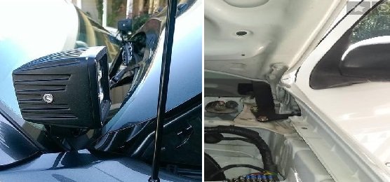

    2. Engine Compartment / Cowl Mount:
    This system uses three bolts on each side that are usually provided with the purchase of the product. You will need to remove the cowl (the plastic piece near the windshield) and the window wiper blades to install this type of mount. Some companies will require you to trim the cowl for a proper fitment.
    Positives: Stays in place when hood is open/lifted, Usually is placed closer to A-Pillar and out of "line-of-sight".
    Negatives: Permanently trimming the cowl, Stays in place when hood is open/lifted
    Things to consider: Stays in place when hood is open/lifted, possible interference w/ snorkels (see individual manufacturer)​

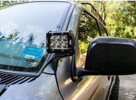

    3. A-Pillar / Door Mount:
    This system uses two bolts or self tapping screws on each side of the bracket. You will need to drill holes into the A-pillar to mount this bracket or use the self-tapping screws to secure the bracket into place. This is very similar to how many roof light bars are mounted in doorjamb. Unfortunately there are no photos available for this specific ditch mount, but from the picture below you should be able to gather how this mounting system works.
    Positives: Stays in place when hood is open/lifted, The light pod is placed almost directly in front of the A-Pillar and out of "line-of-sight".
    Negatives: Permanently creating holes in the A-Pillar, stays in place when hood is open/lifted
    Things to consider: Stays in place when hood is open/lifted, Definite interference w/ snorkels (see individual manufacturer)

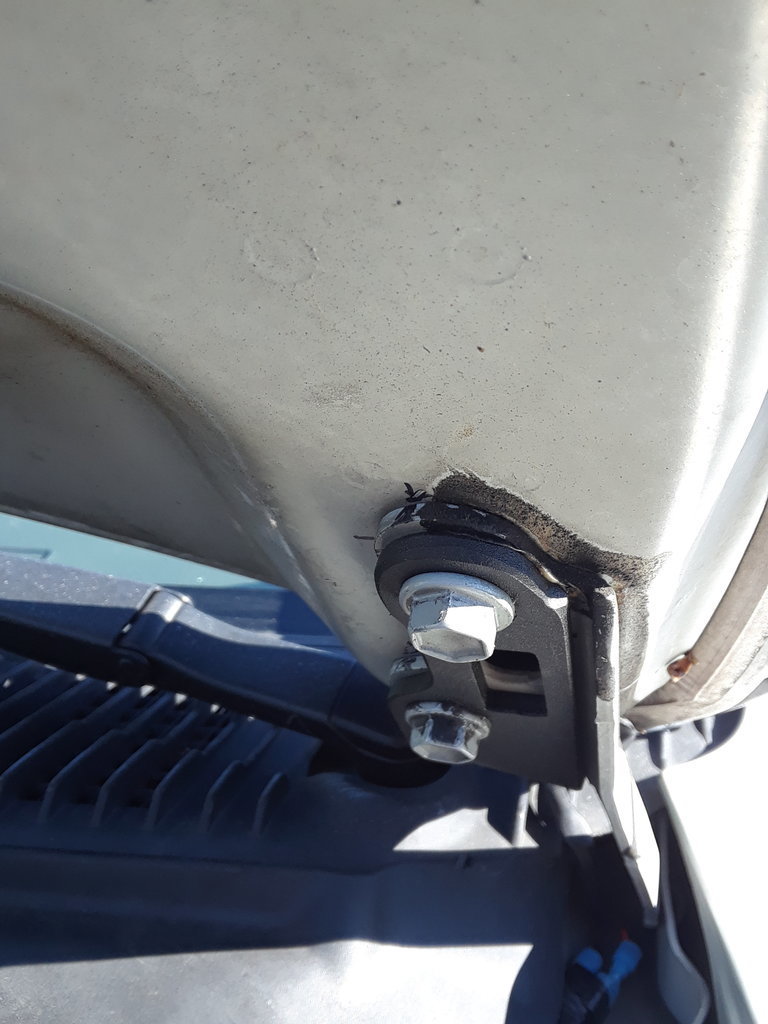

    Negatives: lifts w/ hood, some brackets will put light pod in "line-of-sight".
    Things to consider: Lifts with hood when opening, possible interference w/ snorkels (see individual manufacturer)​

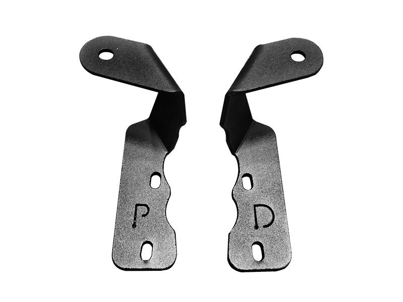

    Relentless Hood Hinge Ditch Light Brackets
    Bare $44.99
    Powder Coated $54.99
    Hood Hinge Mounted
    3/16" Steel
    90º Bend on Backside opposed to Right/Left (See T-Rex for comparison)

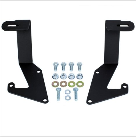

    CaliRaised Ditch Light Brackets
    Small hole for Light Pod Ziptie to bracket (See image 3)
    < 90º Bend on Backside

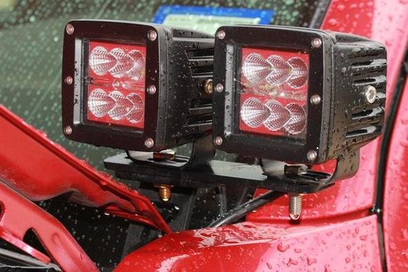

    SOSConcepts Ditch Light Mounts / Antenna Mount (PAIR)
    Bare $60.00
    Powder Coated $80.00
    Hood Hinge Mounted
    Will also fit 03-09 T4R w/ Cowl Trimming
    598FEBDA-BD65-41E9-A7BA-FB5E31BBF60E_zps_7a01a3b0726996666aaeb6251e823e39543076f0.jpg

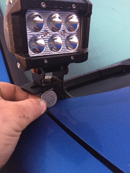

    Edit: just noticed CBI. Indeed there is. Which brand did you go with? Only cutting I had to do was that plastic piece that gropes across where the wipers are.
    Go to Rago's website. They have step by step instructions for everything they sell. Assuming their design is somewhat the same it'll work for you.

    This piece that you're referring to is called the cowl. The CBI sometimes requires cutting on the 2nd Gen as well.

    Did a set on my buddies 2nd gen (Rago) and there was no cutting required, however mine I had to trim up quite a blitz and yes! Brain fart.
