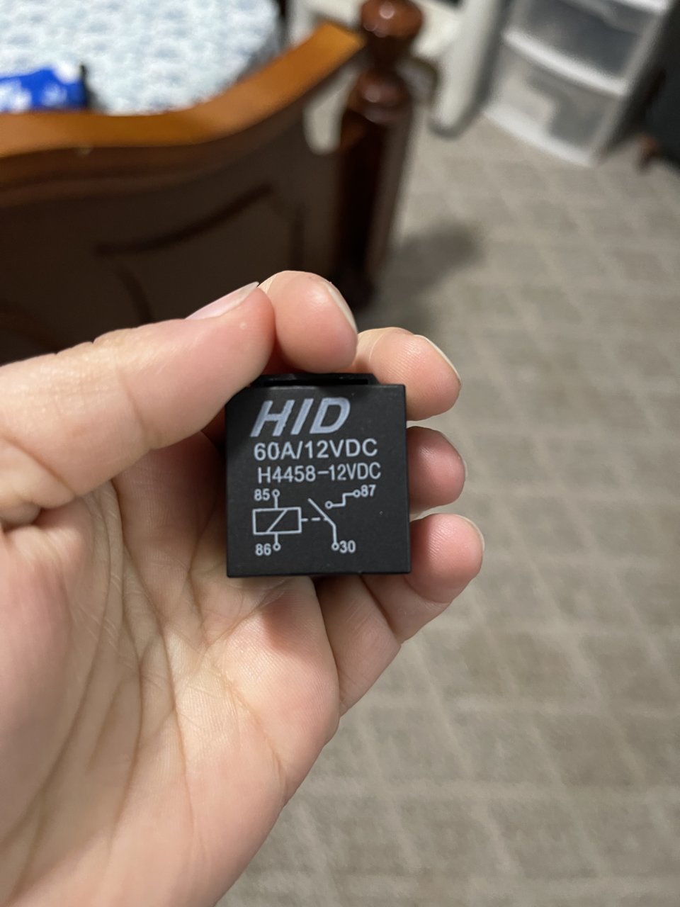

    Hi, I’m new around here and I need some help.
    I was installing my ditch lights, and accidentally blown the relay. The relay is 12v 60amp 4 prong and I can’t seem to find it anywhere. Some of the ones I found are 60/80amp or 70amp.

    This is the one I had.

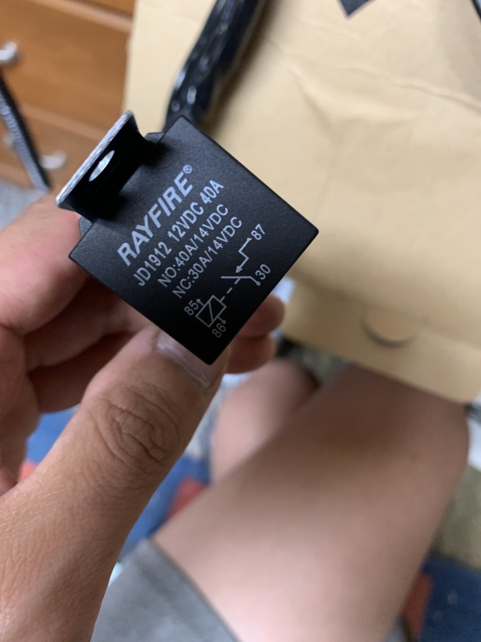

    Thank you guys. I switched the relay to the 40amp they have at Autozone for 8 bucks and it worked. Thanks again.
