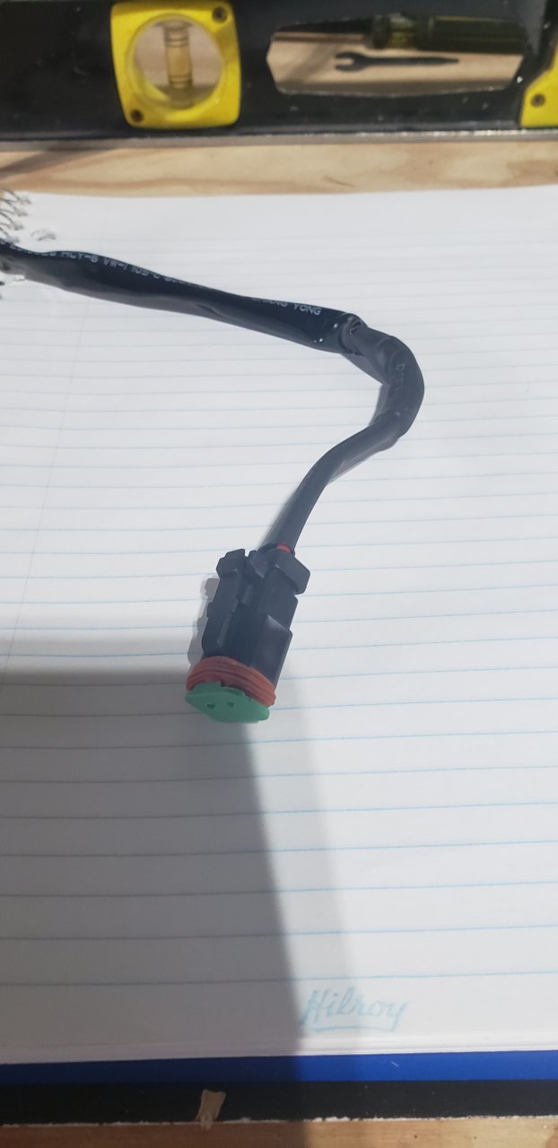

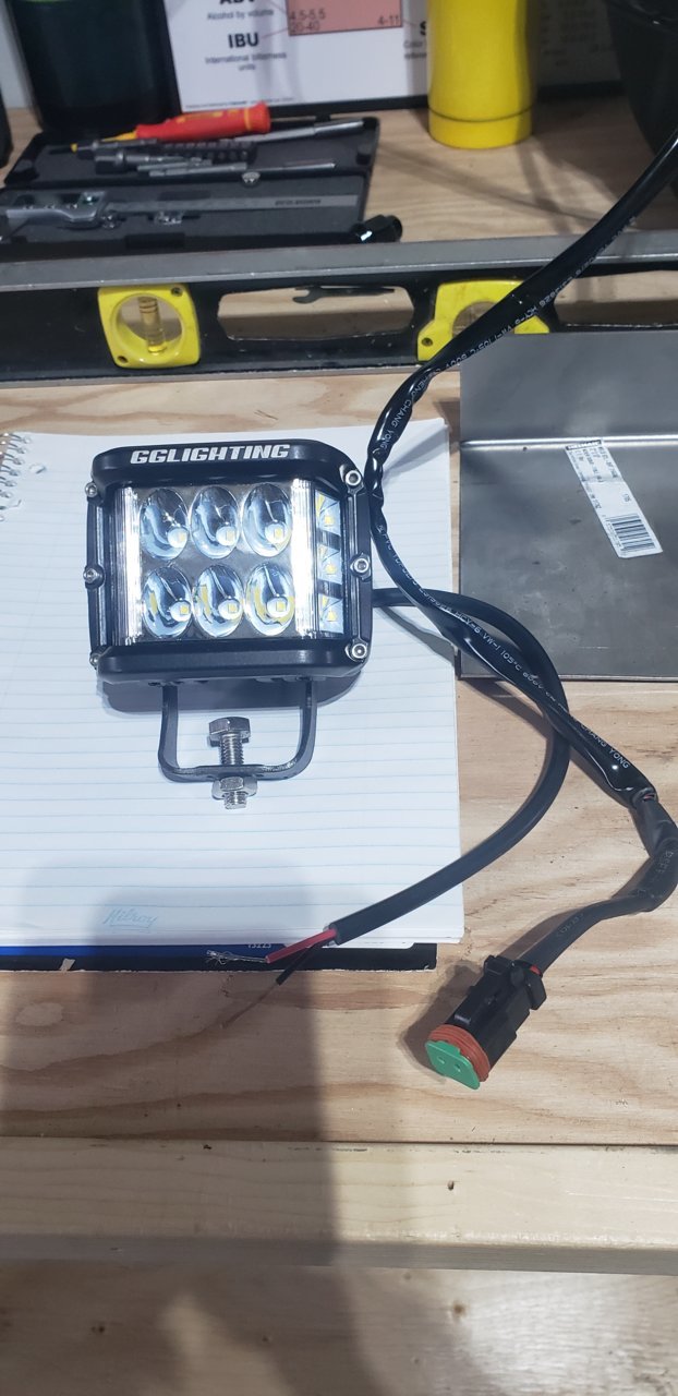

    Bought a set of GG-Lighting Ditch Lights and a wring harness to go with (see pics)
    Not sure how to wrie the two up too each other?
    Disclaimer; I am an idiot when It comes to most things...... Electrical is a whole different level for me :)
    Any help would be greatly appreciated.
    Cheers
    Ryan ♥️

    The Green End pictured in my pics is 1 of 2 ends from the wiring harness.
    Not sure what to "plug" into the 2 Left & Right Ends?

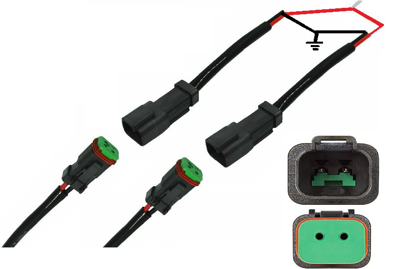

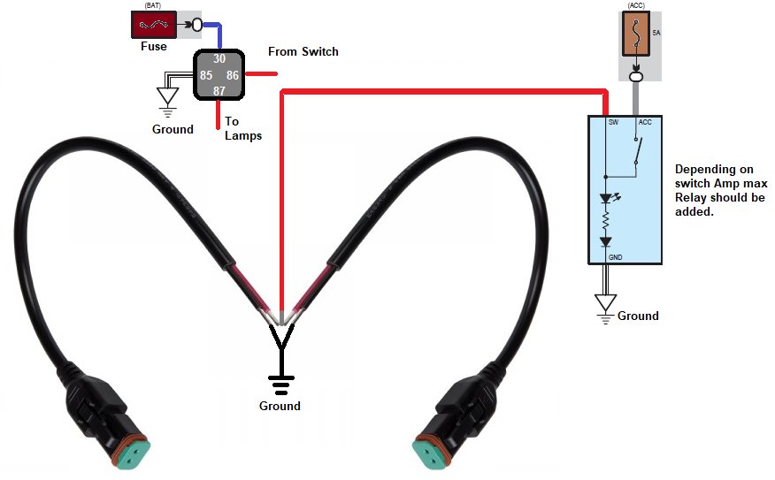

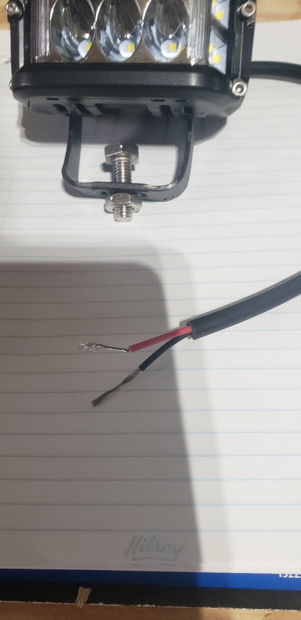

    Thanks for the diagrams, but what gets plug , attached, ect to the Green ends of the wiring harness.
    I have a Red&Black bare wires from the Ditch Light.
    How do I attach the Red&Black wires from the Ditch Light to the "Green" end of the Harness?

    Thank You very much!! That's what I'm looking for..
    I could probably cut off the "Green" End and solder the ends together, but would rather have that above connection to have a removable weather tight connection.
