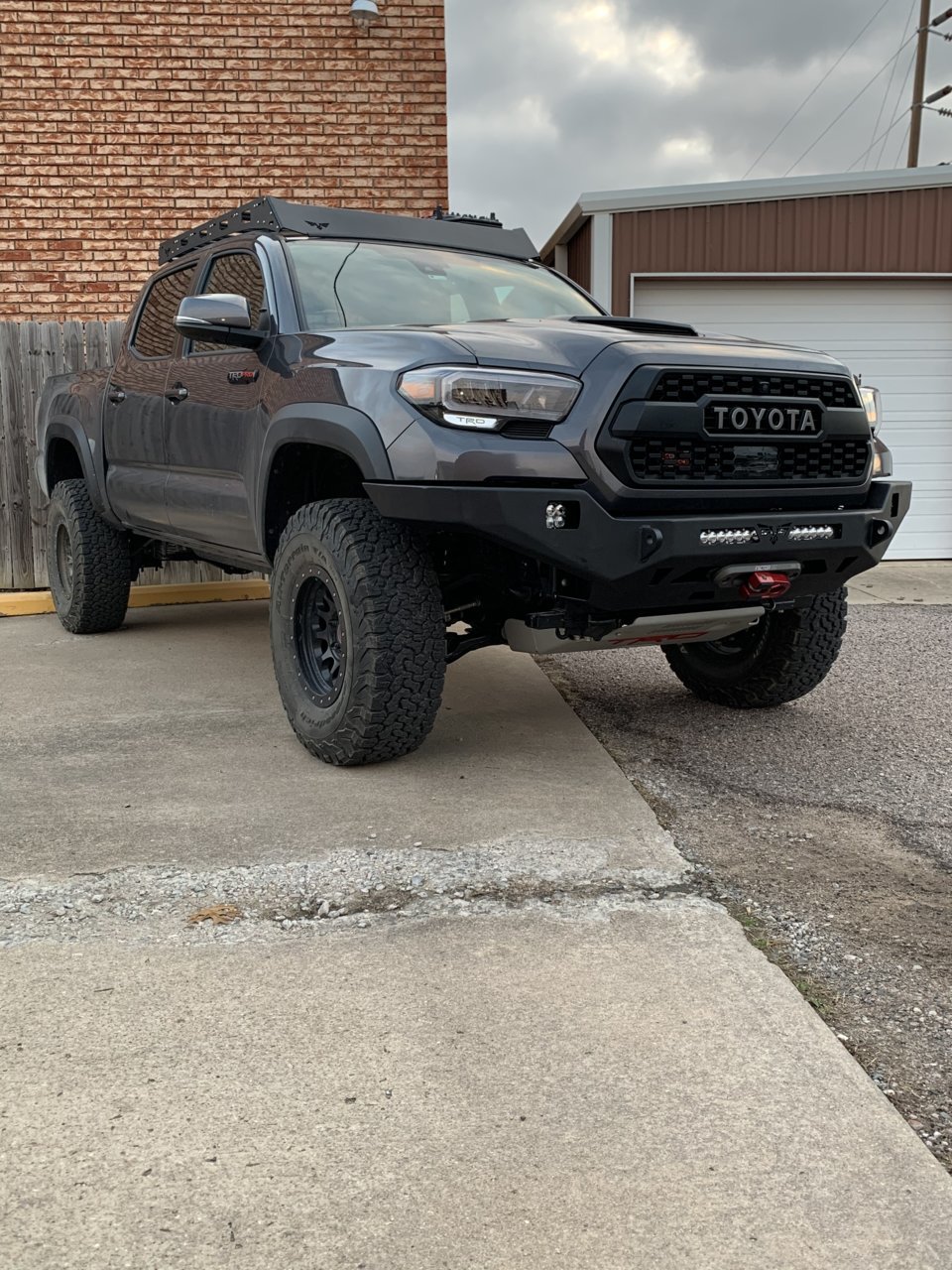

    Lol, I could see that. I'm currently running squadron driving combos in my fog light position and a 20" S8 spot in the bumper. The ditch lights (S1 wide cornering) would be a new addition. I'm trying to avoid a 40" roof rack light, as I don't run out in the open that much. We'll see where I'm lacking light as I get these all dialed in.
