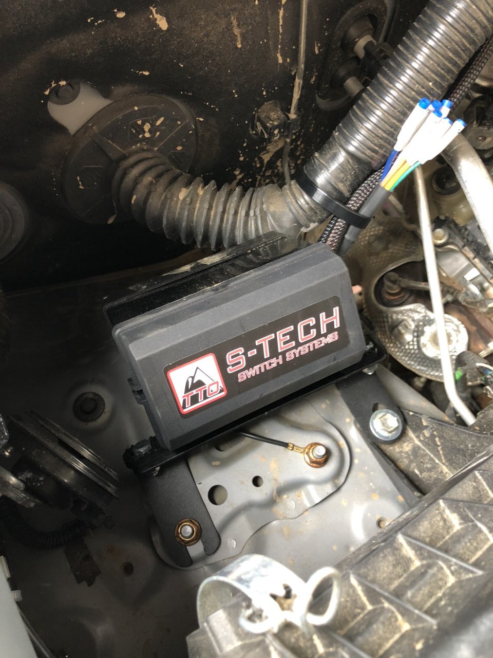

    I actually found a slick spot where the bracket that comes with the switch box bolts up to our taco's without any drilling. You just need two nuts that fit the existing, un-used studs that are behind the air intake box. I simply bent the bracket arms a little, and bolted it all up. The wiring runs cleaning around the back of the engine bay. I ran out of light and haven't ran the switch panel wire through the firewall yet. Here is the mounting location I found...

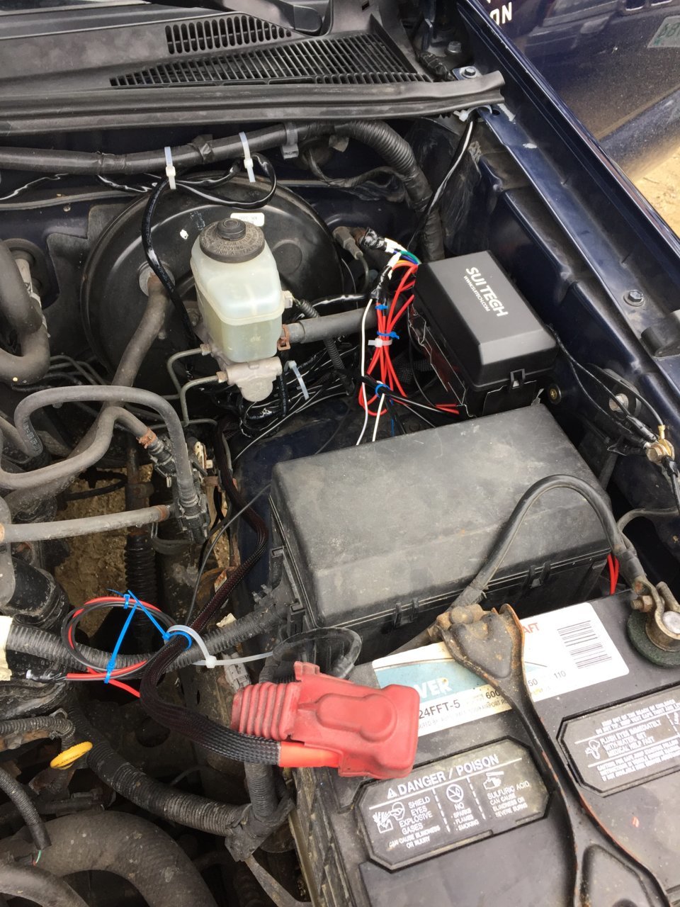

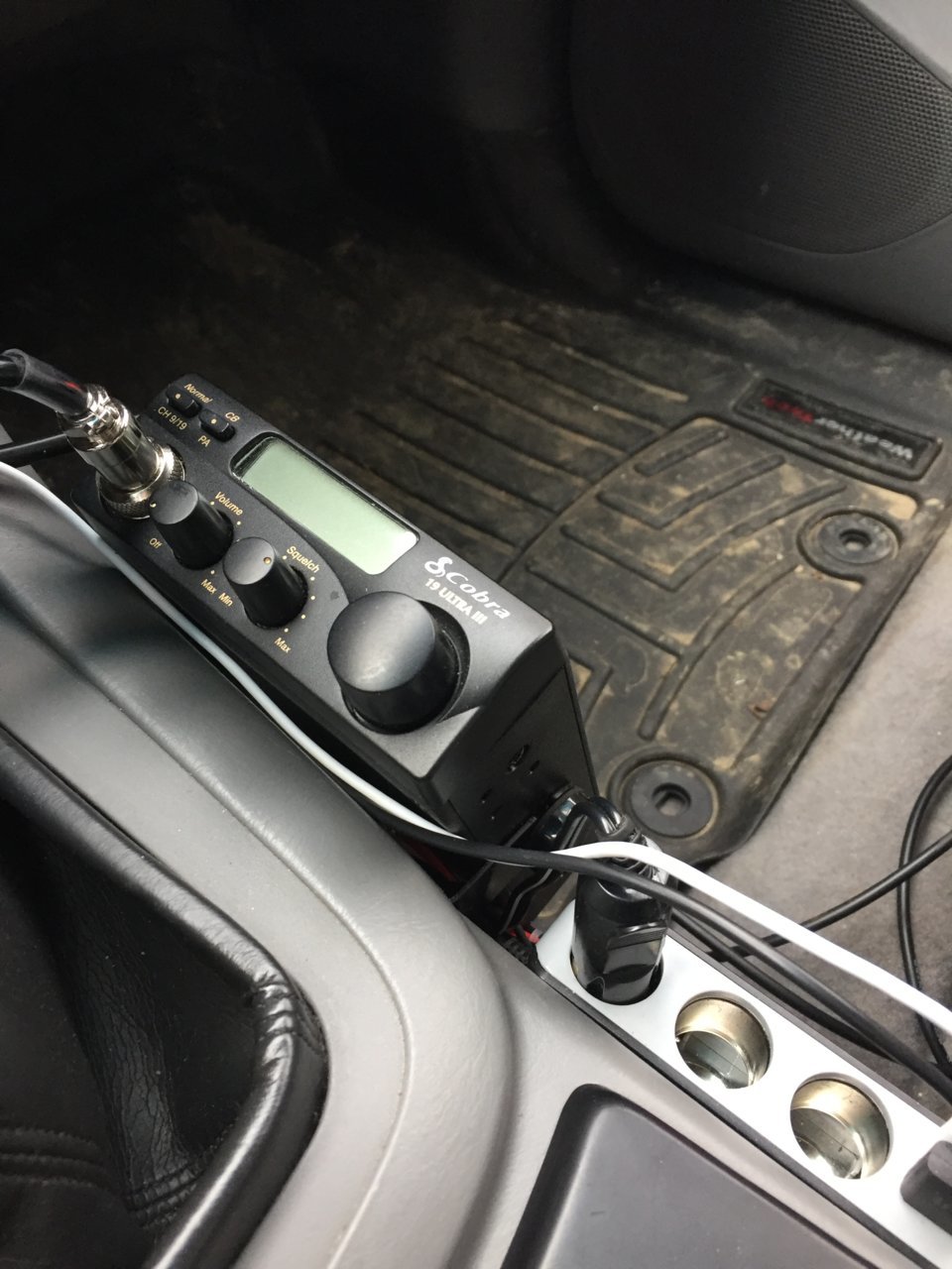

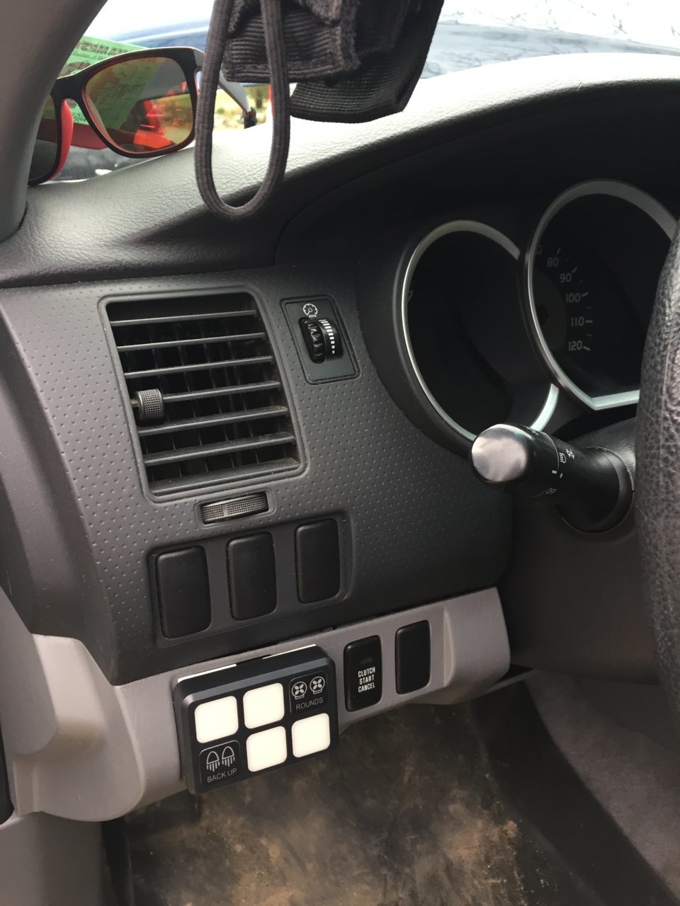

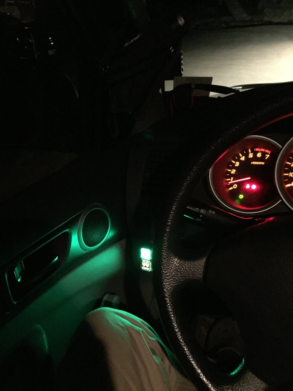

    Installed my Amazon knock off switch panel today...here are some pictures, everything works as it should, but I don't think Ive ever done so much wiring in a day...took me a lot longer than I anticipated. I wired the ACC wire into a 12v plug that I have my CB wired into...because I didn't think that taking a fuse out the panel, wrapping some exposed wire around it and shoving the whole thing back into the fuse slot seemed like the best idea... The switch panel lights up green...which is a bummer because It looked like red online, and the green clashes with my red and white gauges and interior but ehh Ill get over it. totally happy otherwise... and being the knock off version I guess we shall see how long it holds...IMG_4292-1.jpg

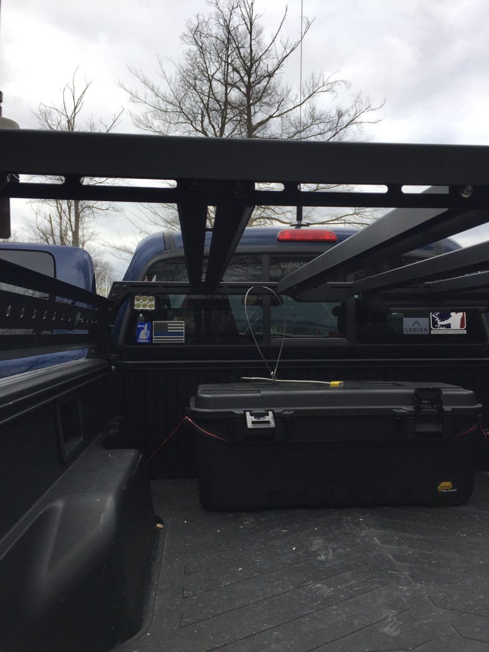

    Installed a bed light while I was at it...

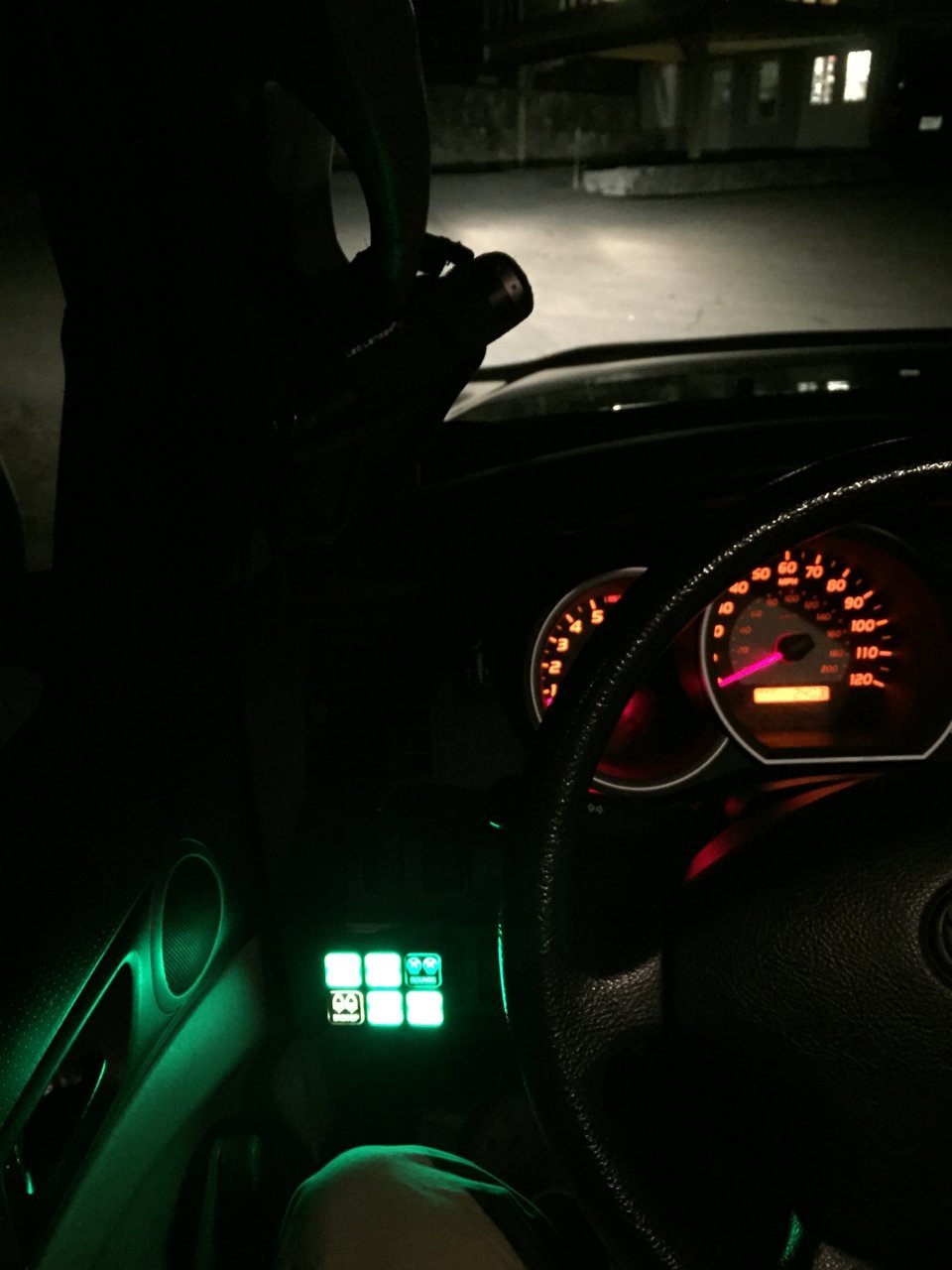

    downside...green switch light is really fucking bright at night...need to cover up unused switches with stickers...pretty annoying
