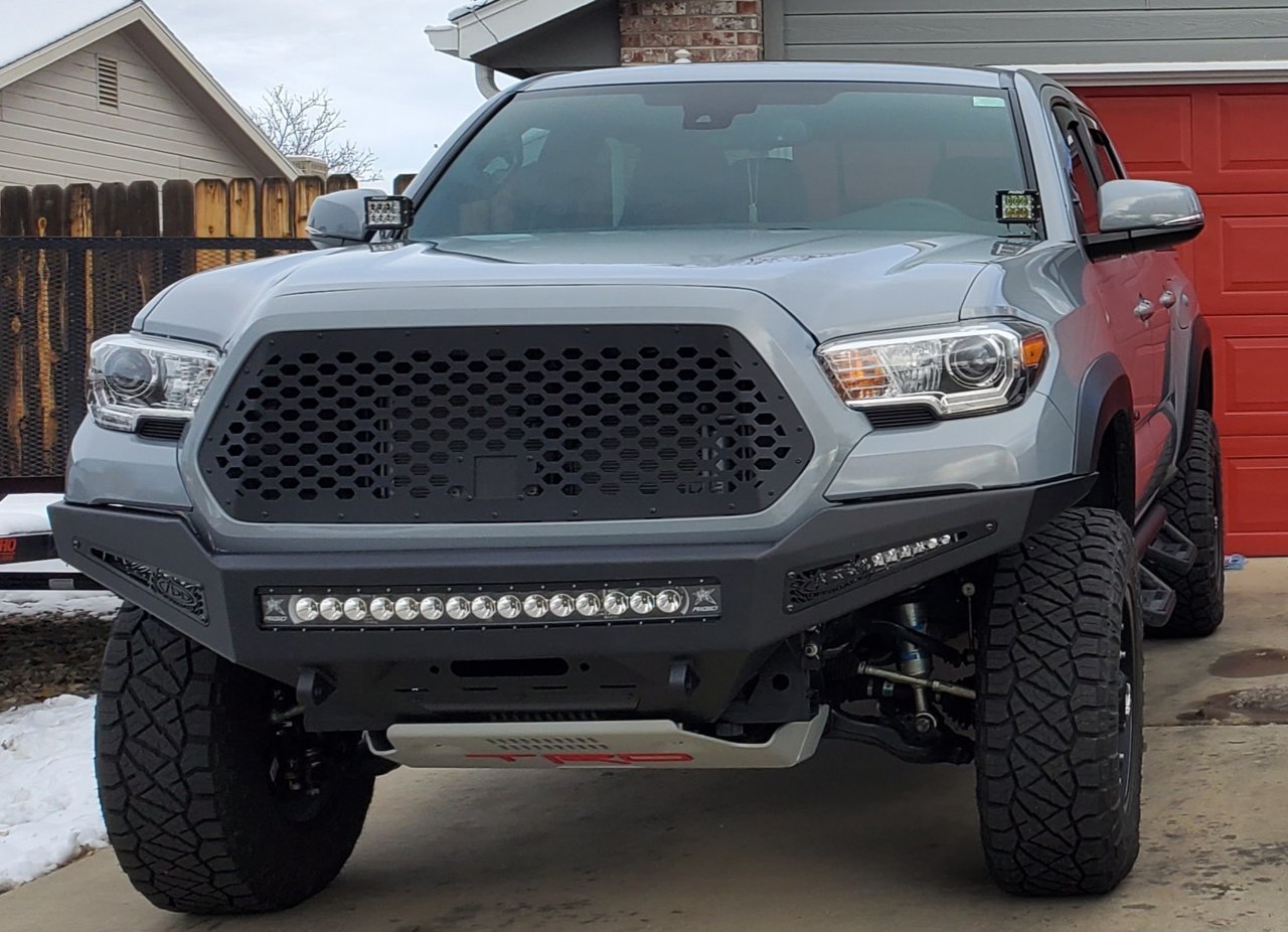

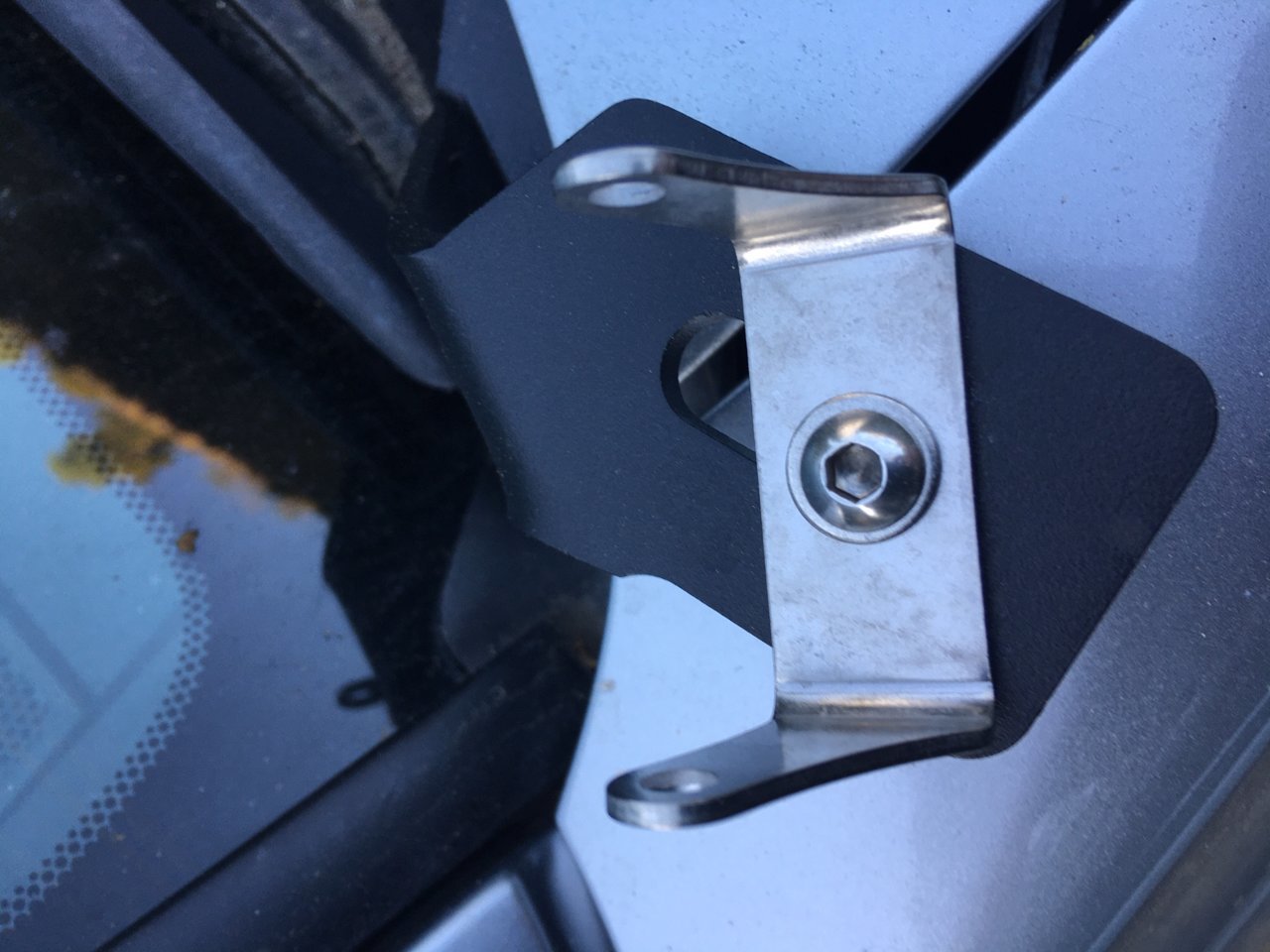

    I went with the Rago Low Pro Ditch Light Brackets. The photo from Melissa is confusing because it shows the non-low profile bracket (with the "R" logo).
    The Low Pro are very low profile and clean, without the "R" logo. They are also stainless steel, have a slotted mount (for out-of-view positioning of the light bracket), and handy zip tie slots for a tidy installation. Well worth the added cost IMO compared to the competitors.
    Top view:

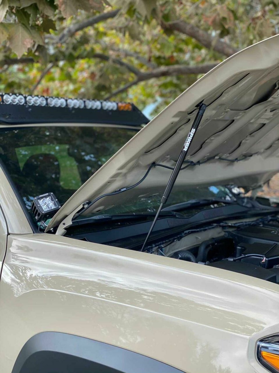

    You're not going to have a ton of extra room with that particular combo, Squadrons are long in the back. Here's some pics of the clearance with the stock hood open position:

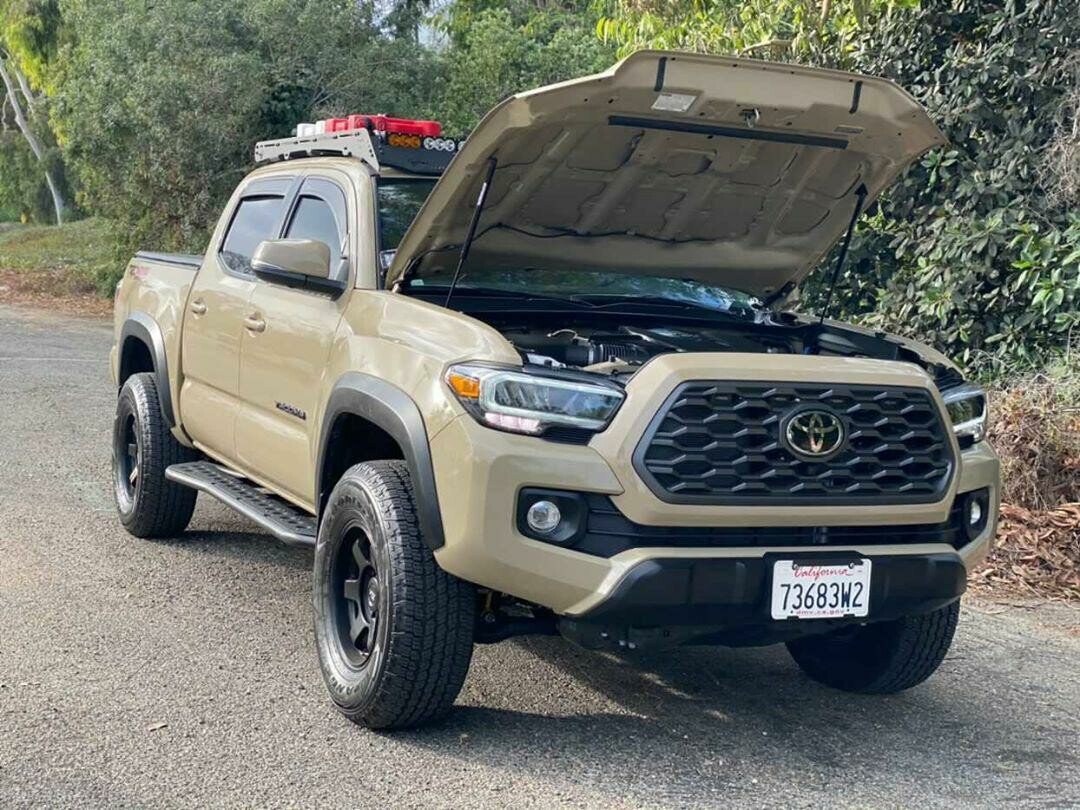

    Spiker hood struts allow you to choose whatever hood height you want, between stock and up to 8" higher. So you can use the same kit for any height (as opposed to having to buy different kits for different heights) - just set up your ditch lights, raise the hood to just below where the ditch lights contact the windshield, and set up the struts to that height.
    Here is an install we did just last week for a customer - his ditch lights limited the height to 4" above stock, so that's where we set it at:
