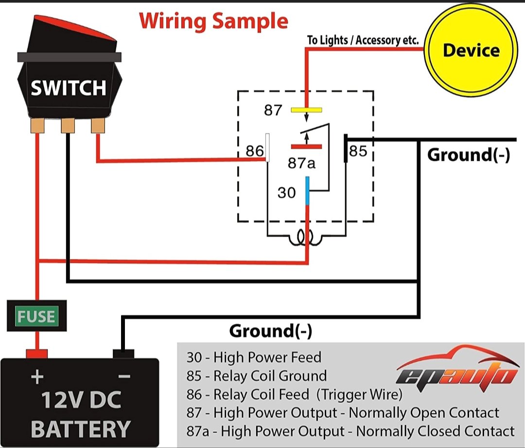

    Hi everyone.
    I’m installing a Baja design ditch lights that I bough fro Rago fabrication. The thing is that they came with a relay and the switch only has 2 probes (grown and power or Black and red)and I want to connect it to a ch4x4 switch that has 4 wires. I tried white the switch that Rago fabrication send it and it works, but I have no idea how to make it work with the ch4x4 one. Anybody has an idea how to connect this? Thanks

    Welcome to TW.
    CH4x4 wiring diagram:
    Red 1 goes to your relay's 86 pin.
    Green comes from a power source somewhere in the cab.
    Black is ground. Easily found, I used a bolt below the fuse panel.
    Red 2 is optional. I used a multimeter to find a random wire that got 12V whenever the headlights turned on.
