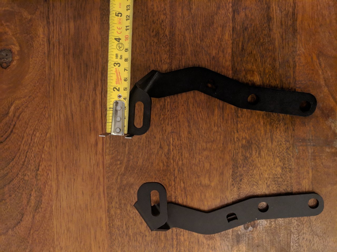

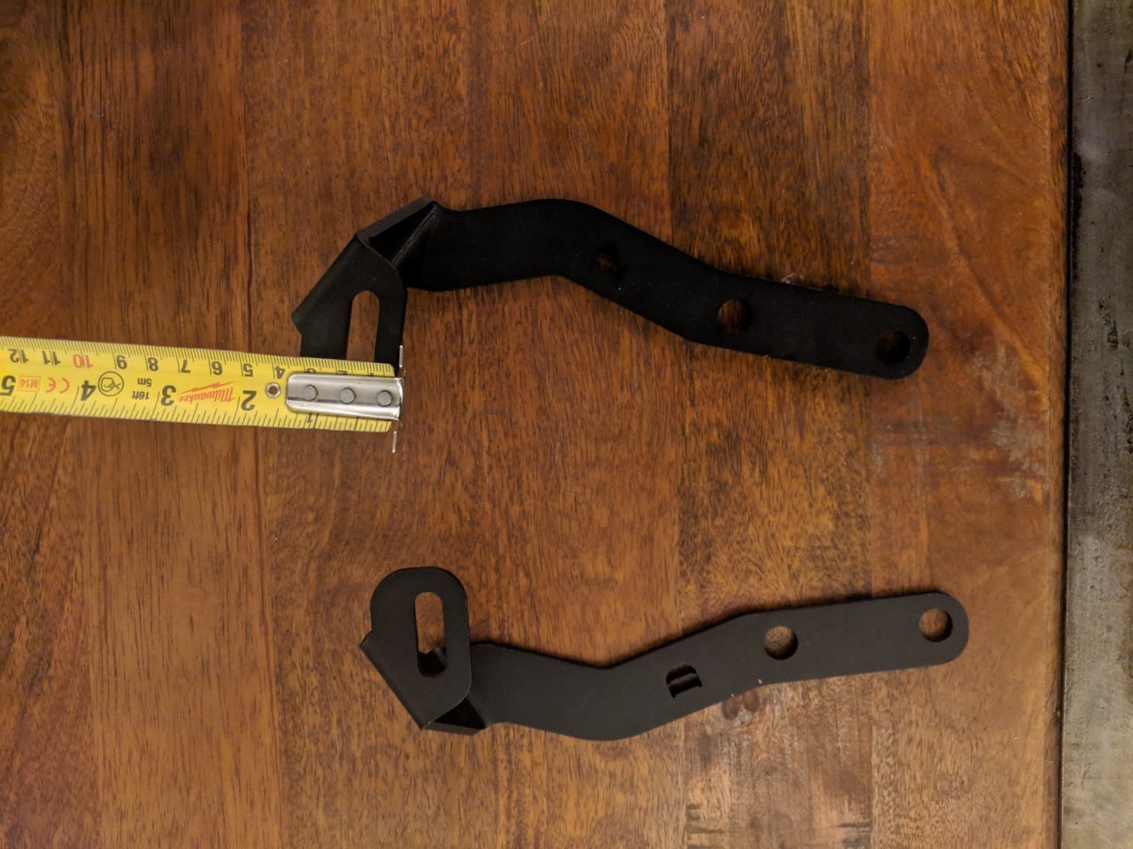

    These are CBI's brackets I believe.
    92se-r[QUOTED][OP] likes this.

    The mounting surface is 1 X 1.5" (the CBI brackets pictured above look like they have about 1/3 to 1/2" more meat in each direction). I had to use a large washer to provide a mounting surface for the antenna's NMO mount; without the washer, there isn't much for the NMO gasket to seal against.
