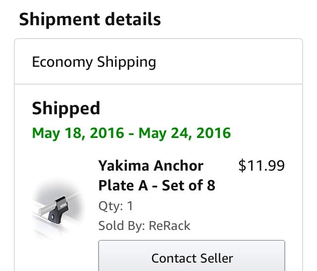

    where do I find the hardware to mount the foot to the track? I have the tracks and an older set of Thule towers and bars but I need the nuts and bolts to connect them to the track. Can anyone point me in the right direction? Thanks
    To be clear I have the Rhino-Rack Ditch Tracks and the Thule Tower and bars. I want to attach the thule to the rhinorack

  15. Jun 12, 2017 at 6:25 PM

    Why can't I seem to find them? Maybe I don't know what I'm looking for..lol

    I'll go look in my purchase history. Stand by.

    I'm not 100% sure but I think these will work with both Yakima and Thule tracks. Hopefully someone will chime in. I used these to install Rhino Racks on my Yakima tracks that came on my snugtop.

    Okay Thanks. I am looking to attach Thule Towers to the Rhino Rack Ditch Mounted Track Like this Post #9 or #10 in this thread

    Got it. You literally have the exact opposite problem that I did.
    The part numbers I gave you should work great. The Inserts for the Rhino Rails are just a hair wider than the Yakima ones. If you have these, they'll work in Yakima OR Rhino rails.
