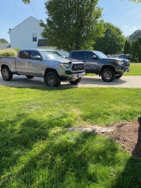

    Two 3rd gen dclb and dcsb, both identical except the perch setting. The dcsb my son's is in the 5th. Both have ECGS clam shell bushing and 1/4 shim for the lean, 1 inch block. Both run the same TRD pro SEMA wheels and tires. No difference in ride, in fact my son's may ride better as he just upgraded to the me Toyo open country at2 to the at3. I think everyone thinks their trucks ride like ass after the life is they mostly run E rated tires. Hope this helps.itsvery hardtop tell the difference in the front height. I like a little take on my long bed.19393.jpg 19393.jpg

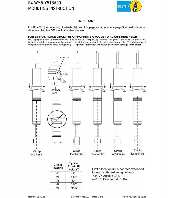

    The 5100's up front only give you a maximum of 2" lift on setting #5. It is not recommended to go higher than #4 on Long Box 4x4, nor the Access Cab 4x4.(As per below).
    I would do the 5100 front lift and see how it sits before you remove the rear blocks. Chances are it will be too high in the rear and won't look level. If "Level" is what your looking for.
    Quite a few members on here only use the 5100's up front to level the truck with OEM in the back.
