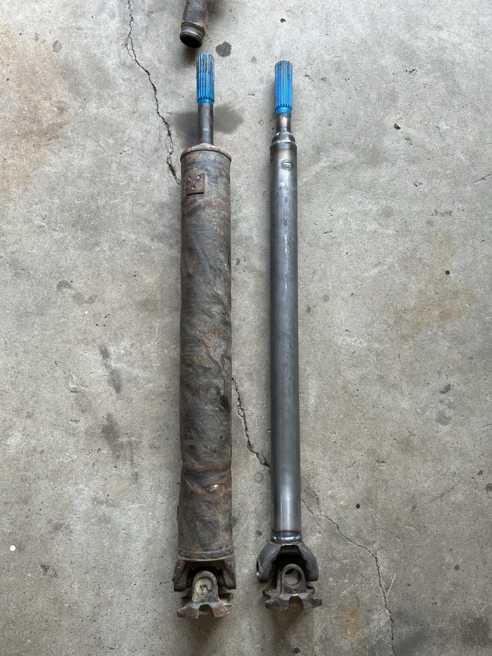

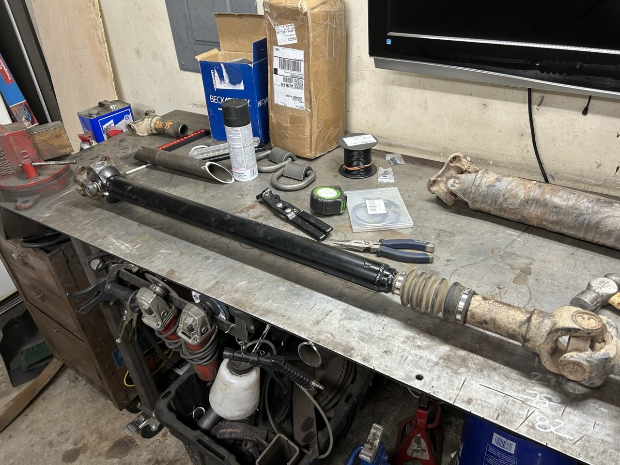

    I created my own driveshaft for off road use and wanted to document it in case anyone else wants to attempt it. I got the idea from Wide Open Design but wanted something a bit cheaper. Since I had an extra driveshaft to cut up, I'm only ~$150 into this.
    https://www.wideopendesign.com/1350-driveshaft-kit

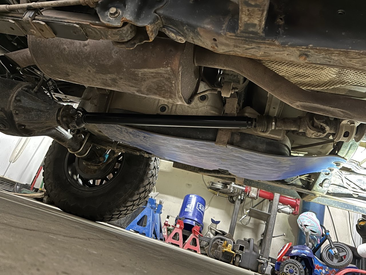

    The idea is to leave the carrier bearing/front half of driveshaft on the truck and only swap the rear portion. Undo four bolts at the rear axle and slide the driveshaft out of the slip yoke.

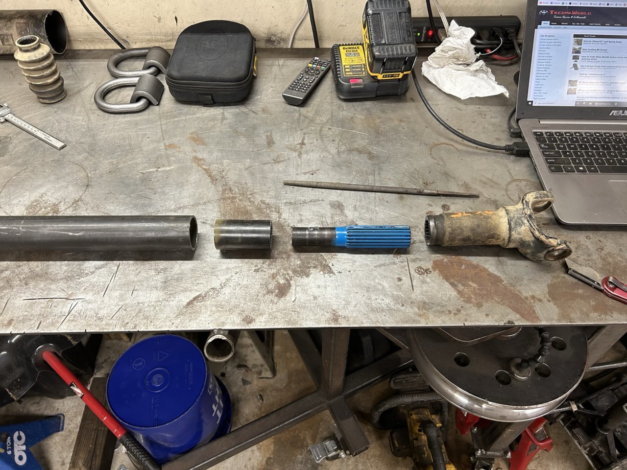

    If you want to cut up an existing driveshaft, you'll need the following:
    • Spicer 2-28-2777
    • 3' of 2" x .120 DOM tube
    • 3" of 1.75" x 0.313" DOM
    • 1330 U joint (or reuse existing one)
    If you want to create it from scratch, you'll need the following:
    • Spicer 2-28-2777
    • 1330 U Joint

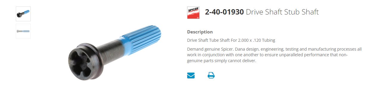

    • Spicer 2-40-01930 (currently backordered)
    • Powertrain Industries 3302-185 (currently backordered)

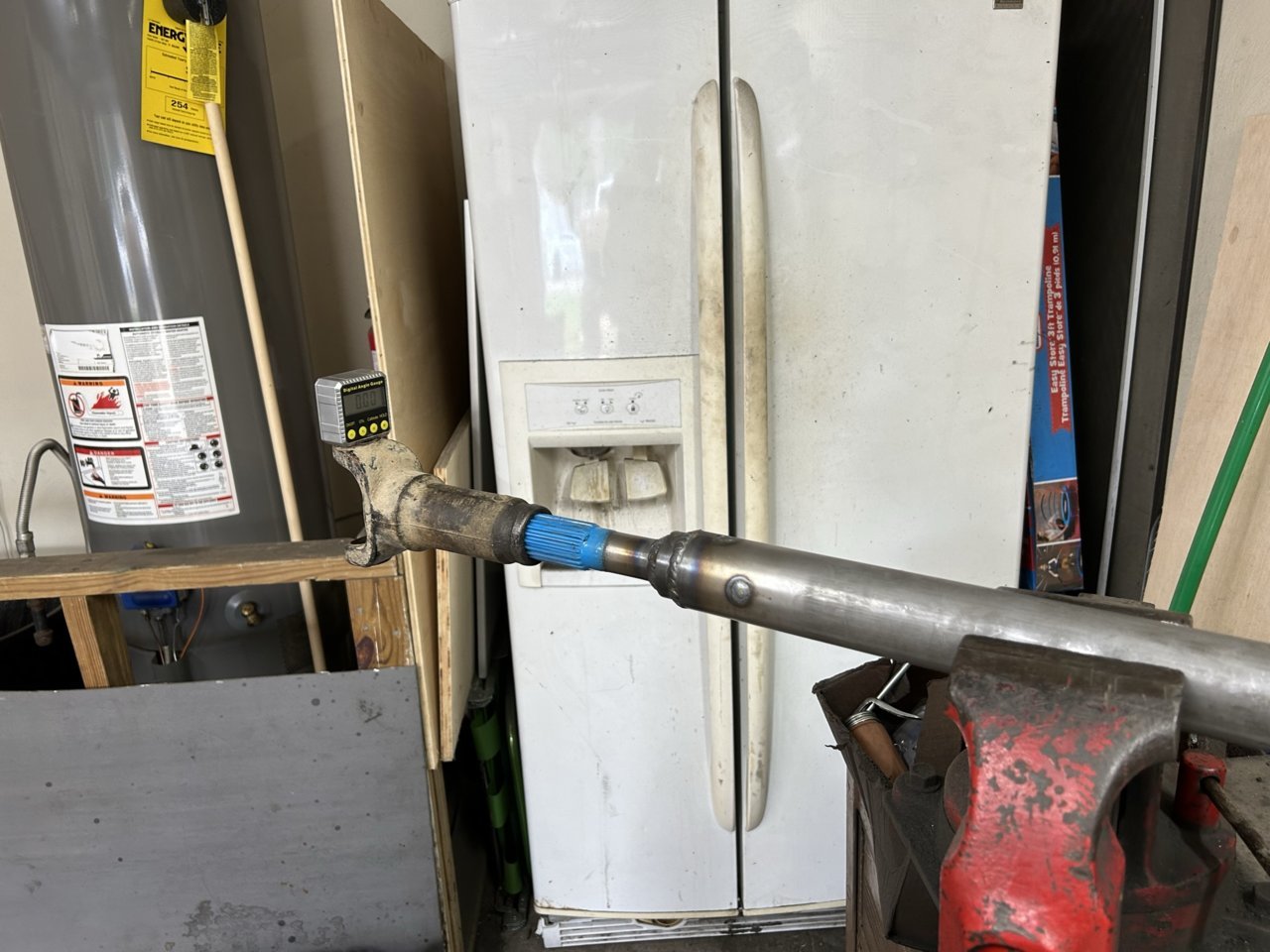

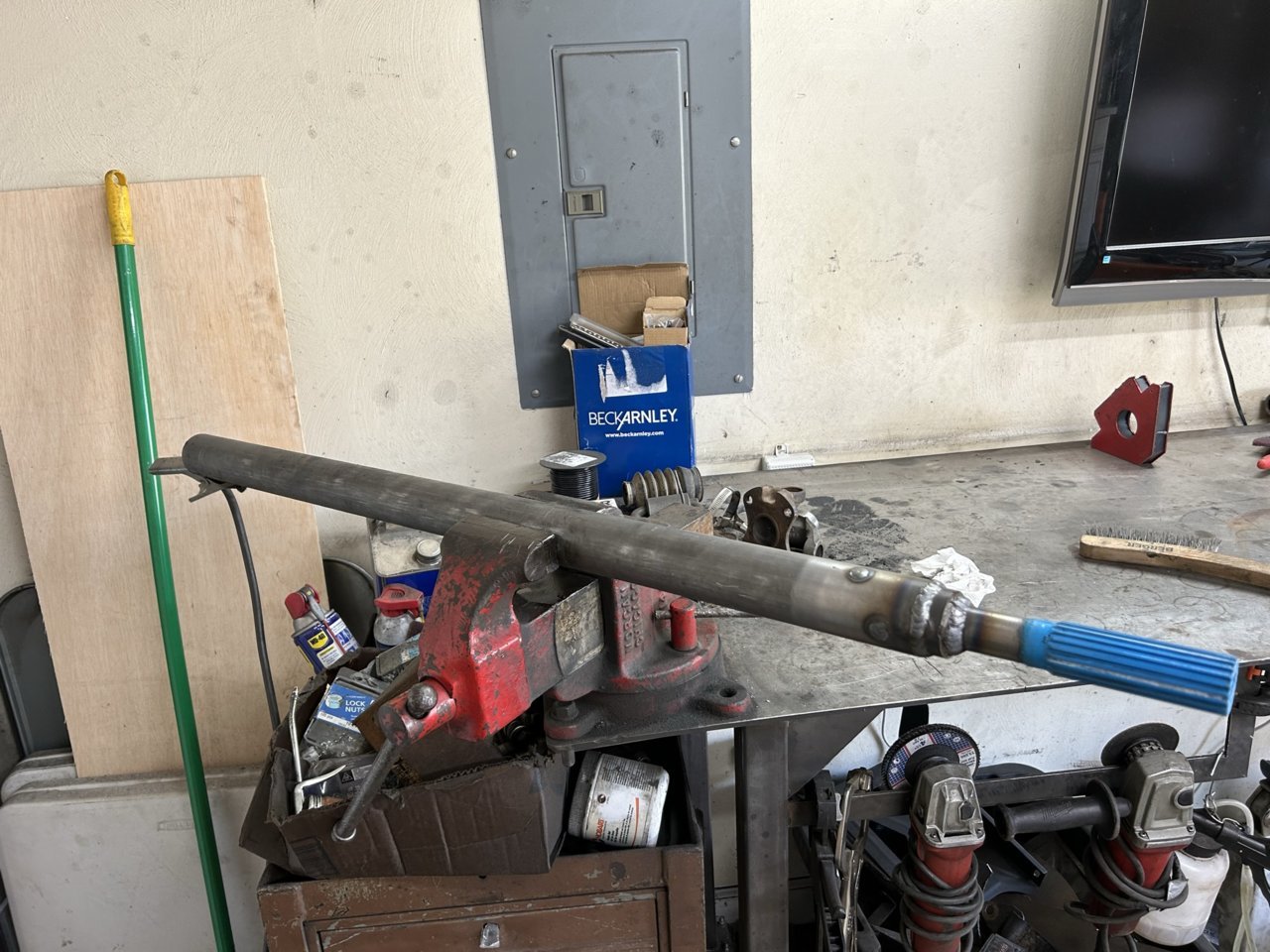

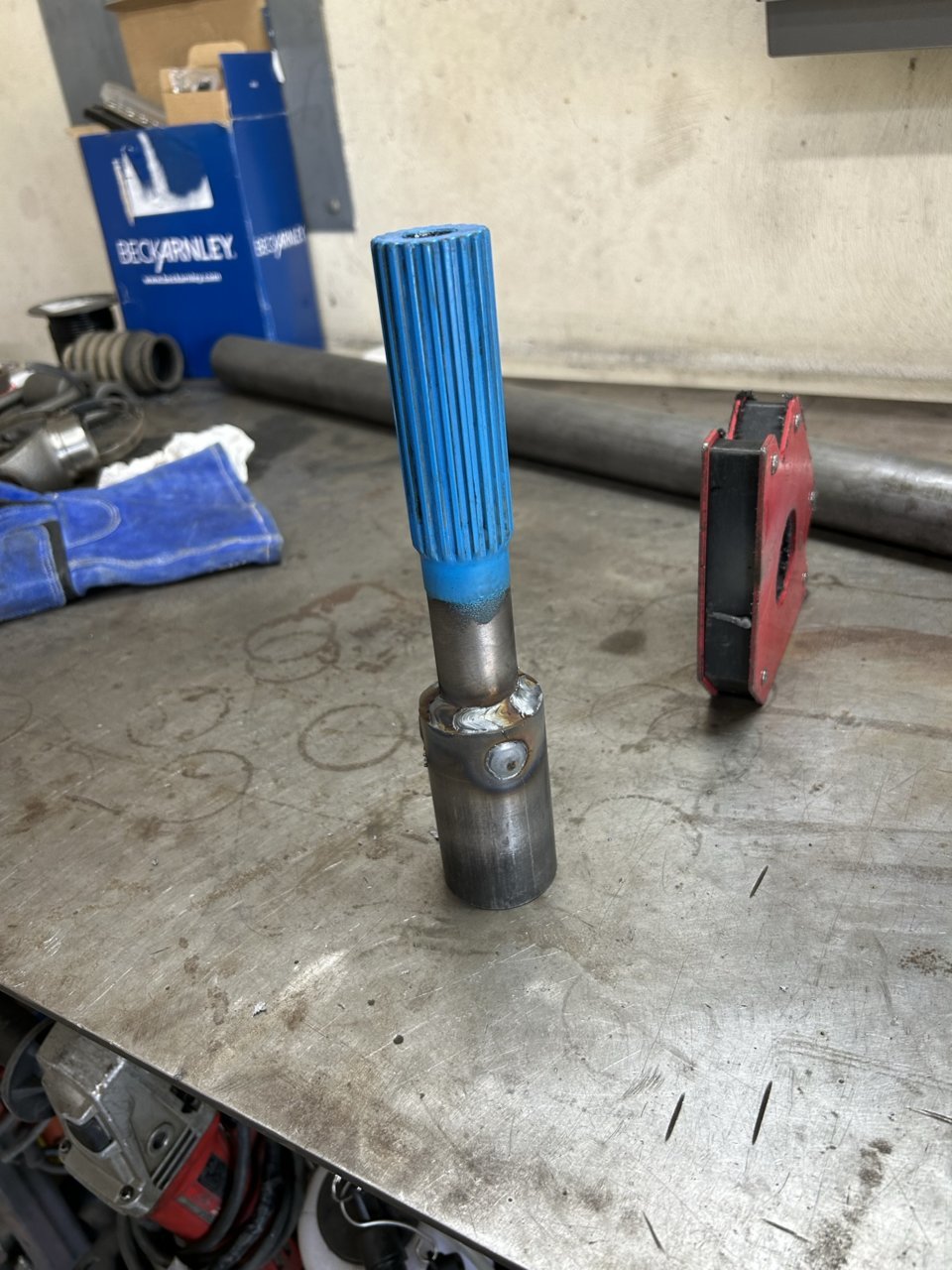

    First, I drilled three holes into the 3" section of DOM so I could add some plug welds, then welded it all together. Then did the same to the 3' section of DOM.
    I then laid the two driveshafts side by side and cut the tube to length. I don't want to give a measurement in case yours is a little different than mine, but I cut about 6" off.

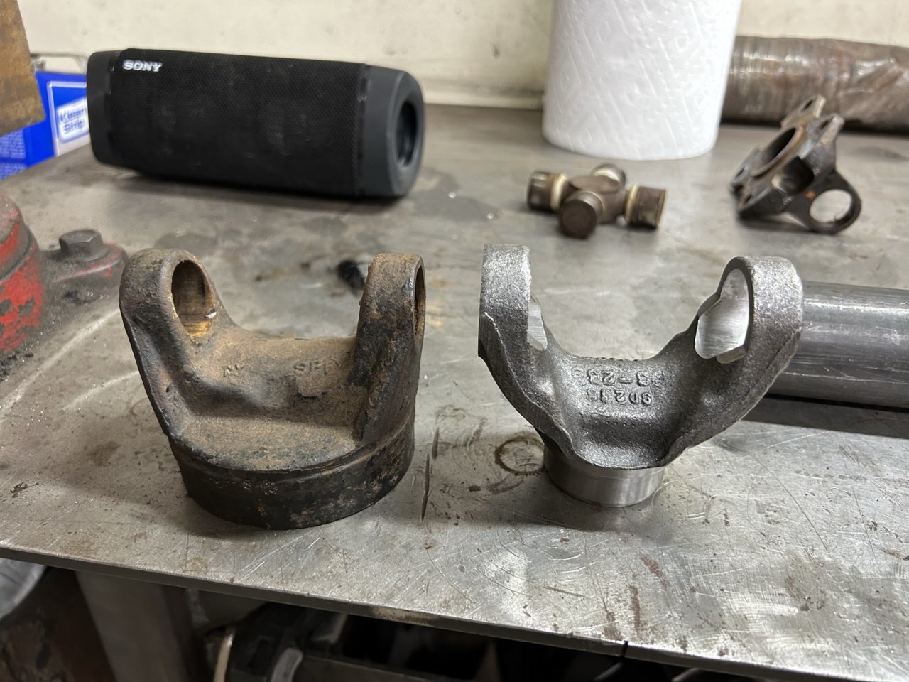

    Once it was cut, I inserted the U joint weld yoke into the other end. It's very important that the U joints on either end line up, otherwise you'll have vibrations and binding offroad. I used my digital angle finder to ensure everything matched up. This is also a good moment to point out that the splines on the slip shaft will only go into the slip yoke one way, so there's no guesswork if it's correct when installing it.
    Getting the weld yoke into the DOM was a bitch, it's truly a press fit as I was unable to hammer it in. I ended up having to grind out a little bit of the DOM and a little bit of the weld yoke, then was able to hammer it in.
    And that's it! Then just paint and reassemble everything. Its maiden voyage is this weekend so I will report back on strength and drivability without it being balanced.

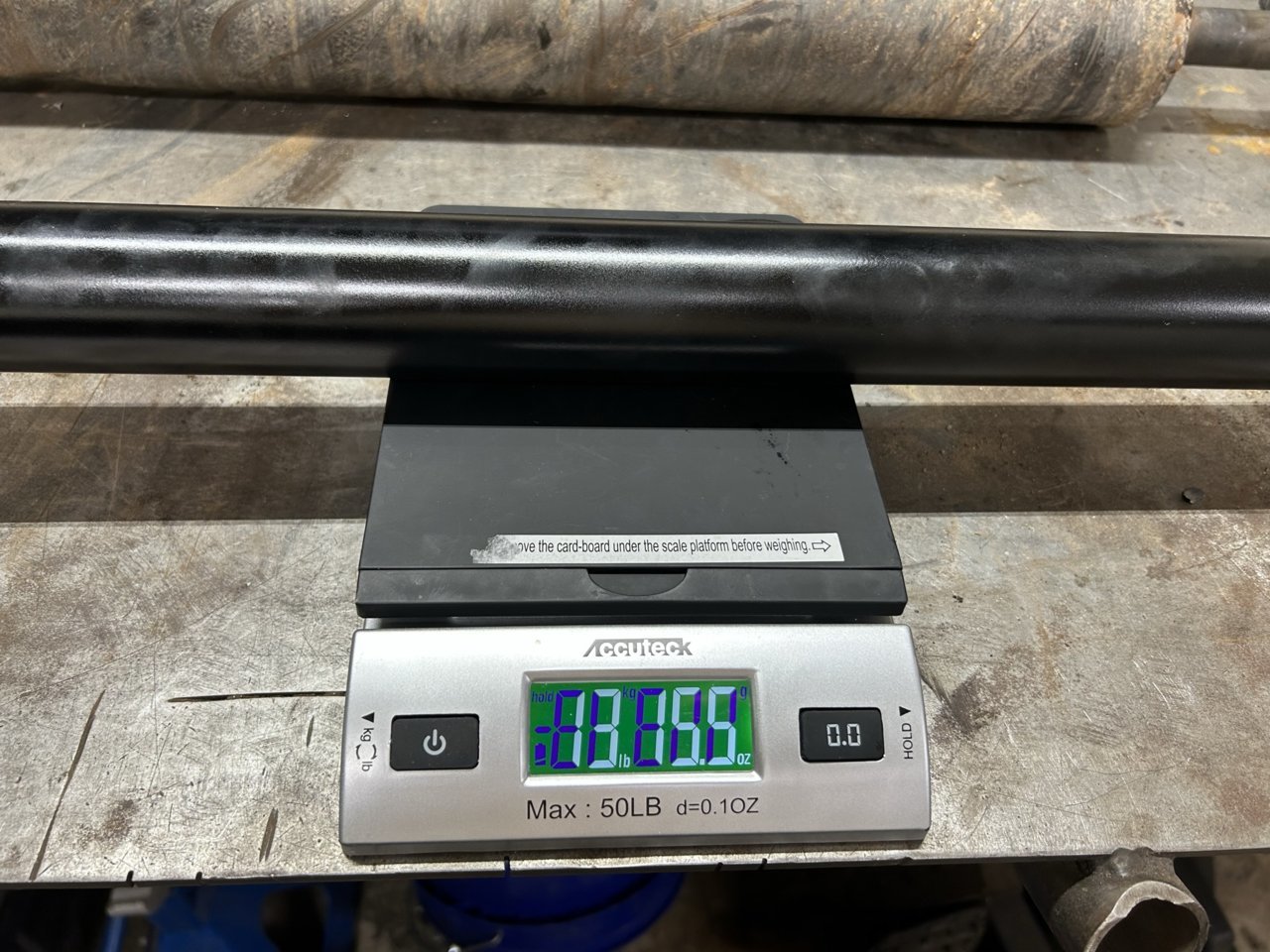

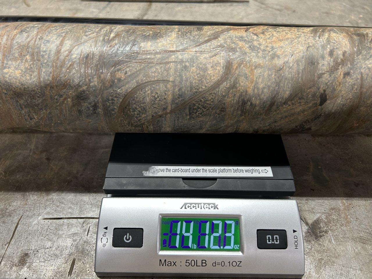

    The DIWhy driveshaft ended up being 3/4 pounds lighter than the factory driveshaft as well.

    OEM - 3.5" x 0.065"
    WOD - 2.5" x 0.25"
    DIY - 2" x 0.120"
    The WOD is without a doubt the strongest one of the bunch but I felt it was unnecessarily overkill, plus more than I wanted to spend. I'd need their kit, plus the tube, plus some 1350 -> 1350 U joints. It would cost closer to $600. Of course I could source the Dana parts myself since all they're doing is reselling, but I didn't pursue that avenue so I'm unsure how much money I'd save doing that.
    My train of thought is that if .120 wall DOM is strong enough for rock sliders, it's strong enough for some gentle impacts on a driveshaft.

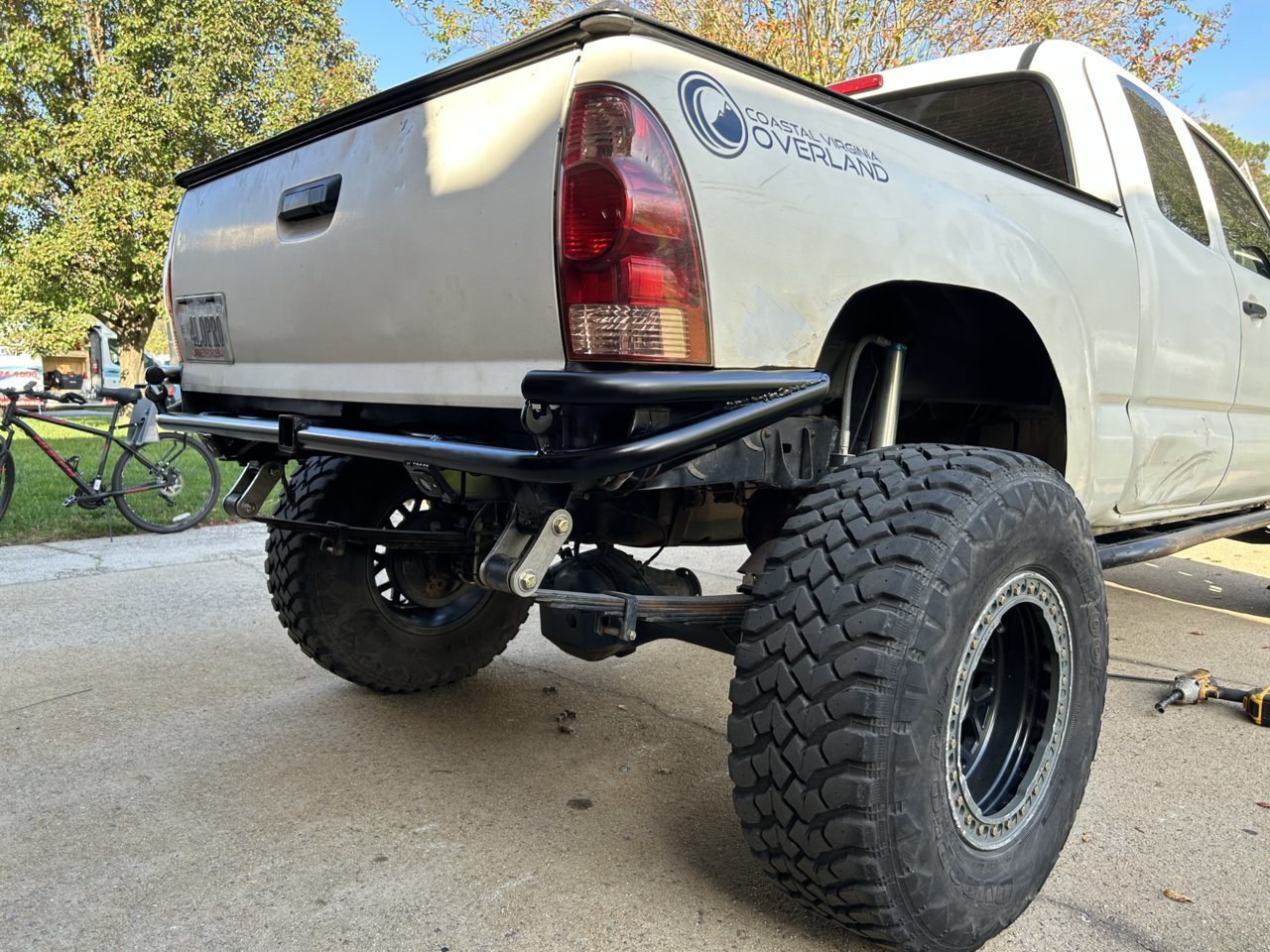

    I'm very curious to see how it does this weekend. It's my go-to spot so I've run it a dozen times which is great for comparing differences in the truck each time. Big differences for this trip is the driveshaft and the rear hanger/bumper setup.

    God those wing welds look horrendous in that pic. I promise they're not straight boogers.

    It did great! Went as high as 40 mph and no new vibes that I noticed. I had it up against a rock pretty good and did take some paint off but no dents. So far so good.
