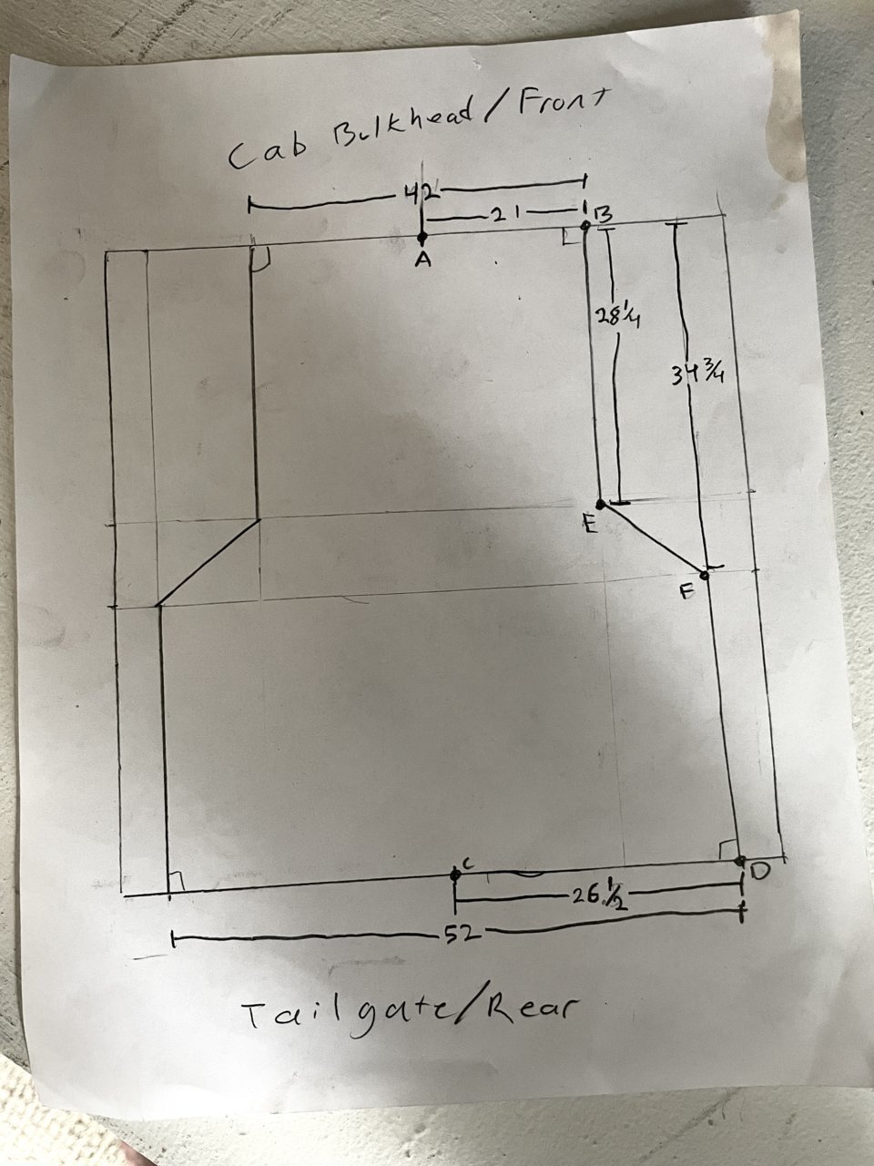

    Here is how to save $500+ building your own base plate for your bed build out/drawer system. See bottom for ”blueprints” w/ measurement and photos.
    Supplies:
    - 5’x5’ 1/2 Plywood (preferably hardwood like birch); Home Depot won’t have it look for a “lumber supply” yard in google maps
    - ruler and pencil
    - long straight edge (scrap wood works)
    - saw (I used a jig saw)
    Notes: the instructions lay out the steps for the right side of the base plate. Repeat each step identically (except on the left) as you go.
    1) Mark what side will be the Front and Rear on the wood
    2) Find and mark the center point on the front (“A”) and rear (“C”)
    3) At the FRONT of the board measure and mark 21” to the right from the center point (“B”)
    4) Measure and mark a line 28.25” at a 90° angle from Point B towards the rear. End of this line is Point E
    5) At the FRONT of the board measure and mark the point 26.5” to the right from the center point (“D”)
    6) From the REAR of the board measure and mark a line 25.25” at a 90° angle from point D towards the front. End of line is Point F
    7) Connect Point E & F
    8) Cut on the line

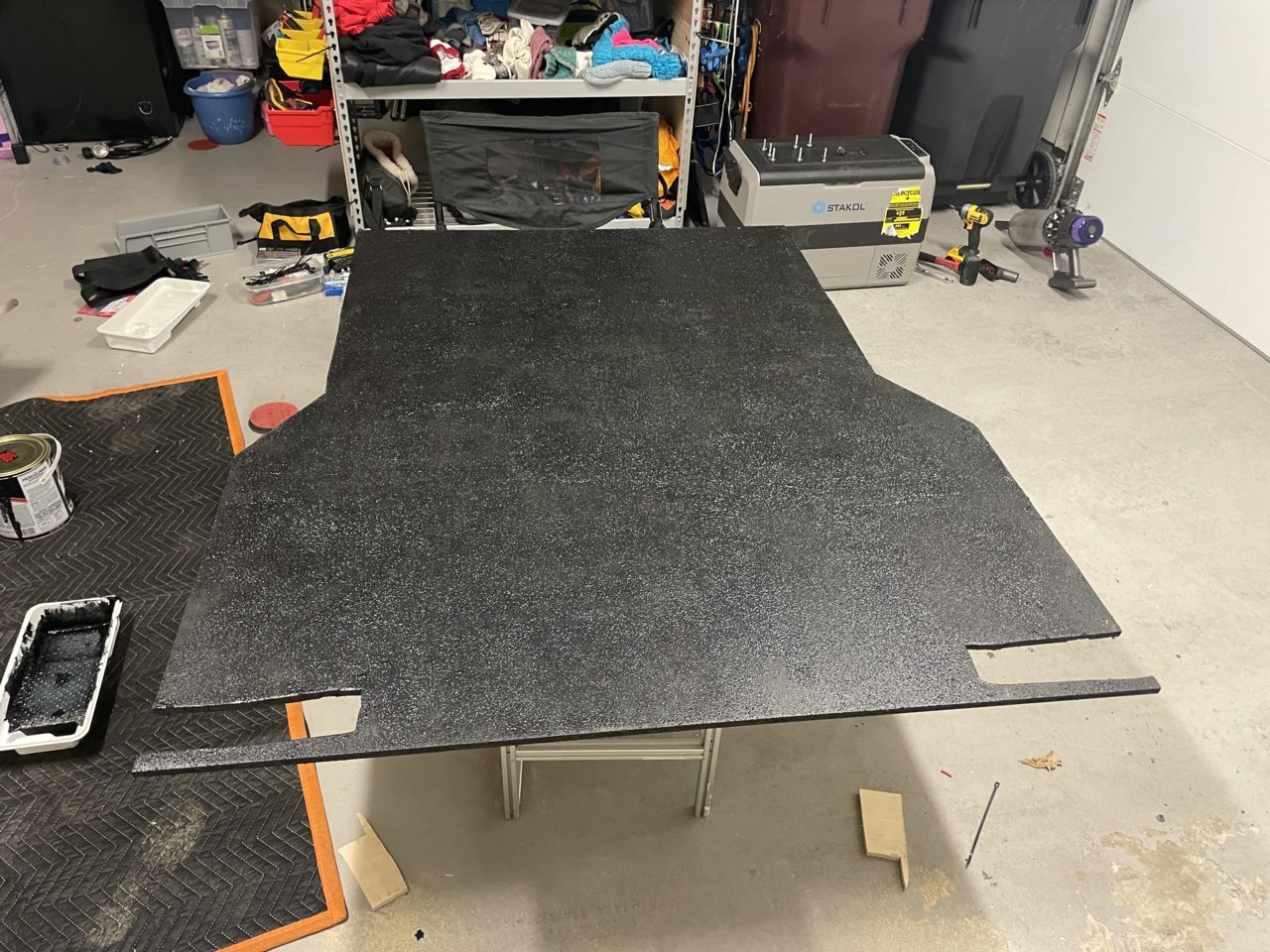

    9) OPTIONAL: If you have bed stiffeners measure, mark and cut out the rear corners so the base plate is not sitting on top of them. I eyeballed mine (and regret it) because they give an other wise clean build a shit look. I measured after and a 4” x 10” cut out would have done it.
    10) Also OPTIONAL: Stain or Bed-line the plywood. I went with a roll on bed liner (Herculiner, $30 for 1 Qt at Lower)

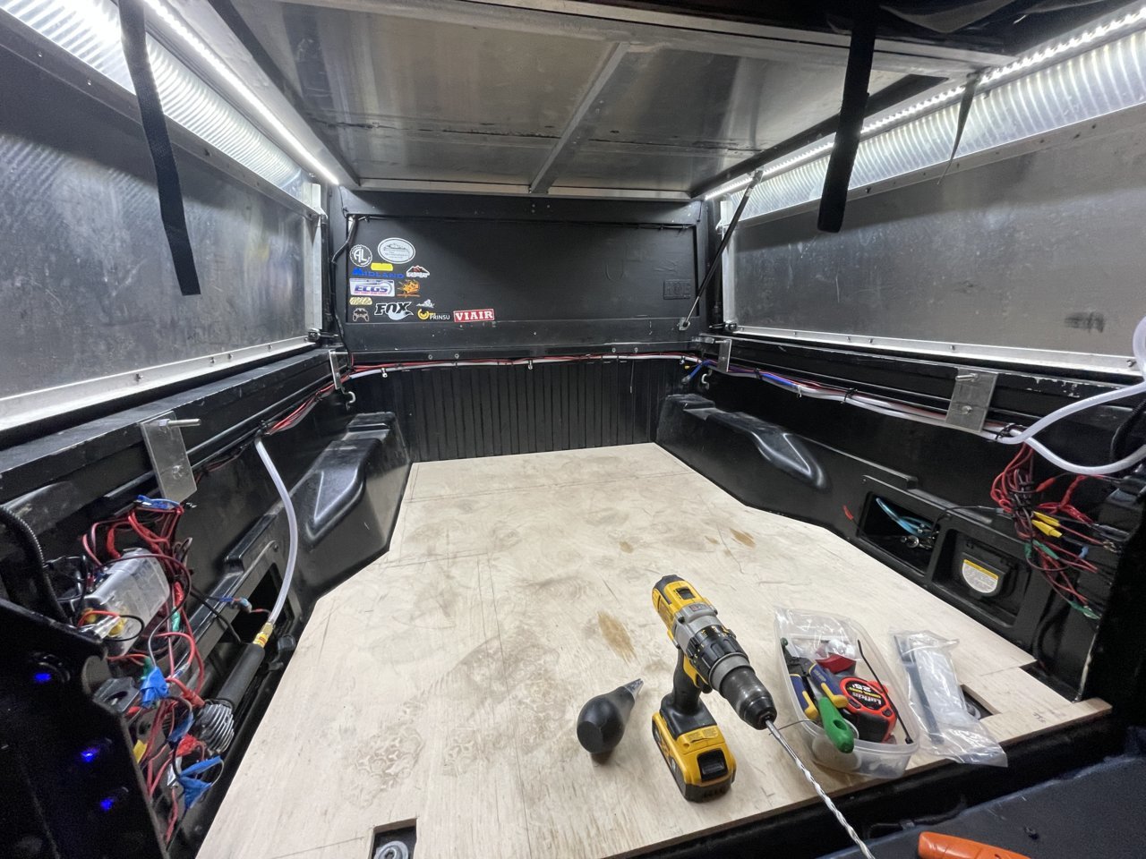

    Secure the Base Plate
    Note: good to lay out your system first, the bolt head will sit on top of the base plate so just make sure it won’t interfere with anything you want to slide in/out. I secured mine around the edge so they were out of the way; three near rear wall and two on each side near the cubbies.

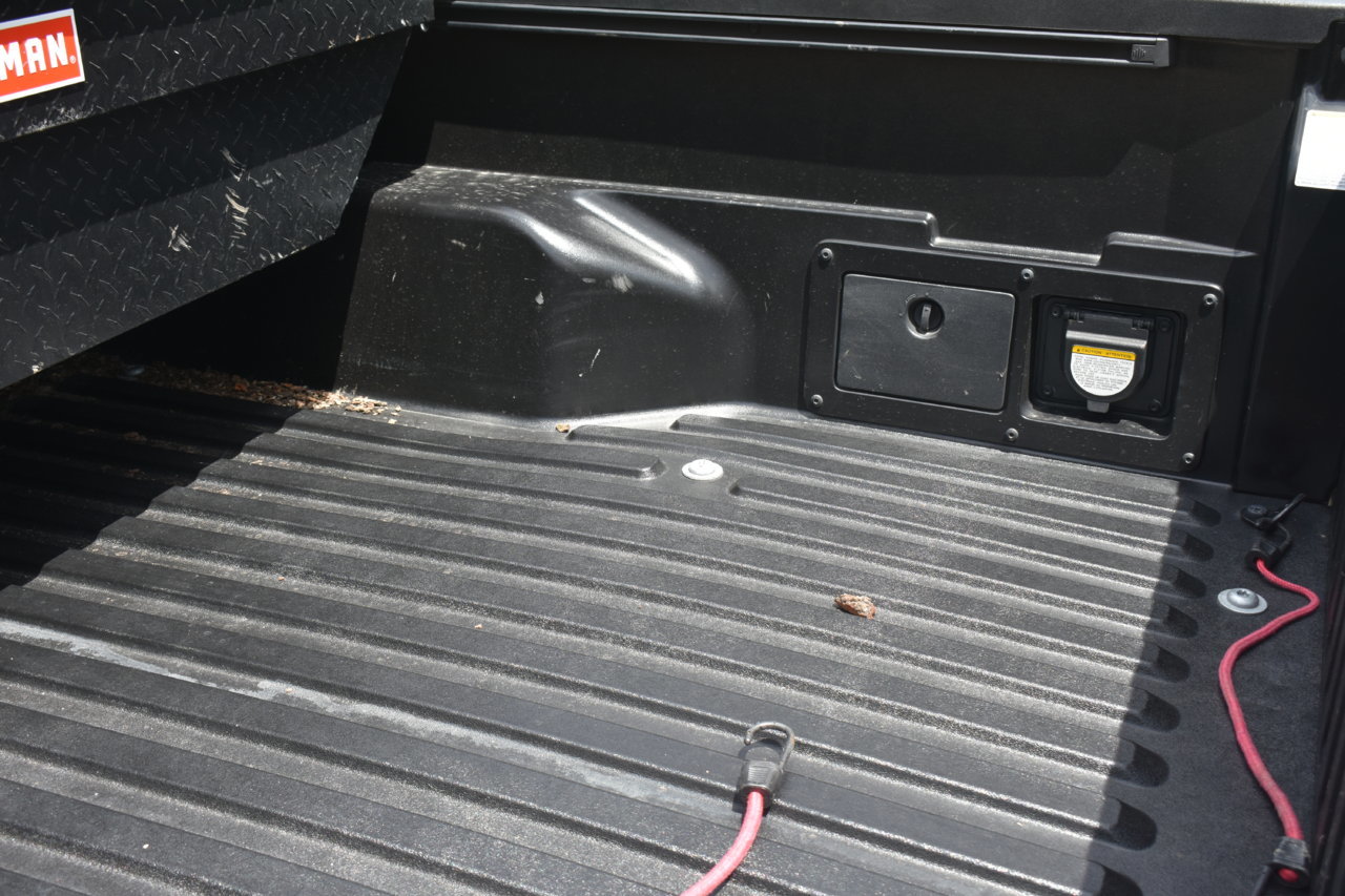

    1) Put the base plate in the bed
    2) Drill 5/16 holes where you’d like mounting bolts to go (drill though wood AND bed)
    3) Remove the base plate
    4) Re-Drill the holes in bed wife enough to accommodate 5/16 riv nut
    5) secure the riv nut with special tool or riv but hack (see YouTube link at bottom)
    6) drop the plate back in and bolt in

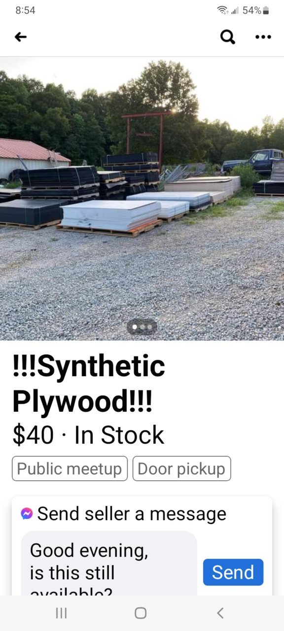

    See if you can find synthetic plywood in your area. It's waterproof. I plan on using it with some ideas I have.
    medicfung likes this.

    Sorry i was late posting it lol. But they have few color choices from 1/4 to 1in.
