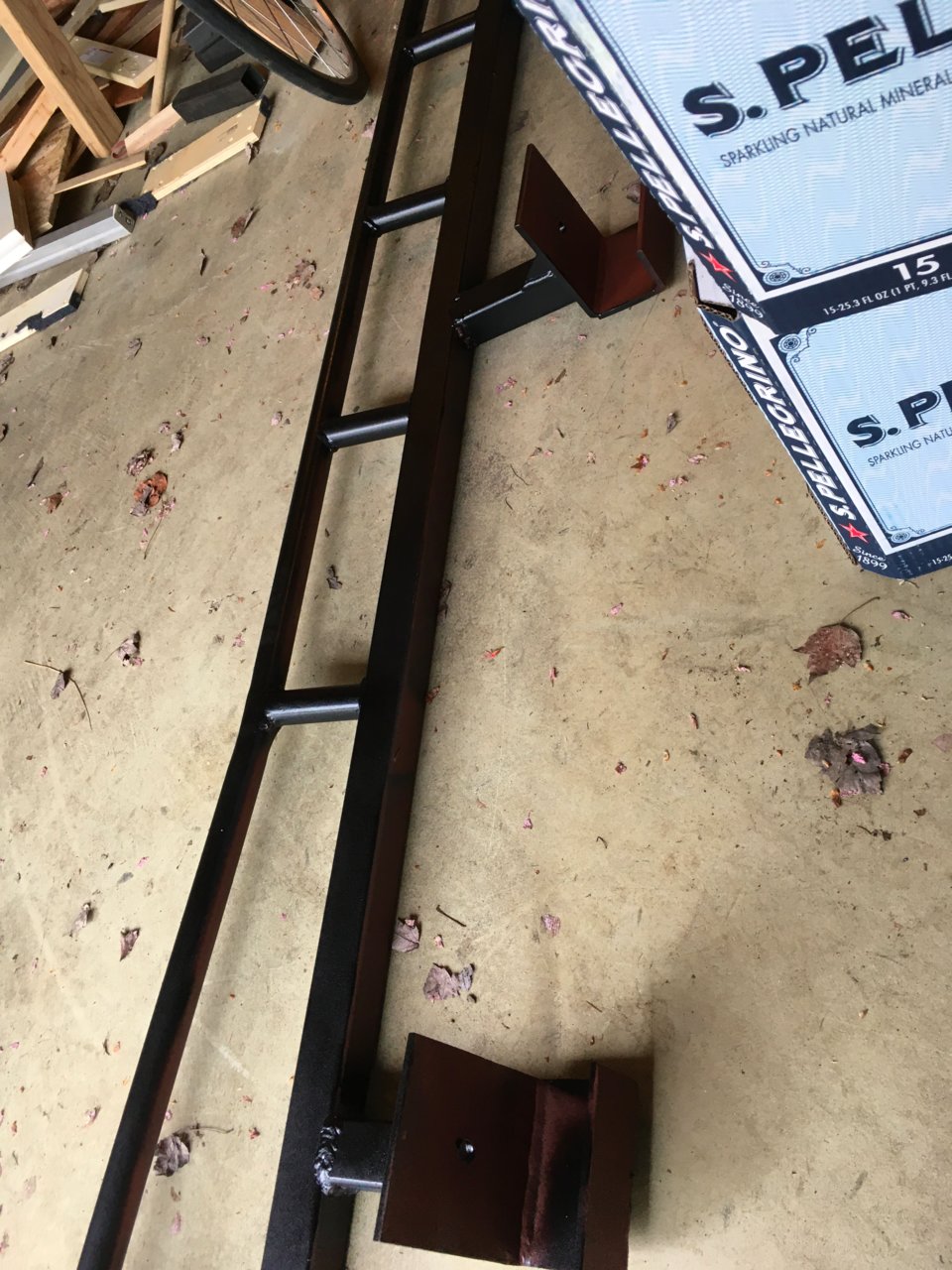

    Made a lot of progress today on the sliders. I got the driver's side all welded up, the passenger side primed and painted W/Rustoleum bedliner, and the driver's side primed. the driver's side was easier to weld (i got some of the muscle memory down) but it was a lot harder to line up. the front and middle brackets went in fine, but the rear was being a real bitch. it took me well over an hour of grinding with a dremmel and filing before i could get it to sort of fit. even now, it's not perfect but it's plenty strong. my truck was in a minor rear end collision before i bought it so that might be part of why the frame is a little wider behind the rear body mount on the driver's side. then, as it that wasn't bad enough, i couldn't get the slider to sit level, while keeping all the brackets in alignment with the main tube:annoyed::facepalm:. i think i found a good middle ground but it's still a little bit sloped. this was part of the compromise of bolt ons though... i can deal with it for now, and i can always upgrade to weld ons later if i really want. overall i'm happy that it's working out. I had to use a floor jack to get the final bracket to align right with the hole and it lifted the truck a bit off the suspension. the brackets are definitely strong, so i think i'll live if it looks a tiny bit off. the finished slider looks great though! i'll paint the other one tomorrow, then leave them to cure for a few days before touching them up. i'm still waiting on the hardware to arrive so i'd be waiting to install them anyways.

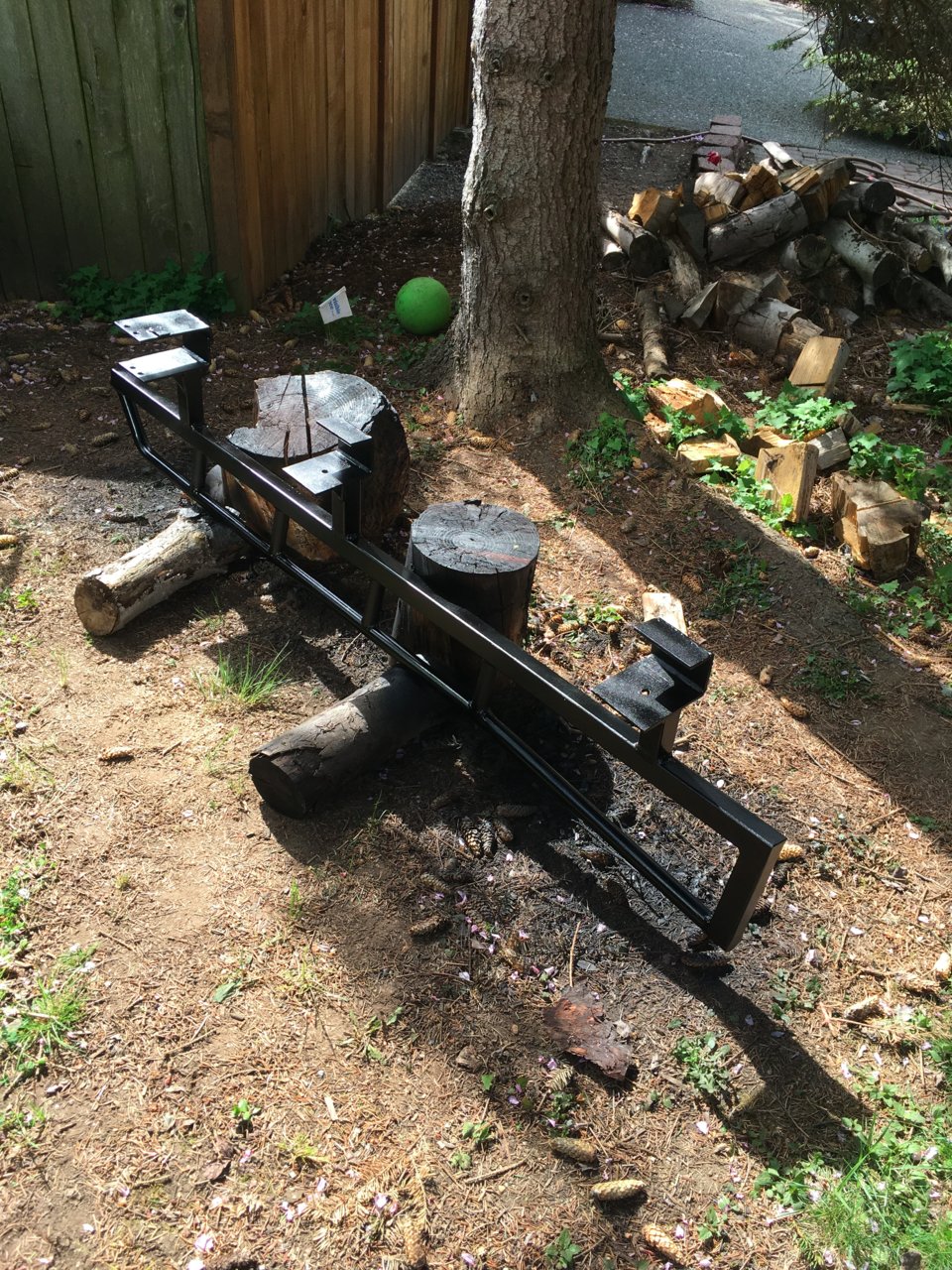

    Passenger side finish welded. i upgraded my welding table too! no longer sitting on a set of ladders. ruined a decent piece of plywood though, still functional but now it's got all sorts of burns and craters.:
    Primed up:

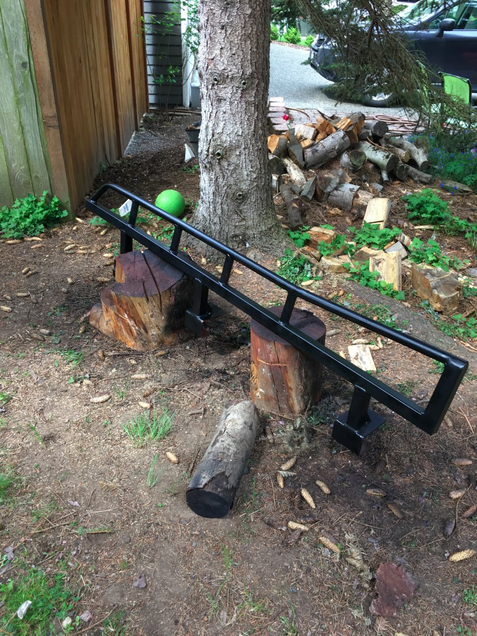

    and painted. i applied three full coats, four with primer, so it should be plenty durable. looks great!:yay:

    and the driver's side is primed! I just barely had enough primer in the can to finish it. you can see the spots where it's a bit patchy, but it should work. thankfully this isn't the final coat... although i don't entirely mind the color admittedly.
