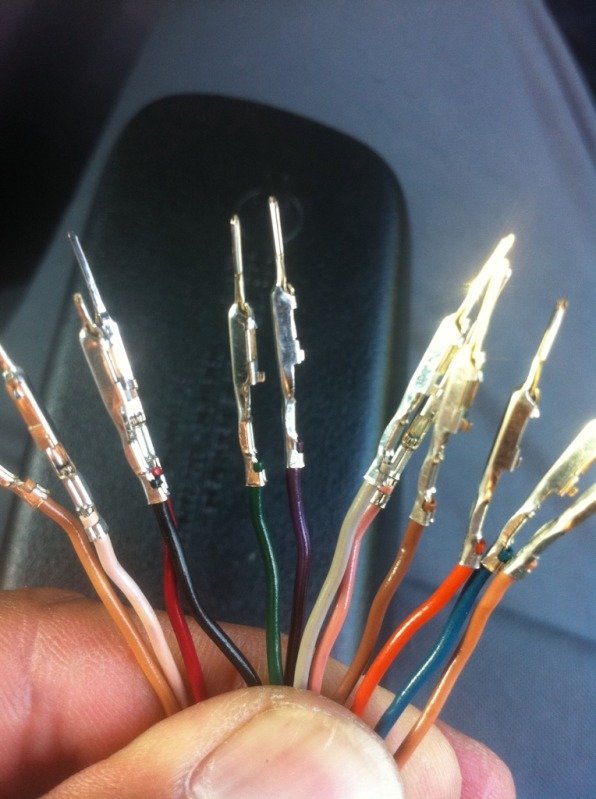

    I'm not really worried about having home link or temp. just want that basic function of using the camera on reverse.
    I couldn't fine a plug for the mirror so I've decided to just tap into the wire. My problem now is identifying which wire from the camera, goes to which wire from the mirror(hope that makes sense).
    this wires are from the mirror. different colors from what you did on your write up.

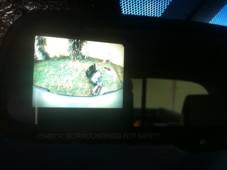

    finally got it to work. just have to get use to it looking at that screen and looking back at the same time. pretty awesome having it. :D

    ^^^Great job. I'm glad you got it all figured out and working.:thumbsup: I love mine too!:)

    thanks man. having that camera does help big time whenever reversing
