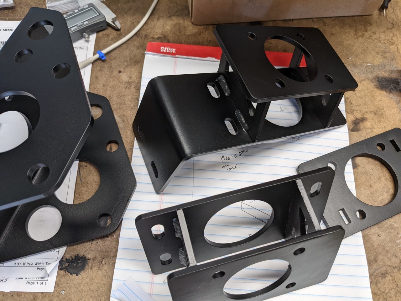

    Got my pieces from sendcutsend today, all slot and tab.
    It'll make welding SUPER fast.PXL_20220422_045738675.jpg PXL_20220422_045745482.jpg

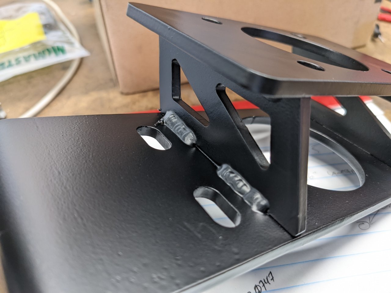

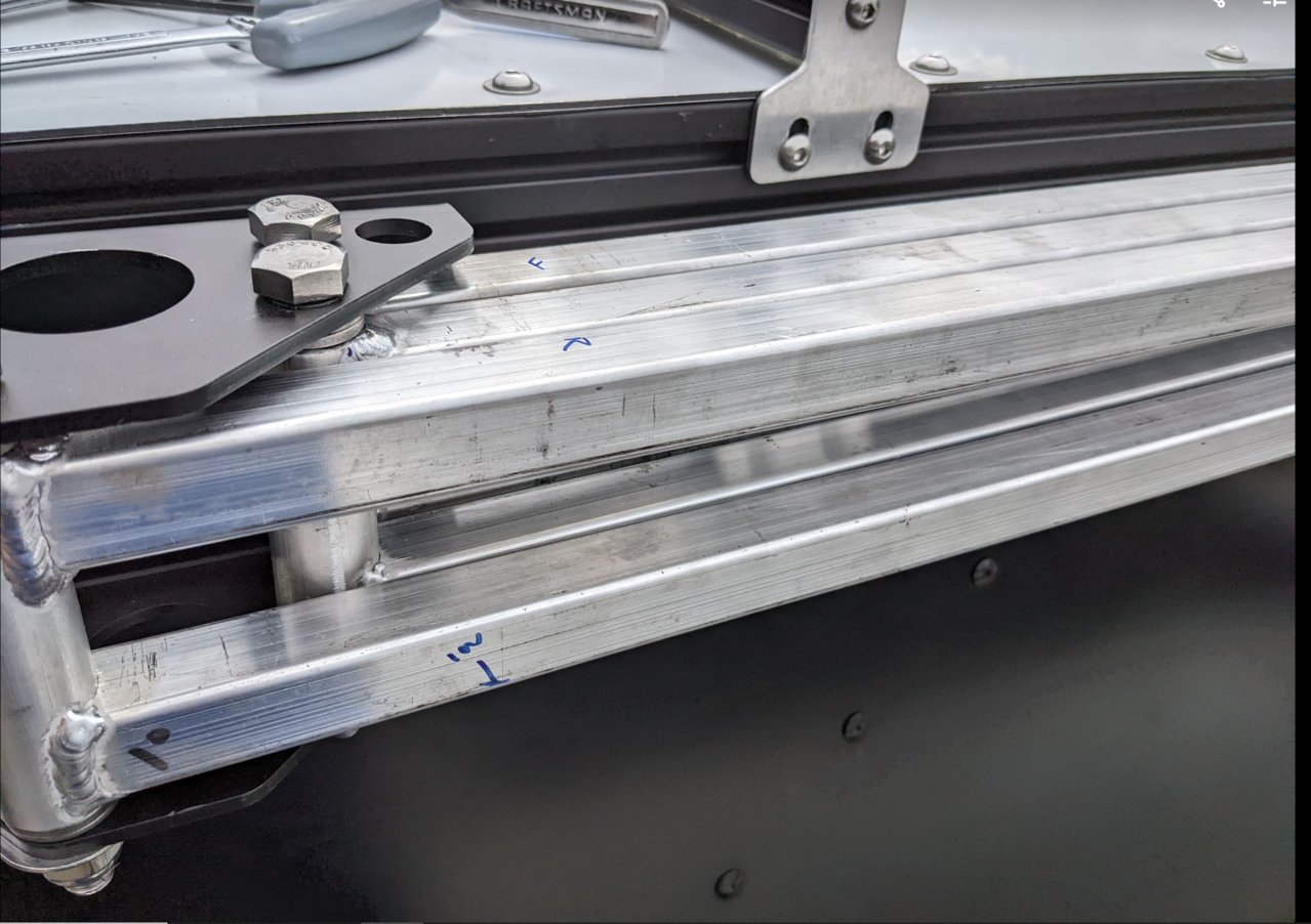

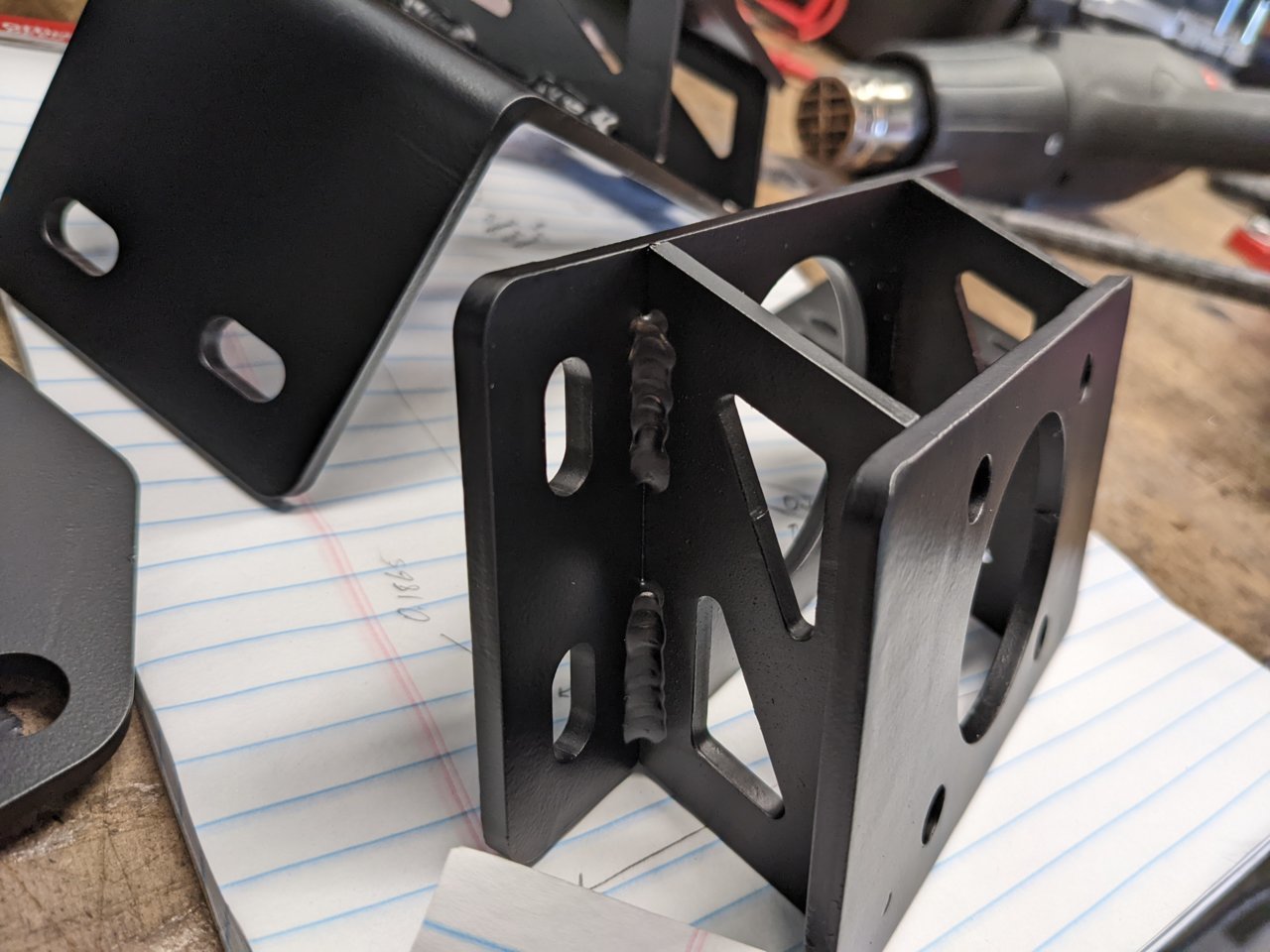

    Welded up the brackets, ground the backsides flat, and powder coated them today.
    PXL_20220422_234955665.jpg PXL_20220422_234952098.MP.jpg PXL_20220422_234941872.jpg

    Damn those look good! You powder coat yourself?

    Yep
    Harbor freight powder coating system and a used toaster oven from Goodwill.

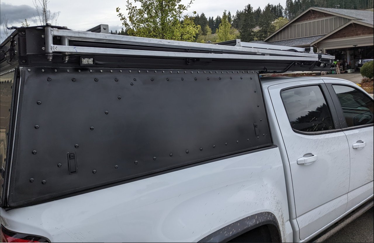

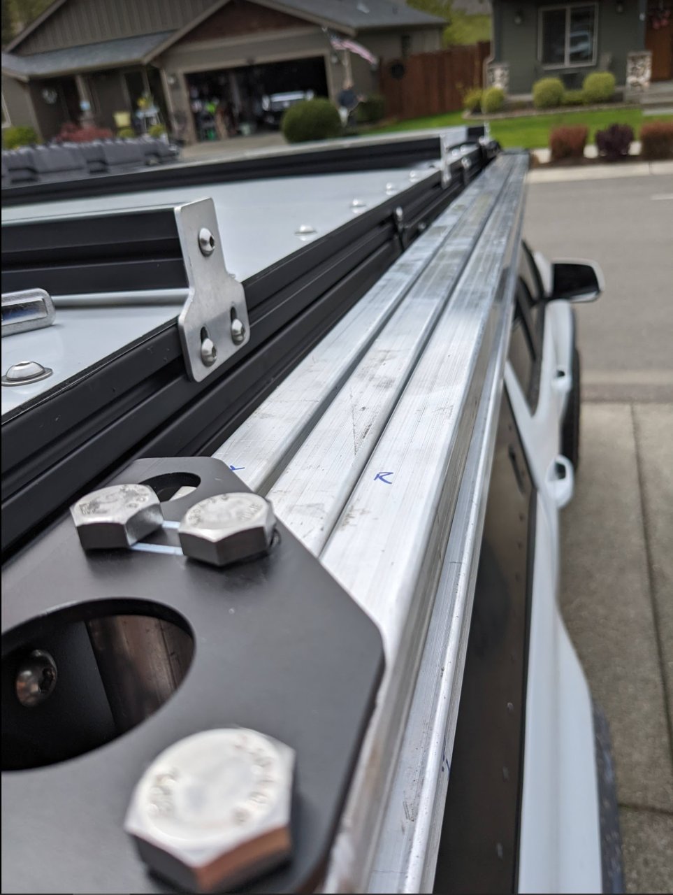

    Made some progress on the build today.
    All aluminum arms, TIG is a lot slower process than MIG.
    I need to weld in the braces on two more arms and then start the sewing process.
    Taco Camper, SR-71A and davzx[OP] like this.

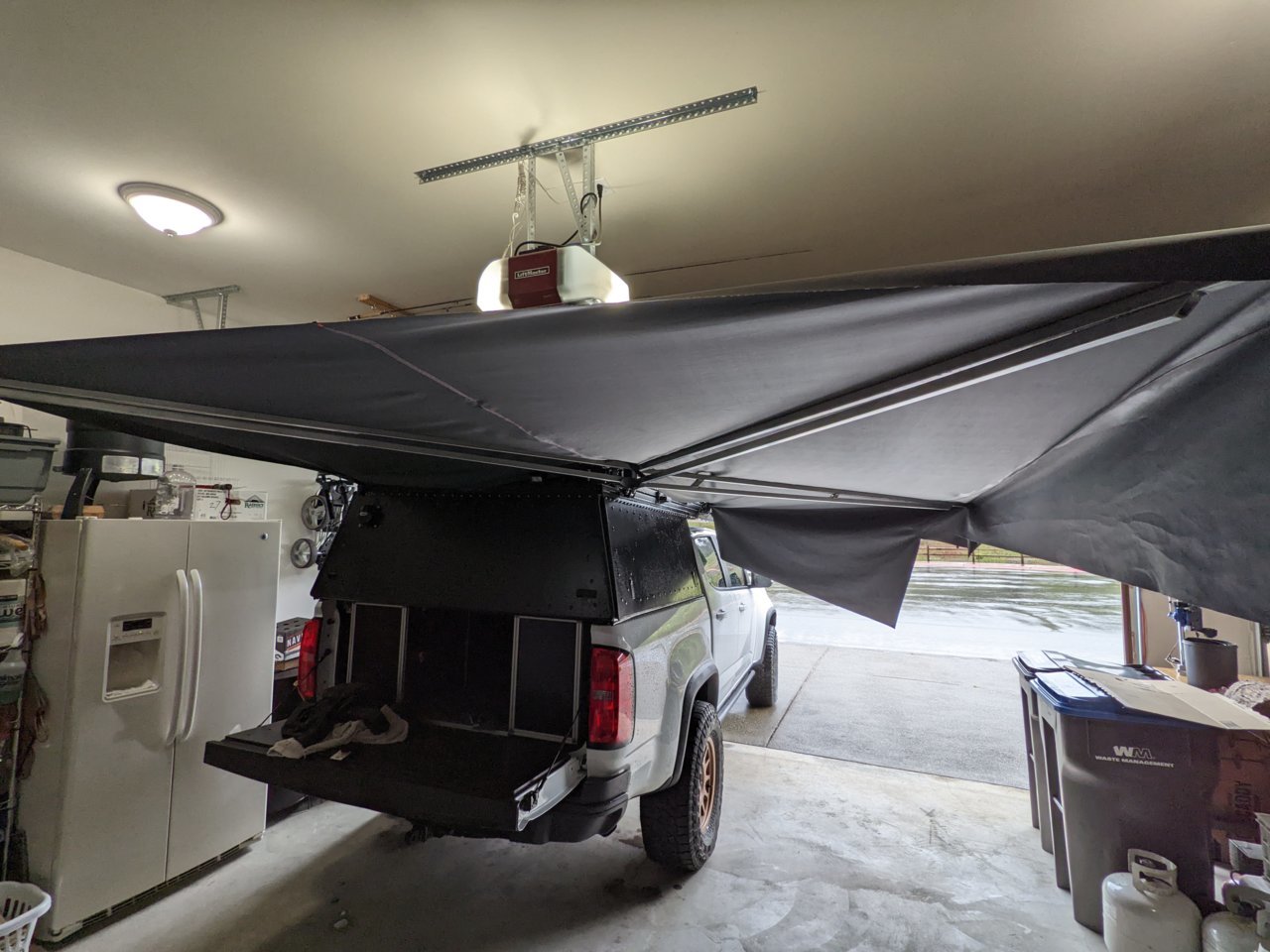

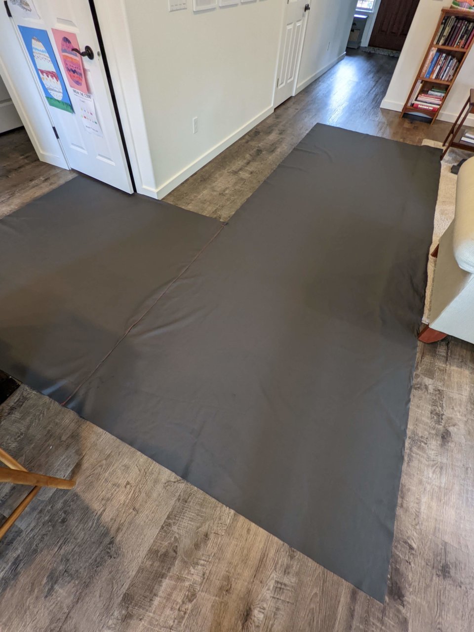

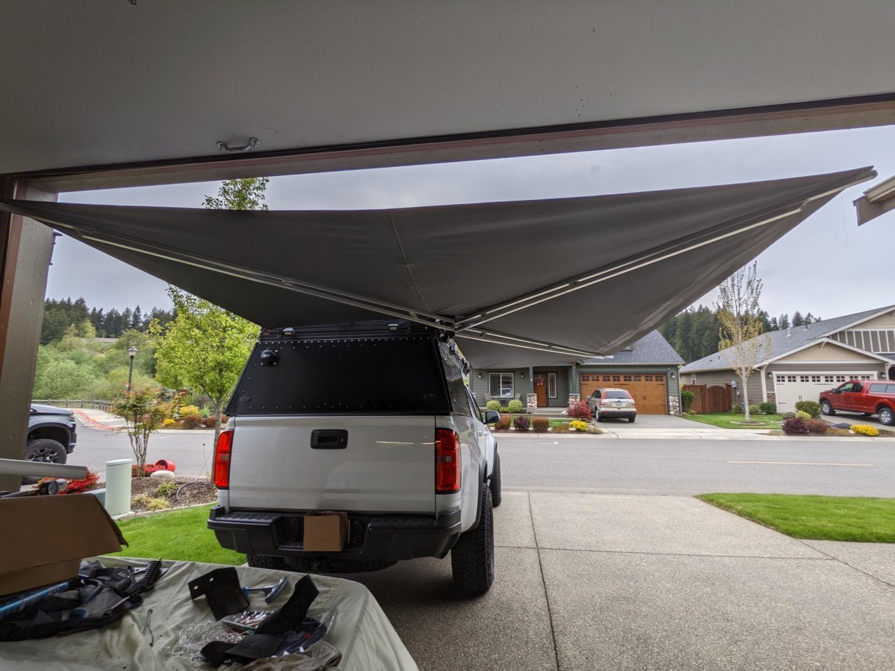

    Made the basic shape by sewing two widths of the material together.
    This is definintely going to be a drape, trim, and hem method.
    My CAD measurements ended up a little off from the real world ones for some reason.
    So far, I like how big it is when it's open.
    PXL_20220505_213252516.MP.jpg PXL_20220505_213256324.jpg PXL_20220505_222452620.jpg

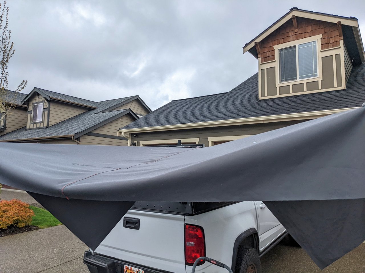

    Got mine all laid across the arms and marked out.
    I was considering doing a hang down lip that went all the way around, but decided it's beyond my skills and likely not worth the extra ~30' of stitches.

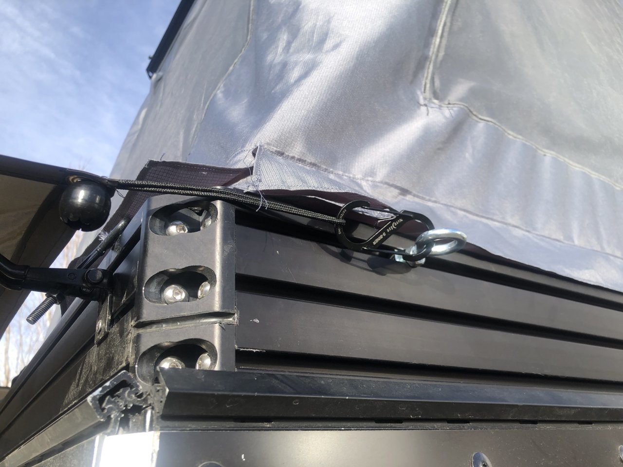

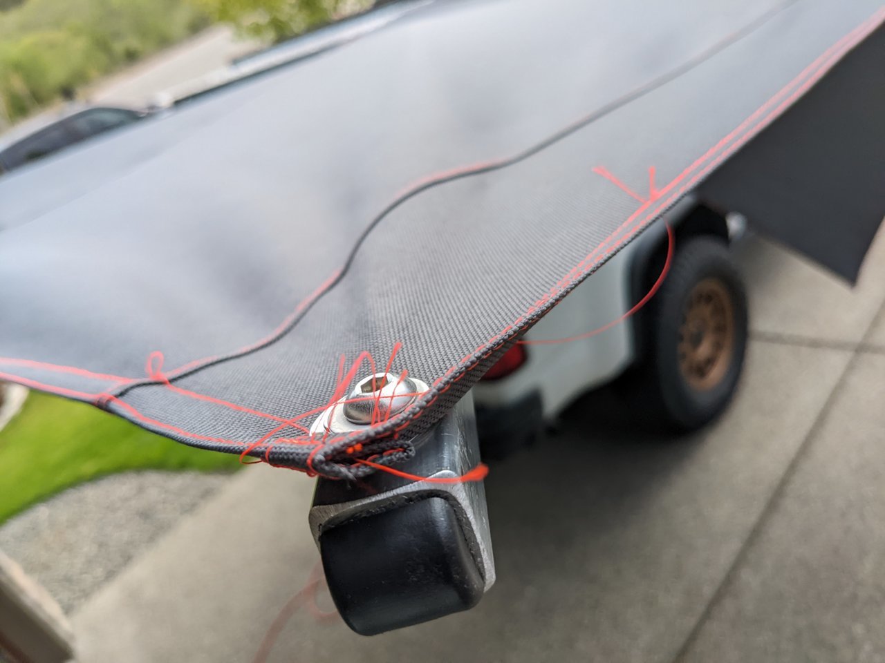

    @davzx how did you attach the fabric up front to the front bracket?
    Sandwich it in there, or did you use a strap or something?
  13. May 6, 2022 at 4:59 PM
    #73
    davzx
    davzx [OP] Well-Known Member
    Feb 1, 2021
    #354725
    125
    CO
    2007 Tacoma TRD Sport DCLB
    Ended up putting a grommet in the corner of the tarp and then using an S-biner to attach to an eye bolt on the extrusion. Eye bolt is hidden by the bag. Did the same on the rear corner as well.
    Photos below use a bungee, but I got rid of those - it’s just the S-biner from the tarp to the eye bolt now, and it stays super taut.
    I’ll unzip the bag, immediately attach that front corner, then swing open the rest of it.

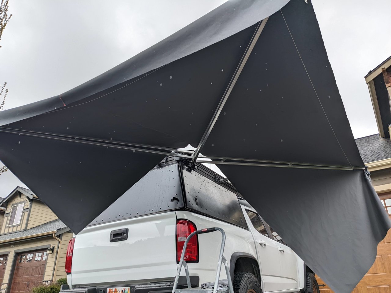

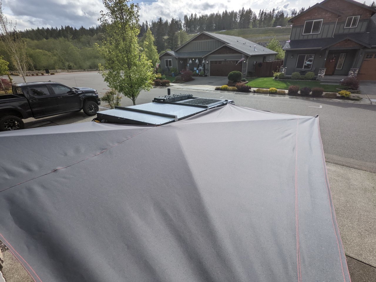

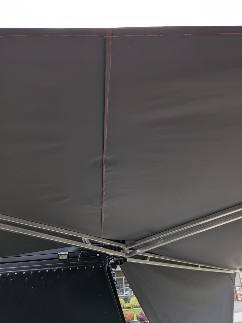

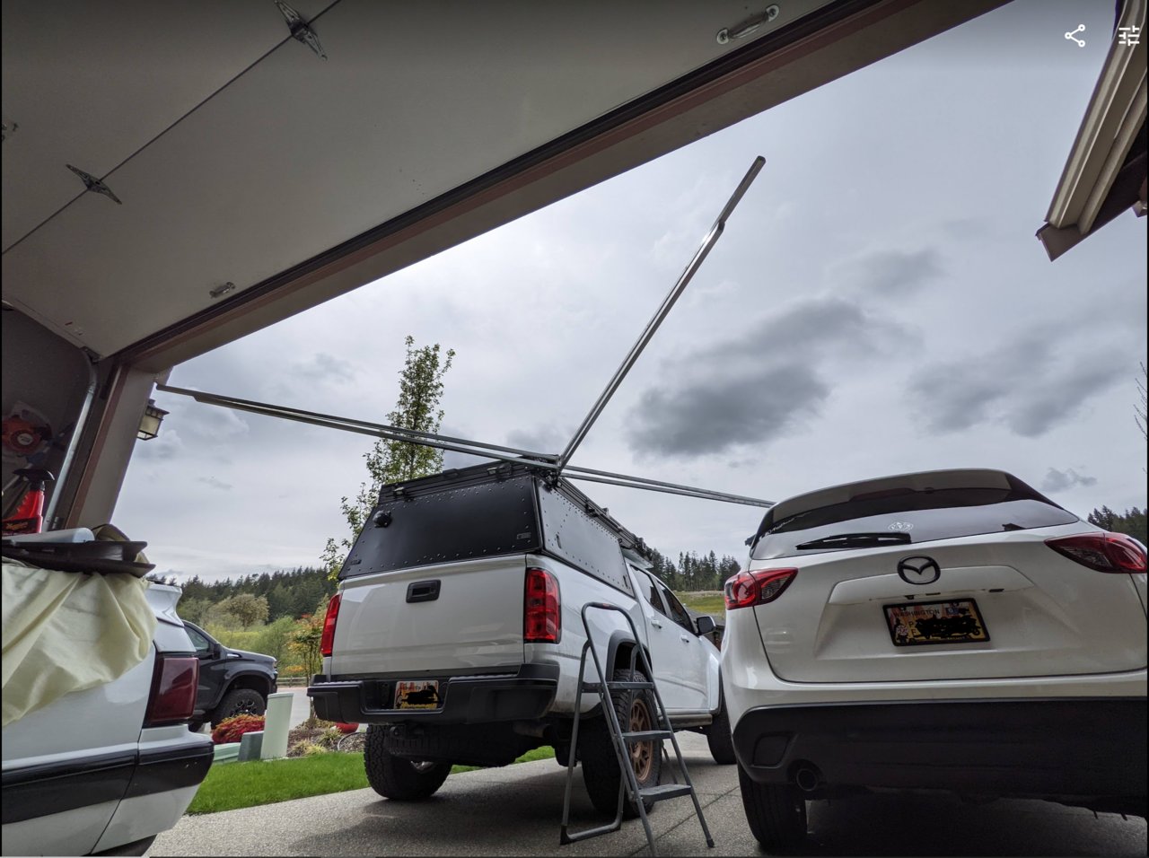

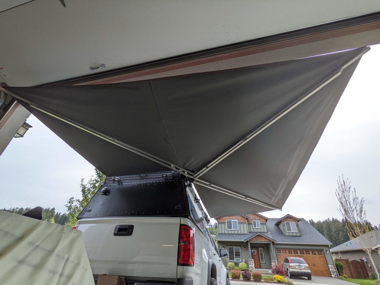

    More action from today.
    I just need to trim one side a little more, hem it, and make the bag.
    Ended up making two seams that run front to back. Since the fabric is only 59-60" wide of usable material it had to be widened.
    PXL_20220508_000735520.jpg PXL_20220508_013015386.MP.jpg PXL_20220508_013035631.jpg PXL_20220508_013044574.jpg

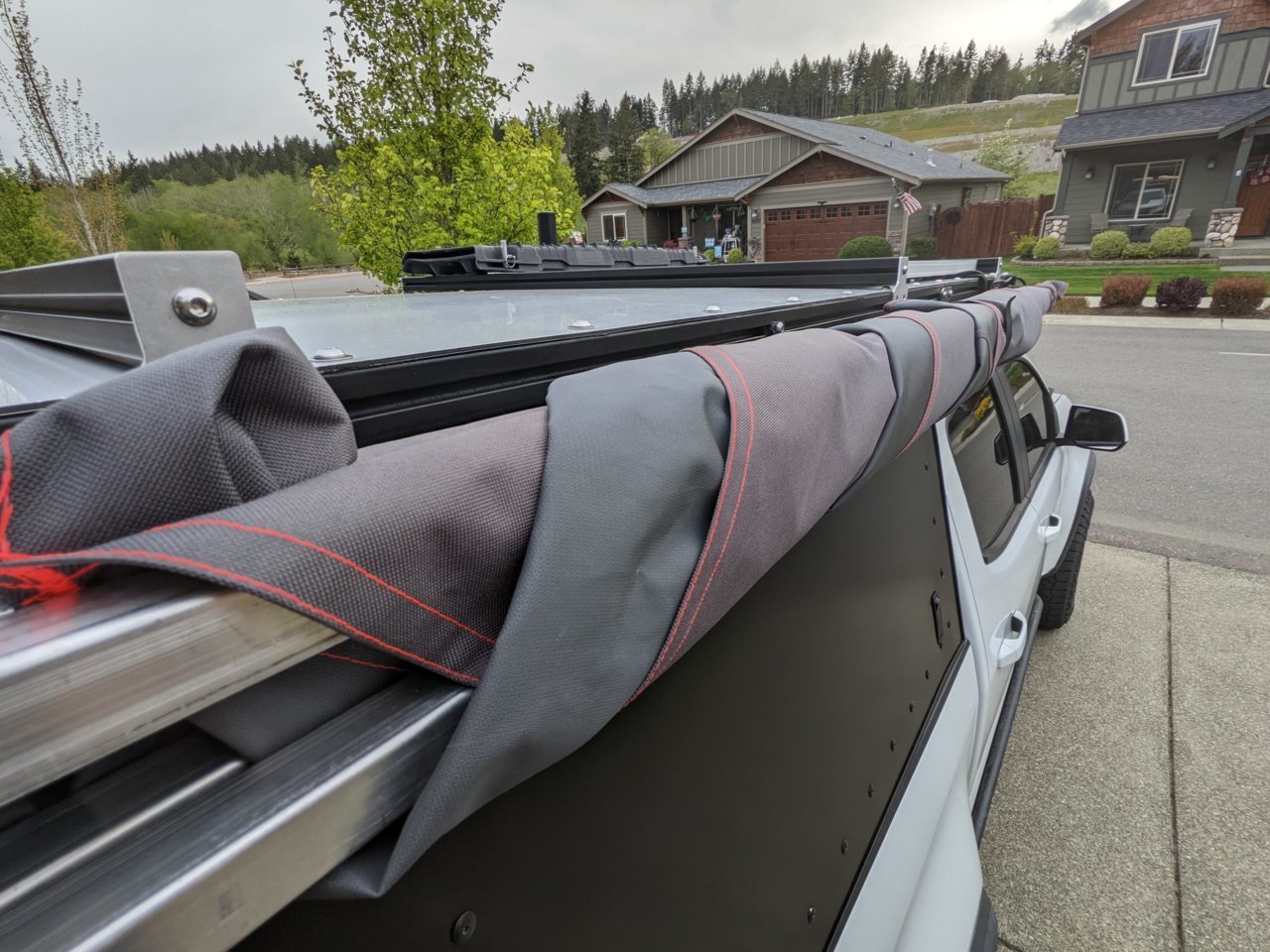

    Elliott
    2019 ZR2 Colorado

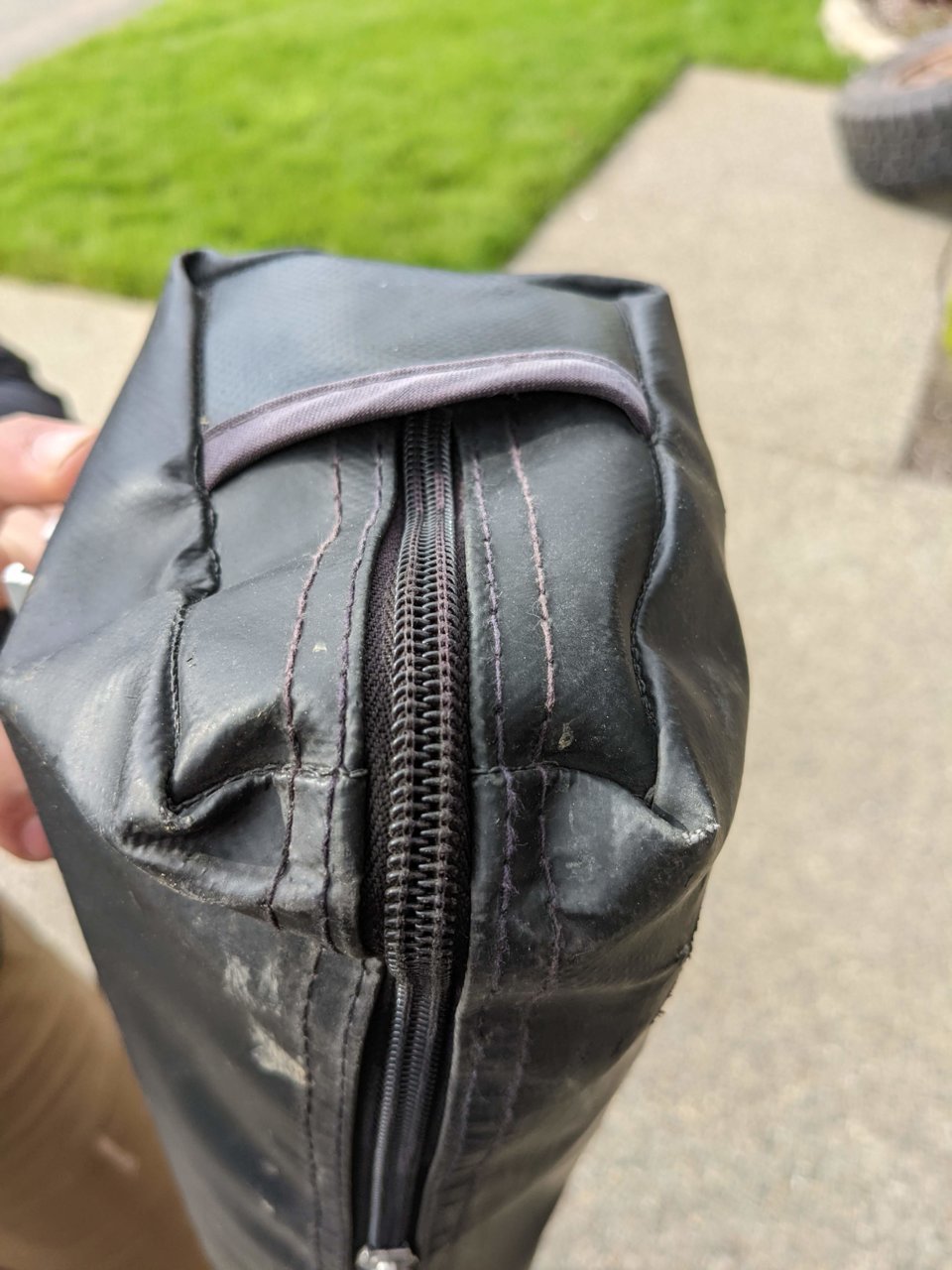

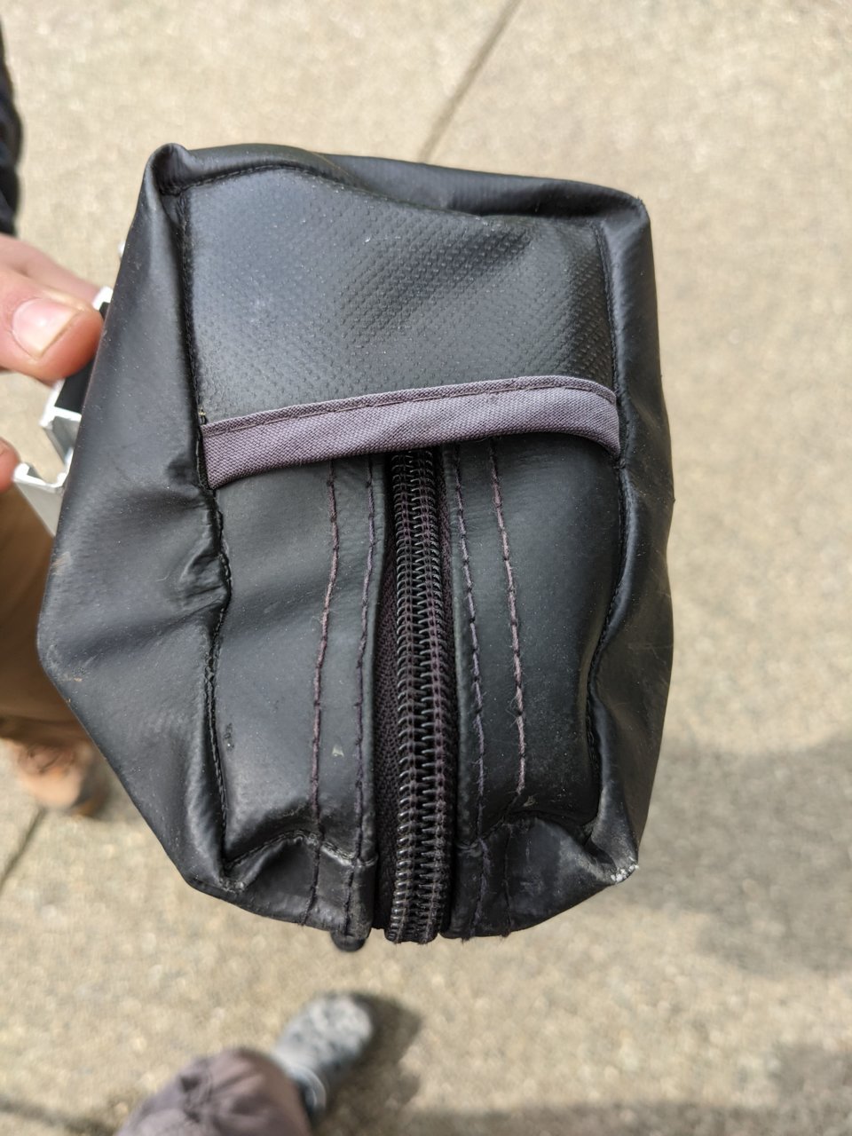

    Next up is the bag.

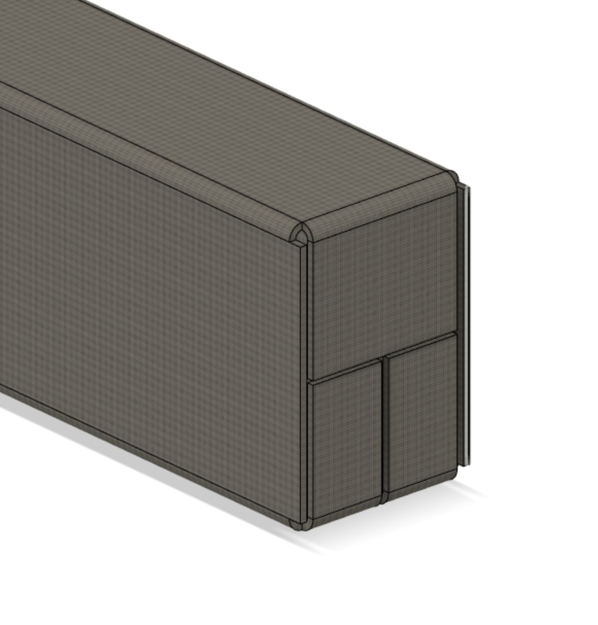

    I had a CVT awning with a boxed shape bag that worked really nice. I'd like to replicate it.

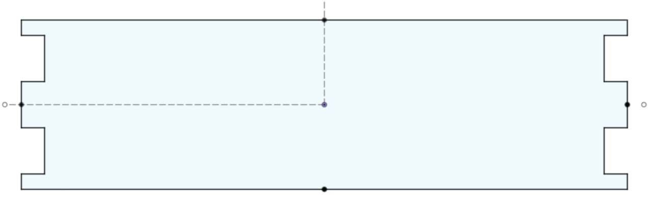

    After a bit of Google action, I came across a pattern for DIY zippered makeup bags. So, essentially I'll be making a big, long, DIY zippered makeup bag.
    Here's the pattern shape:
    And here's a quick mockup of it with gaps to show where your material will meet together:
    What you end up doing, based on the tutorials I read, is to line up your pattern shape on the material, and add an extra 0.5"-1" to allow for you to sew the flaps together. The material and zipper gets sewn inside out, so that when you're done, you invert the bag right side out.
