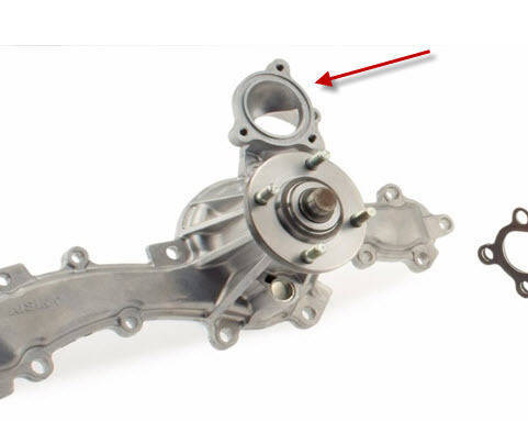

    on the service manual it says to torque some bolts (A) to 80 in-lb (6.7 ft-lb) and other bolts (B) to 17 ft-lb. I'd hate to over-torque or under-torque some of them. Do you know which is which? Also, on the service manual it shows to install a new gasket on the water pump. What gasket is this? I already have the outlet o-ring that is shown. Does the Aisin wp come with this other gasket?

    Sorry I don't know about the bolts. It seems like there are fewer, longer bolts (A). And many shorter bolts (B) around the perimeter. Someone please verify.
    I believe the gasket they are referring to is the outlet gasket. The water pump does NOT come with this

    Fyi i ordered the aisin water pump and it came with the two gaskets.

    When I did the water pump, I also changed to an E-fan, all NST lite pulleys, idler pulleys, and silicon radiator hoses. I had a lot of room to work with. Also when removing the bolts use the new water pump as your bolt holder and replace where it would need to go. Just transfer the bolts over to the old pump and when installing the new waterpump go one bolt at a time. You should have all the gaskets with the AISEN water pumps. If your changing your waterpump at 100k and thinking about doing the pulleys, just do it while your in your engine. why wait another 10-20k to hear the squeaking.
