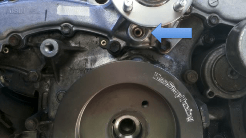

    Is this the "weep" hole I should be looking at if there is a coolant drain?

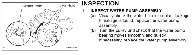

    I don't recall it looking like that but here is an image from the service manual.

    Perfect! That's exactly what I was looking for. Big thanks!

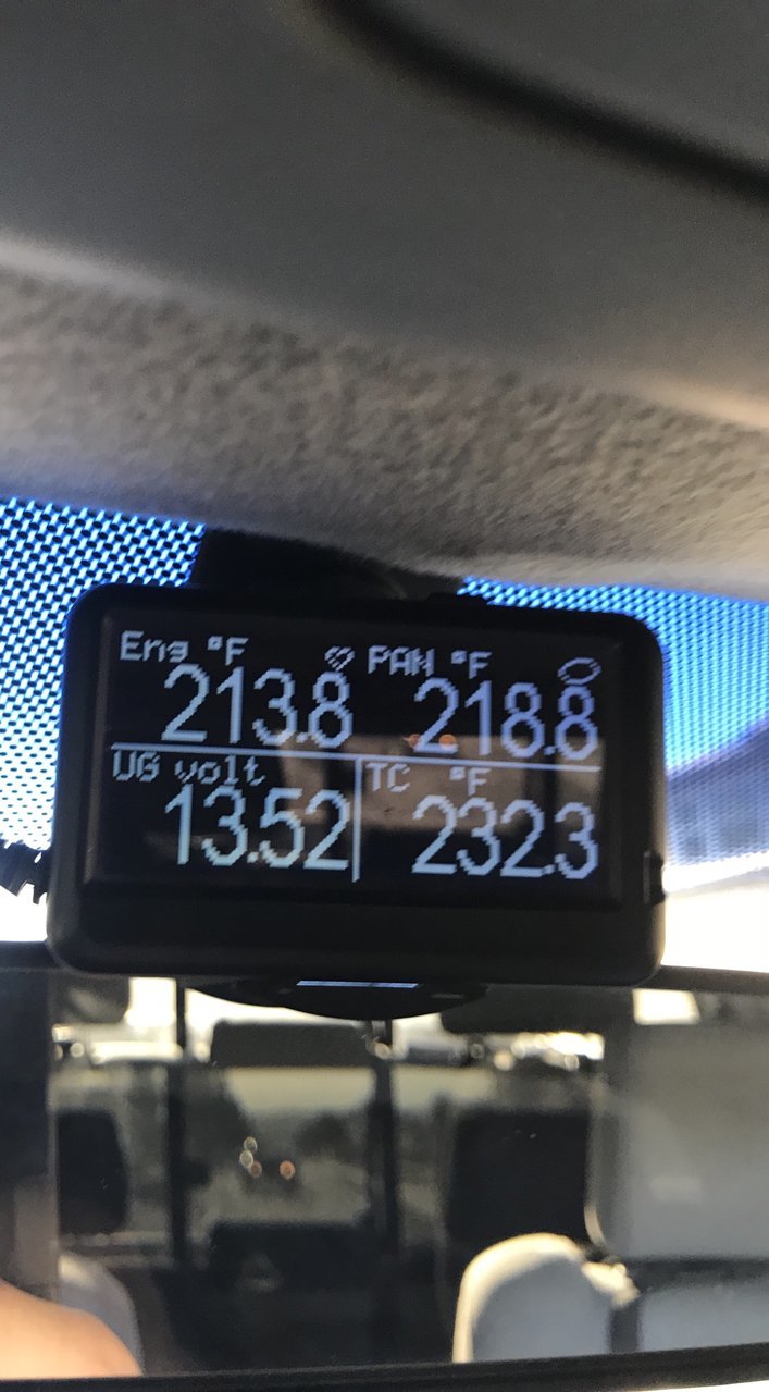

    Usually around 194-200 but will go up to 215 if it’s hot outside (100) and if I’m going up hill
    I went off-roading and it got over 230 and I had to shut the truck off
